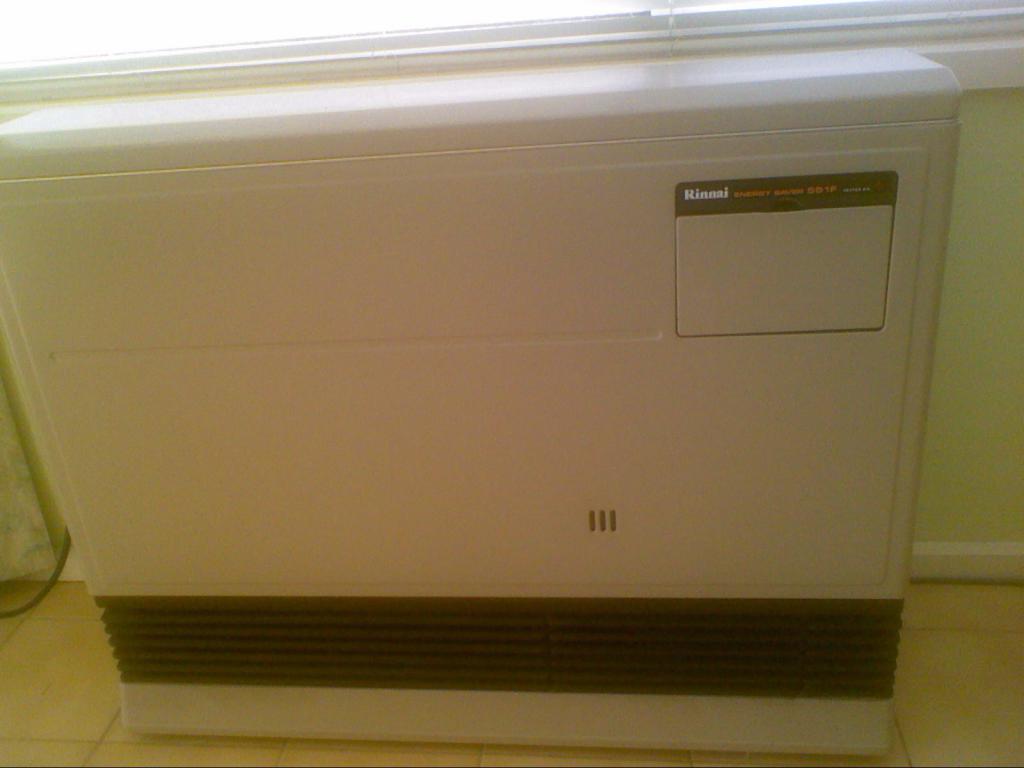

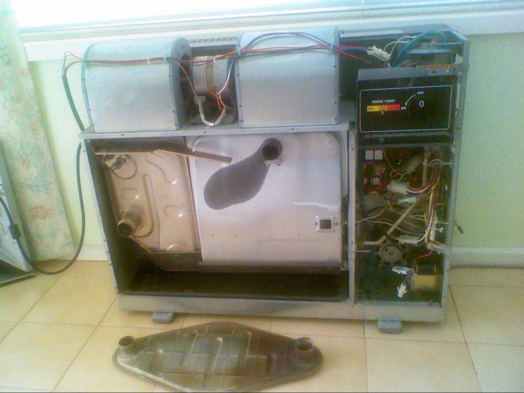

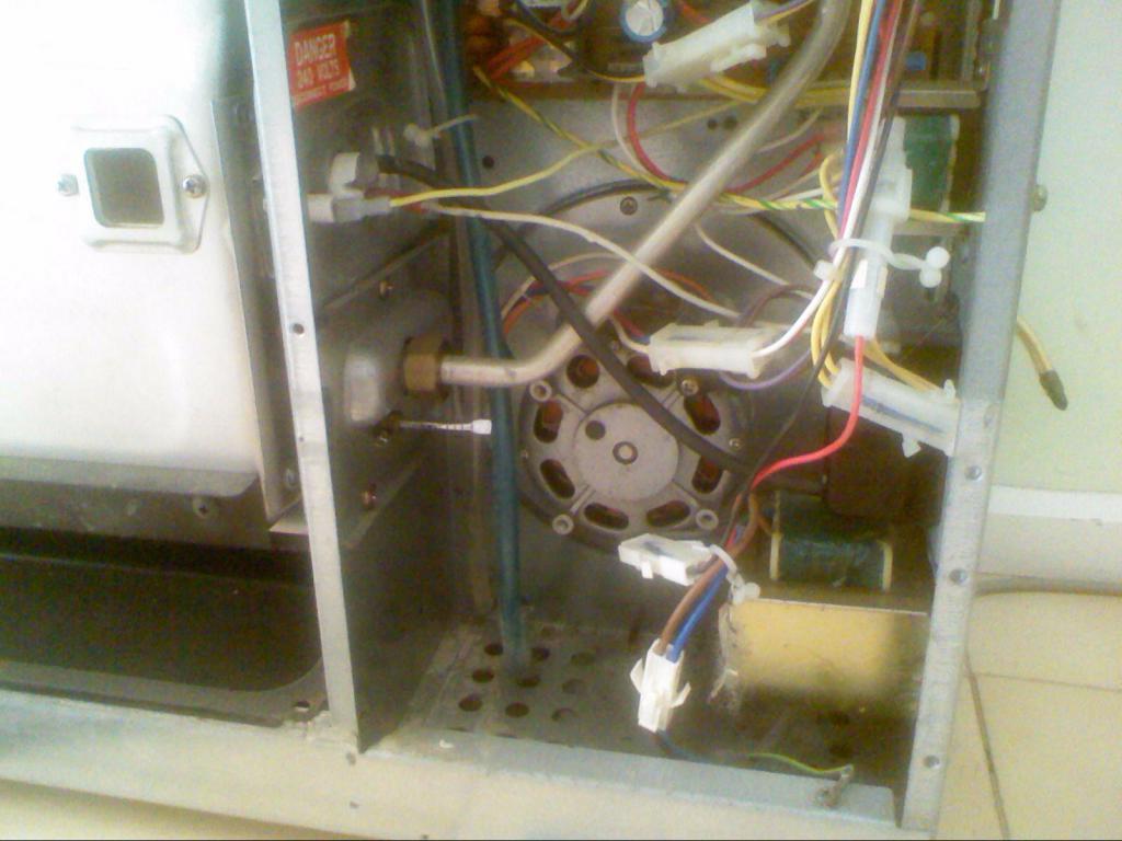

  Quote  The real difficulty in doing a home heater to me is a heat exchanger.
Dave, see if you can grab a secondhand Rinnai gas space heater to experiment with.
I now have seven of these, and they can sometimes be picked up very cheaply. I actually bought a fully working one for two dollars once. Fifty dollars might be more typical. I even have one blowing hot air into a tumble clothes dryer.
Anyhow, there is a sealed stainless steel combustion box with a gas burner inside, and a combustion blower that draws in outside air. After the combustion box there are three quite compact stainless steel heat exchangers, and the no longer very hot flue gas then gets vented outside.
If you pulled one to bits there might be some useful parts that could be repurposed for an oil burning space heater.
The main reason these Rinnai heaters get junked is that the control system uses a very large and complex circuit board with a microcontroller and a lot of different sensors. Once they start to give trouble, your average plumber and gas fitter is way out of his depth with the electronics. He will simply advise the customer to buy a new one.  So they sometimes appear on e-bay and gum tree at give away prices.
Would you have a Picture or model number I could refer to Tony?
The ones I have in mind would be quite different and I can't relate to the style you are talking about.
I also am aware of the sort of heating used down south is different to what we normally see here as is the cooling  up north very different.
I have seen those evap coolers everywhere in Qld but never remember seeing one in Sydney.
One thing I was thinking of was an Instant gas heater which are becoming far more popular here but I have yet to get my hands on one to dissect it and see how it could be used.
Posted: 02:24am 09 Aug 2021
Could not find any ready pictures on the internet, so I pulled the covers off one I have working here. There are several very similar versions, all called "Rinnai Energy Saver".

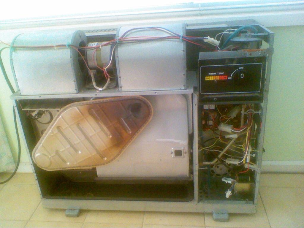

There is a big one called model 1001 that has three gas burners, and a smaller two burner version called 551F.  Everything on the larger unit is scaled up in proportion but is otherwise they are functionally identical.
Here is what a 551F looks like with all the covers on:
And with the inner air plenum cover removed.
Room air comes in at the upper rear into the double ended blower, then blows straight down over the fire box and three heat exchangers, hot air emerging at the bottom.
The fire box is the large silver box in the middle, combustion air enters at the lower right from the centrifugal combustion air blower fed from outside air. Flue gas at the top of the fire box exits at both the top front, and top rear.
There are two primary heat exchangers, one in front and one behind the fire box. The one behind is not visible.  I have removed the front primary heat exchanger in the picture below, its made of stainless steel, and just plugs into both the fire box, and the secondary heat exchanger. The one at the back is identical.
Flue gas enters the secondary heat exchanger at both the front and back, and travels upwards then downwards in an inverted U shaped path. Final exit of the very much cooled flue gas is at the rear.
The combustion air blower is at the lower right of the firebox. And there is a small window to view the ignition spark, one end of the burner, and the flame detector.
That is about it. They work extremely well and very efficiently, the final flue gas is only warm. They are available for either natural gas or propane, the only difference being the size of the burner jet, which is easily changed from one to the other type of gas.
Most of the controls will be pretty useless to you, but the firebox, heat exchangers and air blowers should work just as well with a small oil burner, if you can rig up a suitable burner and controls. That would be beyond my own ability to get working properly, but I am sure the basic hardware which is quite well made, might give you some ideas.

Thank You very much Tony for the pictures, Taking the trouble to dissect your heater and the explanation.  Very kind and much appreciated.
I have seen those heaters around but will keep an eye out for some now. There was one at the air BNB we stayed at in the Hunter valley a few months ago.  that thing was a real ball tearer. Don't know what Size it was,  I seem to recall it was a Rinnai and was on LPG but sure Kicked out the heat.
The HE is very simple isn't it?  That said, a layout I had not thought of. Wide and thin and blow the air both sides.  I can see by the dimpling pressed in its' designed to make the hot gas flow around a bit .
They seem to have updated the model numbers but the one closest to the 551 Does a useful 5.1 Kw and the big one does 8.6KW.

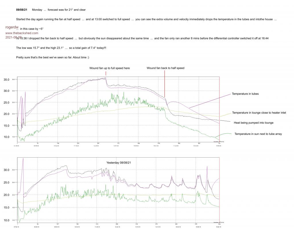

I have an update for today and we had an awesome result  ...  the best we've seen so far I think. Had a temperature gain of 7.4 degrees!!!
Started off with the fan on half speed via my variac  ...  and when I came in for lunch it was sunny and the outlet was pumping around 35 degrees  ...  so wound it up to full speed.
You can see on the chart exactly where that was because the temps dropped 5 degrees pretty much straight away as the extra volume and speed of air pumped it out.
It ran nicely until later in the day when I suddenly remembered it and raced in to have a look. As the outlet was down to 26-27 I dropped the speed to half again (at 16:36)  ...
...  but it only ran another 8 mins before the controller turned it off.
Looking at the graphs, I may have had a better result if I'd reduced the speed around 3 o'clock perhaps.
Regardless, I was rapt with the result.
Cheers,  Roger

  rogerdw said  I have an update for today and we had an awesome result  ...  the best we've seen so far I think. Had a temperature gain of 7.4 degrees!!! Once again, very Impressive!
  Quote  Started off with the fan on half speed via my variac  ...  and when I came in for lunch it was sunny and the outlet was pumping around 35 degrees  ...  so wound it up to full speed.
That raises Questions and thoughts with me.
If the airflow was in fact Doubled ( and that may not be the case because I have seen fans and pumps do more than half their volume at  half speed/ Power) it would seem to suggest to me a restriction of some sort.
That would be the capacity of the blower to push air through the passages available and either the fan is flat out and has no more to give or the cumulative back pressure is disproportional. Either way, the tubes are delivering a given amount of heat and if doubling the airflow only causes a Temp drop of 1/6th the half speed, there is something else at play.
I believe it was earlier suggested that with the larger setup the restrictions will be lessened but I'm wondering if the airflow through the tubes will be as well? I tend to think it will be.  That would logically increase the output temps substantially. Whether or not it increases the power output  I think could be another thing.
There would seem to be a sweet spot with the tubes of having the air output around 30.  I don't know if having it higher is leaving  energy on the table  though having the tubes run hotter.
It will be interesting to see in any event.  From observations with different things, they seldom are liner and far more often appear to be exponential.
  Quote  It ran nicely until later in the day when I suddenly remembered it and raced in to have a look. As the outlet was down to 26-27 I dropped the speed to half again (at 16:36)  ...
It seems you need to be able to 2 step, or more, the fan speed automaticaly.
Not sure if Tony thinks a PWM is a good long term idea but if not, maybe a power resistor would do the job on a DPDT relay? At least you could put the resistor in the air flow and reclaim the lost energy going into it.  Wouldn't be hard to run the controllers together so the 2 step did half speed at a certain temp or below and
ramped up if above that.
  Quote  Regardless, I was rapt with the result.
As well you should be. It seems  the significant deciding factor on this is not the season warming up but the sunlight Improving.
This may not ( like my little diesel) be up to providing all your heat especially in the middle of winter but the full unit may be able to provide the lions share going into and coming out of winter and that will make it more than worthwhile in itself.
This is going to be a fantastic asset being how totally hands off it's going to be once setup.  No need to fuel the thing, next to no maintence and no hands on time required. Go away on holidays and the house will still be ventilated and warm and in no danger if something goes wrong.
That too is significant.
Posted: 10:25pm 09 Aug 2021
Great stuff there Roger !
Its interesting that when you increased the fan speed, the air temperatures coming off the tubes dropped significantly, as expected.  But the room temperature continued to climb at about the same rate regardless of the much lower temperature air coming from the tubes.  The full heat flow was still there !
At the moment, at full blower speed there is probably a lot more air than really necessary, but the air volume requirement will increase significantly once the full system is installed.

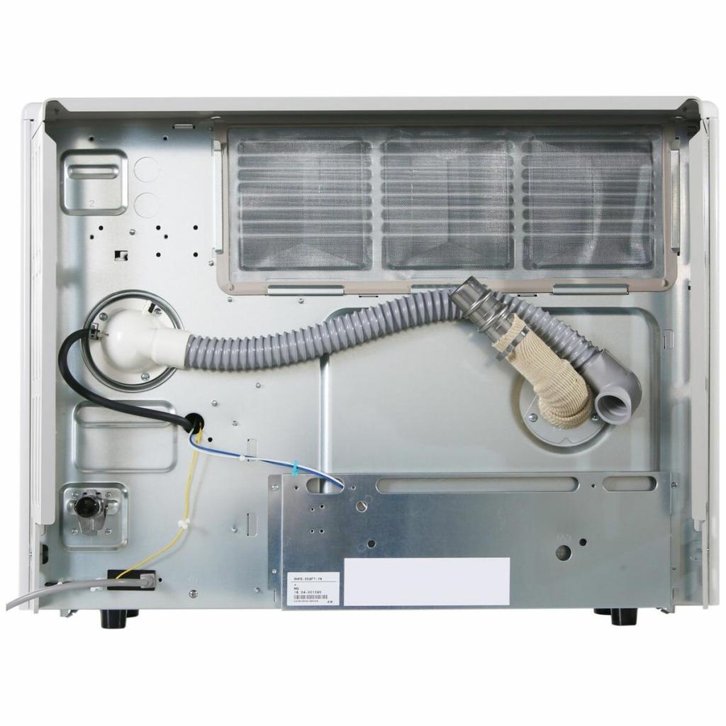

Those radiant gas heaters are much less efficient than the heat exchanger type.  Most of the heat goes up the flue, and although you might feel warm sitting very close to one, the far corners of the room will not heat up anywhere nearly as well.
I used to work at the Gas and Fuel research lab where we tested a lot of different gas appliances. These Rinnai energy saver gas heaters beat anything else by a mile for actual measured heat output.  The flue gas is only just warm, all the heat goes into the room. The radiant heaters use room air for combustion, meaning that there has to be a cold draft somewhere.  The heat exchanger heaters recycle room air, so no cold drafts.

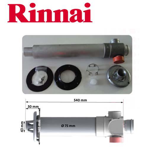

Roger, the flue pipe size is inch and a quarter. Surrounding that is the induction air pipe which is two and a half inches in diameter, but they recommend a three inch hole through the wall for installation.
Its small enough to feed up within a standard stud inner wall.  They recommend no more than three metres of vertical pipe, and I found out the hard way what happens if there is more.
The gas burns cleanly, although there is a very slight amount of very fine ash produced.
If the flue stack is way too tall, the induction air blower is not powerful enough to blast the ash up that high, and about a coffee mug full of ash can it can accumulate at the bottom of the flue, and eventually block the flue.
That becomes a problem after about a year to eighteen months, where you will then need to clean out the ash to prevent the heater from continually shutting down and failing to relight.
Usually the flue just goes straight through an outside wall and is only a foot or less long.
The clever part is, the flue and combustion air always see the exact same air pressure. Even in a storm, with very high winds, the burner is still fed by the combustion air blower and the flame still burns evenly without flicker. It all very clever.
If you look at the last picture in my earlier post, there is a metal plate held by some screws at the lower right hand side of the fire box. The whole gas burner, flame sensor, and ignition electrode slide out all in one piece. It might be viable to fabricate an oil burner that replaces all of that, and use the existing blowers, fire box, and heat exchangers just as they are.
Here is an internet picture of the back of one of these heaters.
The grey convoluted pipe is the suction side of the combustion air blower, the small black pipe at the blower intake measures one side of the differential air pressure directly across the combustion air blower.
If the flue becomes restricted, and air pressure switch halts the ignition sequence.
Flue exit is at the right. The flue pipe swivels and telescopes in length, so its easy to align with the flue fitting fixed to the wall behind. Room air intake and air filter are at the top.
Most are installed against an outside wall with a standard flue kit.
But fitting kits are available for a vertical flue either within a stud wall or through  a wall and then up.
These are great heaters, but sometimes can be troublesome because one or more of the dozen or more sensors go faulty and there are no diagnostics to tell you why the microcontroller spit the dummy.  Often the problem is only a partially blocked flue....
Many people just give up after several expensive service calls by a plumber/gas fitter fails to fix the problem. And then sell the damned thing for peanuts in sheer frustration, which I can well understand.

  Warpspeed said  Great stuff there Roger !
I read that very differently.  Dropping 5o from 35 at double fan speed or thereabouts  didn't seem much to me at all. I would have expected something much more linear. Is there some equation/ formula for that as to how this acts?
I would think that while there is a given amount of energy in the tubes, the increased airflow had the potential to more efficiently harvest it.  THat may mean lower temps but Higher airflow but I would have thought unless there was something else at play doubling the airflow would have reduced the temps more... unless the blower is maxed out and the tubes can take more Flow.
Interesting stuff none the less.

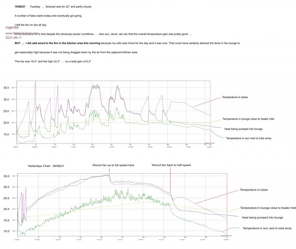

Thanks for the input guys.  You raise a good point about the airflow between full and half speed.
With the original fan I found that 140V (not 120V) gave half the air velocity  ...  so with this fan I just used 140V for low.
But now that I've checked it  ...  at full speed the air speed is 28.34 ft/s and on 140V is 17.2 ft/s  ...  so maybe I should check it at 120V coz that looks like it may be closer to half.
Anyway, here is todays results. Initially I was surprised  ...  but I likely messed them up because I kept the fire going this morning because my wife was home for the day.
I was weighing up  ...  do I look after my wife and risk messing up my figures  ...  or do I keep my conditions consistant  ...
Cheers,  Roger
Davo99
Joined: 03/06/2019
Posts: 1586
Posted: 03:53pm 10 Aug 2021
While the wood fire surely contributed to your heat input, you made higher overall gains yesterday  demonstrating that the combustion stove was not entirety responsible  for the gains you saw.
When it comes to happy wife or a day of consistent data, appease they wife every single time .  Doing anything else is certain to get you the cold shoulder and hot water at the same time.
