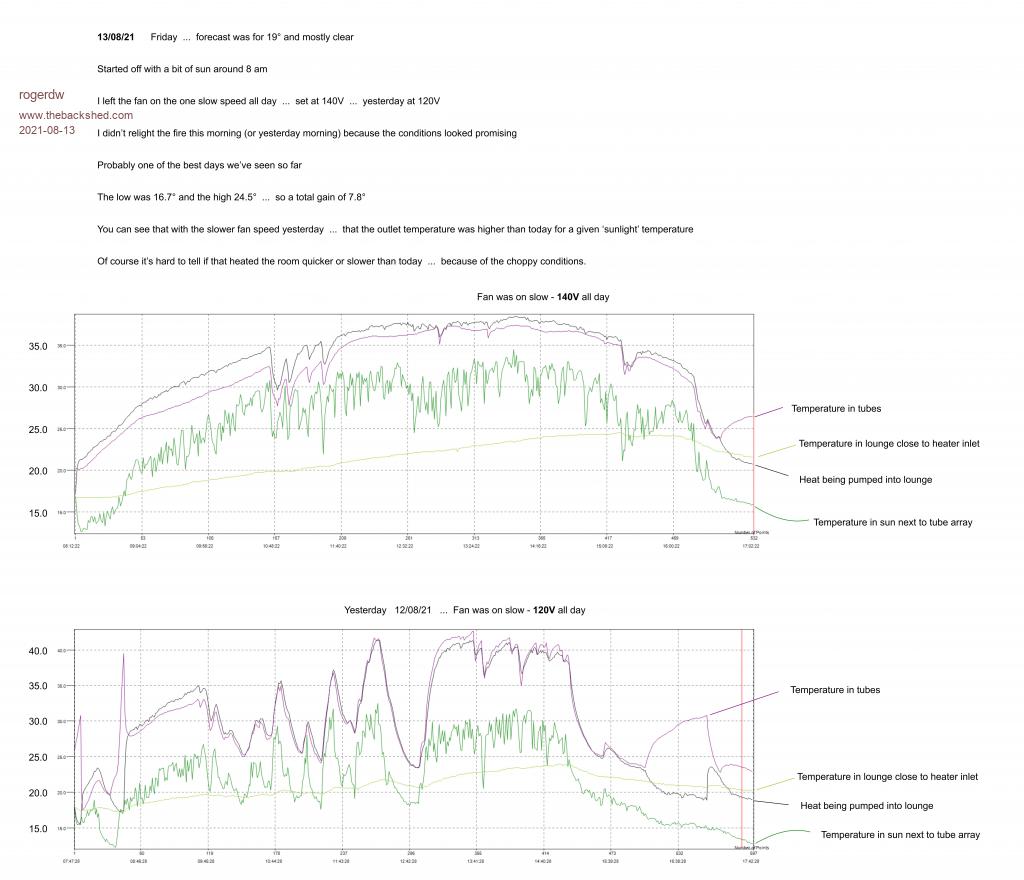

  Davo99 said  Had this discussion last winter about my own AC. He said the  temp at the outlet should be a Minimum of 35 and up to 50.  Mine is on the lower side but I know that a lot of AC I have felt especially from Split systems is MUCH warmer and I'd say 50  would be about right if not higher. The window Type in the Holiday house would be pumping out air at  50 at least.
That's very helpful thanks Dave.
  Quote  Mate said yesterday that you want the temp higher so there isn't too much airflow to create a draft that makes it feel Chilly but still warms the room at a decent rate.  I can relate to that.
That makes sense to me too. I notice that when I let it run down below 25 degrees that it feels like it has no heating value at all and that it may actually be cooling things off.
  Quote  In your case I would think that -maybe- you might want to trade a little efficiency for more comfort.  While keeping the tube temp lower may get you the best power output, may not be the most comfortable.
Yes, I had been starting to think along those lines as well  ...  though it almost seems to me that the temperature is still lifted pretty well even with the fan on low. Which of course allows the tube temp to remain a bit higher anyway  ...  and pump a higher temp but at a lower volume.
  Quote  keep a look out for some solar panels
Haha  ...  I did weaken last night and checked out marketplace (though stayed off the facebook feed). Found a few interesting offerings  ...  so doesn't seem too much different to when I last looked a month ago.

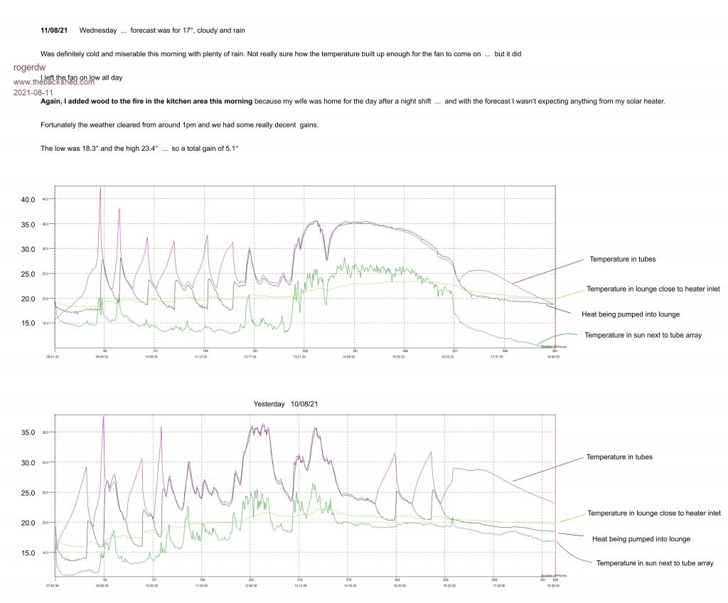

Here are today's results. Started off all drizzly, gray and raining until lunch time and then improved.
I was quite impressed that the output got as high as it did as quickly as it did, once conditions improved.
As mentioned below I did stoke the fire up again this morning at 9am  ...  but did not add any more until this evening

Posted: 11:24am 13 Aug 2021
  Warpspeed said  Roger,
Its been a glorious day here as well, and the same is forecast tomorrow too.
That is really impressive, the way its going you may need to install a room thermostat so it does not get too hot !!!
Ours looks like it will be the same tomorrow too  ...  another beautiful day.
I did ask my wife if it was warm enough now  ...  and she hesitated. Seems that some of the stations she's on have the aircon on 24 and others on 26. No wonder it's not warm enough here. It's probably her that sets the temperature at work  ...  but you can see what I'm up against.

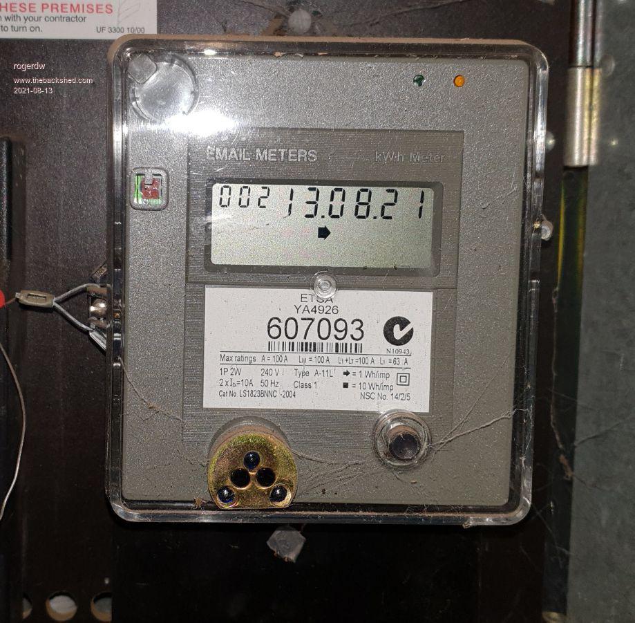

Here's a photo of my meter Dave  ...
...  and seeing the ETSA name reminded me I had thought of a name for my heater  ...  an ETSA  ...  Evacuated Tube Solar Amplifier  ...  or ETSAH  ...  Evacuated Tube Solar Air Heater
Just as well I'm not trying to include my name  ...  a WETSA or a WETSAH doesn't quite cut it.

Couldn't Find much on that meter other than it's an Email/ Ampy/ Landis and Gyr ( they changed their Name then got bought out) model A-11.
By the directional Arrow on the thing I would suggest it's Bi directional... which is good.
Not hard to test them, hook up a GTI and see if the arrow Changes Direction and if the thing counts up or Down.
Least if you got some more panels now you could hook them up in parallel to give your pool pump a boost.

  Davo99 said  Couldn't Find much on that meter other than it's an Email/ Ampy/ Landis and Gyr ( they changed their Name then got bought out) model A-11.
Your suggestion about the arrow made me wonder  ...  if you look on the front, after the arrow it shows 1 Wh/imp  ...  and then a square block with 10 Wh/imp. Any idea what those units are about?

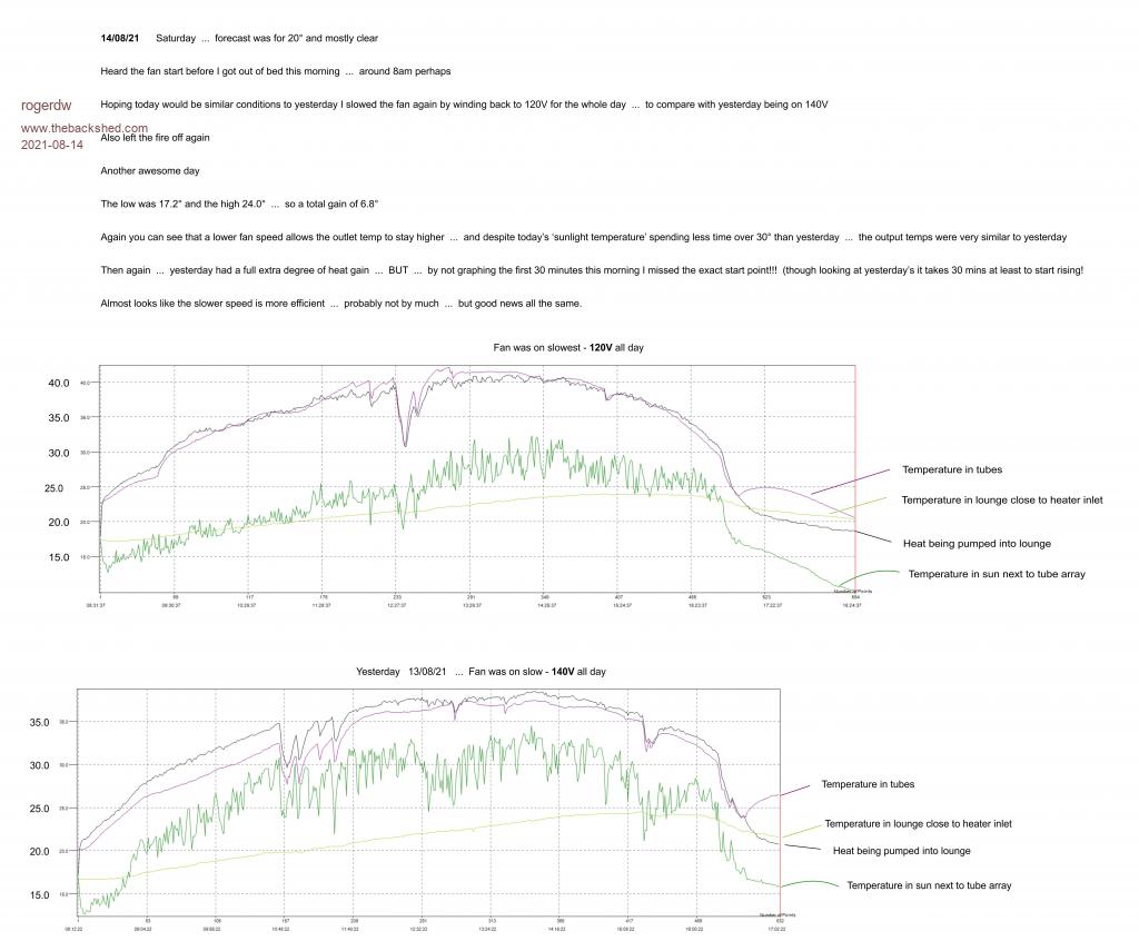

Well time for todays update.
Only thing different today was that I ran the fan slower than yesterday to see what happens  ...  on 120V instead of 140V.
And coz I slept in, I missed the first half hour of activity.
Another beautiful day and very happy with the results again.
Cheers,  Roger

The graphs are a bit difficult for me to clearly define but if the green and very squiggly line is the temp of the logger that is in the sun next to the tubes, why is it so erratic, showing swings of up to 5o if the day was clear?
I'd expect that to look like there was a constant shadowing and then full sunlight all day. Is it just a logger anomaly or something else I have missed?
Oddly, where there was an obvious dip due to a large cloud as I take it, the in sun temp  did not vary nearly as much as the tube and output temps.
The 6.8o temp rise is still significant but how did the higher output temp feel? were you in the house enough to make a judgement on comfort level?
I believe the arrow and the block on the meter indicate unit blocks of measurement now you come to mention it. I surmise that LED at the top right flashes with the power use.
More power the faster it flashes.... to a point.  The arrow is basicly the low range and the square is the high range.
You can count the flashes to determine the approx amount of power being consumed. Obviously of the flashing gets too  fast that's not possible so the meter switched to the high unit count so each flash represents 10x more power  when the block is shown than when the arrow is.
I have a meter in my collection that is probably s slightly newer meter that uses an arrow to show direction. It's quite handy actually for experimenting with IMAGS to see which way the current is flowing although an analogue meter would be better but yet to come across any.
