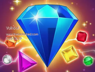

  dddns said  Hello Volhout,
I tried that with Blit slots using Blit read/load/write which is very fast like Framebuffer copy
Thanks, works great....
This ... is coming for Game*Mite (and any other ILI9341 LCD equiped mite).
