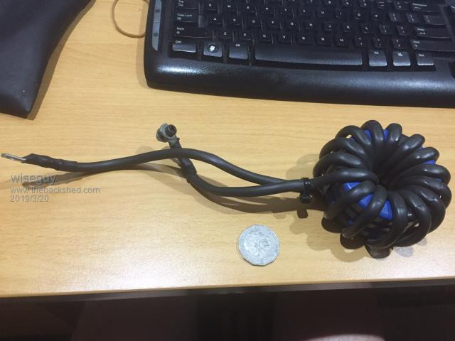

Hi Tony, I have been playing with a Toroid from a commercial 4KW inverter (possibly originated from Sola) 72VDC input Sinewave 240V output. The Toroid is a stack of 3, A-866142-2 Blue Toroids which I think were Arnold cores, it appears Micrometals number is MP-300125-2. The cores are each ~ 80mm OD, ~50mm ID and ~13mm High
This core has a total inductance of ~70uH with 15 Turns & has very low losses in the saturation tester to 60A, equating to ~ 900 Ampere Turns. Saturation is relatively soft to beyond 100A albeit with increasing losses. It is much better than the large 70-54-32 Ferrite cores I was investigating.
They are also dead silent unlike the gapped Ferrites which were more like a loudspeaker......

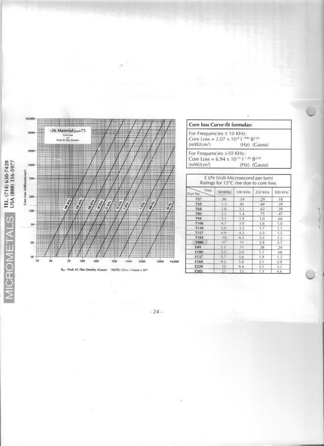

What information did you use to determine the temperature rise of the 26 & 52 material toroids - can you apply the same magic to these cores ? Data P64 Here
Also I have been considering a scheme not running 4 FETs in each bridge leg in parallel. Instead, run 4 separate bridges (1 FET each leg) from the same drive signals and drive 4 smaller (toroidal?) chokes in parallel and then re-sum them together at the main power toroid. Itopower has also mentioned a similar scheme for his 3 winding primary. It would appear to have a few benefits, solve the issue of 1 FET carrying too much current due to on or off speed mismatching when all in parallel. The chokes are also easier to wind and 4 smaller ones are simpler than 1 big choke. The oscillations from paralleled Mosfets should disappear also.
I look forward to your comments.

Posted: 09:01pm 19 Mar 2019
Micrometals publish loss curves for all their powdered iron grades, but it gives figures of milliwatts per CM cubed which is not very helpful as far as estimating temperature rise goes.
In the previous picture I posted (above ^), down in the bottom right hand corner are some figures for volt microseconds per turn ratings for 15C rise. That is for 26 material.
We can assume 48 volt square wave 23Khz which is 43.4uS per cycle. Maximum loss will be at 50% duty cycle or say 21uS. So the core sees 48v for 21uS in one direction, then 48v for 21uS in the other direction. That would be 1,008 volt microseconds.
Its not actually not going to be quite that bad, because the PWM is a modulated sine wave.
Anyhow we could say that the picture above tells us that a T400 core will rise by 15C at 50Khz at 17 volt microseconds per turn.
Our requirement has 1,008 volt microseconds.
So the minimum number of turns required for 15C rise would be 1008/17 or 59 turns (on one core at 50Khz).
Clearly we are not able to do that. But we could stack five cores and have 12 turns and be spot on for 15C rise. That may not suit our dc saturation requirements, but we can juggle turns and number of toroids to get a workable soloution.
