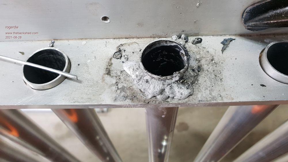

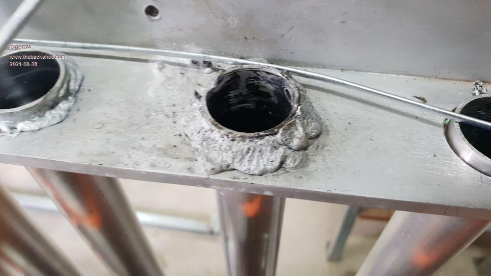

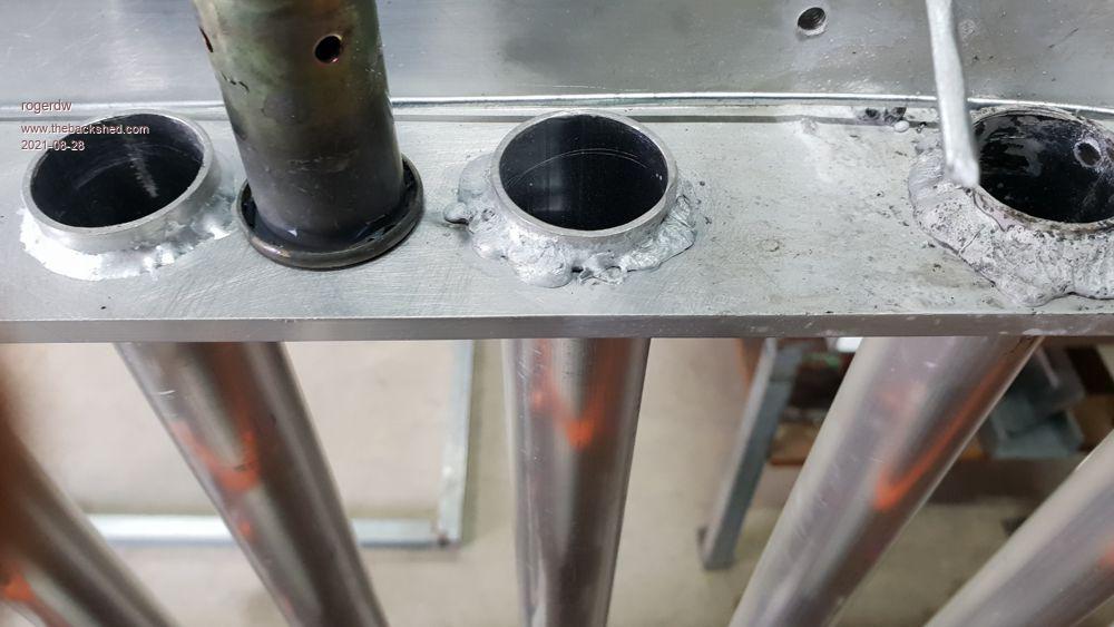

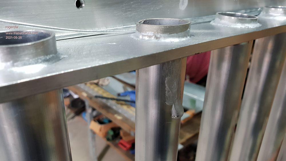

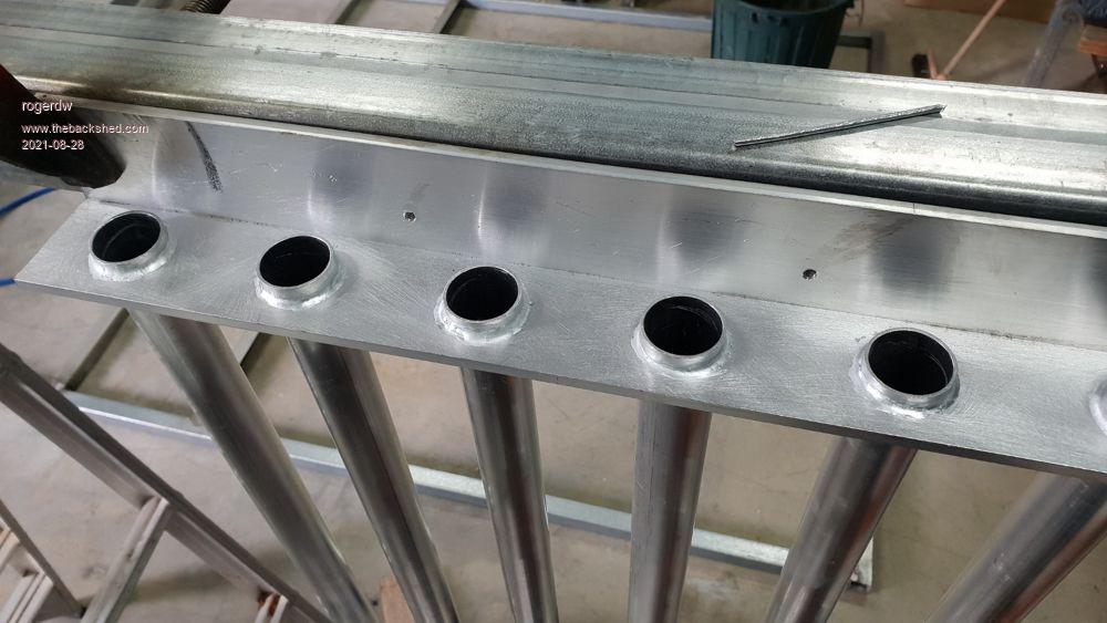

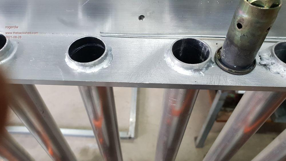

Just came in for a coffee after trying to weld these aluminium tubes into the 6mm angle.
I know, I know  ...  don't give up your day job!!!
Here's the first one  ...  half done  ...  59 to go  ...
First two were with the oxy using standard aluminium filler wire and flux etc
Gave up on the oxy and tried the brazing rods again  ...  using a propane torch.
Think I'll stick with this method
Once they're all done, I'll tip it upside down and sweat in the other side.
The brush marks on the ally are from when I cleaned it before brazing  ...  and I've done nothing to it since  ...  that's the finished look.
I had one run through and down about 2 inches. I thought I'd grab it with an old pair of side cutters and twist it off  ...  like solder when it drips.
The amazing part is it is actually bonded properly to the tube and I couldn't twist it off or cut it off  ...  so this stuff does actually work.
Huge relief to see that I can actually complete this part of the job as it's been a roadblock for a month.
Cheers,  Roger

Reading and looking at your first pics I thought " Yep, exactly how I would expect them to look, Ally is NOT easy."
Looking at the last ones, that was NOT what I expected. They look brilliant!
I'd be damn pleased with them I did them.  Actually, no,  I'd think I was dreaming and someone else did them for me.
Don't get too pedantic with the double welding. These things have virtually no structural load and only really need to be held in place and sealed up against low pressure air.... that won't matter a damn if there was the odd tiny leak that may be there.
Thats a VERY good job there Roger, very Impressive. Could you link the exact rods you are using?  Would be an asset to be able to weld ally like that.

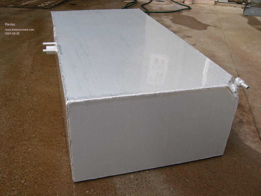

That should do the job well enough Roger,
That is a lot of Ali to heat up to welding temp, in any case.
This is a fuel tank for a boat, built back in 2002 some time, its not that tidy but it was under the floor where know one could see it, the preference was to have absolutely no leaks.
You can see the the bead from each dip of the rod wile running the Tig and every so often it has run over a tack made by the Mig to hold it together.
It was wire brushed before welding, then finally acid washed.
The braze welds you have are as I would expect them to be, quite smooth.
This would be one of the more difficult areas (thin pipe onto thick angle) for a Tig weld...On a good day.
Would also find it difficult to get the Tig around the back of the pipe between the angle.
The braze rods you have are the way to go.
Looks like a good job, keep at it.
