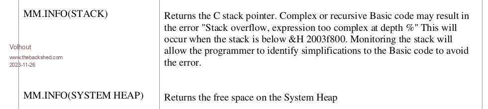

Posts: 6101
Posted: 08:13pm 25 Nov 2023
Hi Tom,
Would this give the required information ?
I have no idea how to use it, but if I type this after the "not sufficient memory" error it should help us finding improvements ?
When I run the game engine, and stop (ctrl-C) and type
?MM.INFO(SYSTEM HEAP)
1488
No idea if 1488 is much, or little...
After "NEW" I get the same answer (1488).
P.S. in Dutch (my native language) I could not find any word that matches bo**ocks, and my English might need an ugrade...
Edited 2023-11-26 06:19 by Volhout

Posts: 11838
Posted: 09:49pm 25 Nov 2023
System heap is irrelevant for all but the WebMite
mm.info(heap) lets you know how much of the MMBasic heap is left. MMbasic memory is split into two sections. Variable memory = 28K - for individual variables (56-bytes each) and heap (132K on the PicoMite and 100K on the VGA) which is used for strings, arrays and various working buffers (mod file playback uses 24K). Your application is unlikely to get near using the 512 variables available (256 global + 256 local) but it sounds like you are using a lot of the heap memory.
