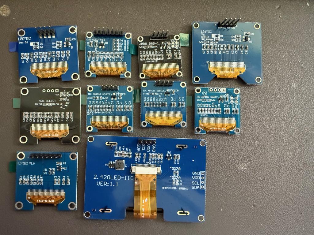

vincenthimpe
Joined: 14/10/2018
Posts: 86
Posted: 03:56pm 30 Apr 2025
  matherp said  V6.00.02RC19 is available on
Implements support for initialisation of SSD1315 displays as well as SSD1306. Use "OPTION LCDPANEL SSD1306I2C,L,2" for 1.3" displays
I found one 1.54in Oled with SSD1315 that does not need offset. if you have two columns on the left of the screen with garbage pixels set the offset to zero :
OPTION LCDPANEL SSD1306I2C,L,0
SH1106 controller also works.
So far every Oled i tried works. All of these were found on Amazon. I have a few more on the way from other sources as well as SPI and switchable versions. Will update when they come in.
The very large one is power hungry and needs its own regulator with at least 100uf of bulk capacitance close to the power pin. without it the illumination is uneven and not all pixels are same brightness. It depends on what it shown on the display. It has a built in switcher that creates a lot of noise on the power rail.
great work ! thanks
Edited 2025-05-01 01:59 by vincenthimpe
