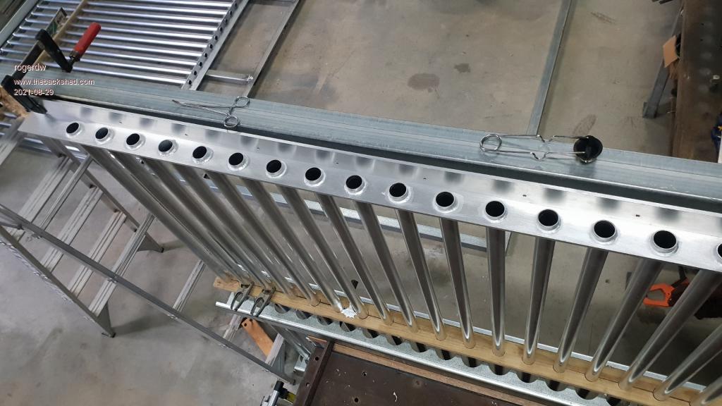

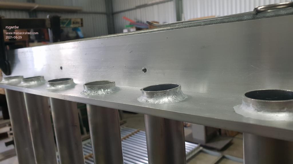

  Davo99 said  Reading and looking at your first pics I thought " Yep, exactly how I would expect them to look, Ally is NOT easy."
Looking at the last ones, that was NOT what I expected. They look brilliant!
I'd be damn pleased with them I did them.  Actually, no,  I'd think I was dreaming and someone else did them for me.
Thanks very much, that is very kind of you. I never had a result anything like that while I was experimenting with the brazing rods  ...  that's why I wasn't going to bother with them.
Actually what did sway me (apart from the shockingly bad first weld attempts)  ...  was watching a couple more youtube videos on the rods. Most of the videos demonstrating the rods focus on welding a hole punchd in the bottom of a drink can  ...
...  but I kept looking for a video on welding thick material. Once I watched that, I felt a lot more confident.
  Quote  Don't get too pedantic with the double welding. These things have virtually no structural load and only really need to be held in place and sealed up against low pressure air.... that won't matter a damn if there was the odd tiny leak that may be there.
Yeah, good point. I realised as I was welding, that if I do try to weld the other side  ...  to get it hot enough to braze  ...  it will also melt the top side again  ...  and I'll end up with the pipes all shifting or with "dry joints".
That lump that ran down the pipe in the last photo  ...  I used a chisel to try and slice it off. After 4 or 5 sharp whacks, hitting upwards, the weld broke and the pipe went up through the angle. So I had to weld that one back in. But it held remarkably well considering how hard I was hitting it.
  Quote  Thats a VERY good job there Roger, very Impressive. Could you link the exact rods you are using?  Would be an asset to be able to weld ally like that.
I tried two different types from ebay  ...  and with those I found I was melting the aluminium before the rods would melt. Though to be fair, now that I understand how they are supposed to work, it may be worth another try.
The third type I bought and have now just used are actually made in Australia.
They are Ultrabond 3.2mm aluminium brazing rod  ...  and I bought them online from hampdon.com.au
Go halfway down the page and they show them sold in lots of 5, 10 or 30. It was $49 for 30 rods plus freight  ...  see here
You can also buy just one rod  ...  but $17.99!!!

  Revlac said  That should do the job well enough Roger,
That is a lot of Ali to heat up to welding temp, in any case.
Thanks Aaron, and yes it was a massive heat soak. And to make it worse I had it clamped to a great thick walled length of square tubing which soaked up even more.

  Quote  The braze welds you have are as I would expect them to be, quite smooth.
Yes  ...  and in some ways it's a bit like soldering  ...  just a lot more heat!
  Quote  This would be one of the more difficult areas (thin pipe onto thick angle) for a Tig weld...On a good day.
I'm glad you said that  ...  I don't feel so bad about not being able to get my TIG or oxy to work.
  Quote  Would also find it difficult to get the Tig around the back of the pipe between the angle.
Yes, I can understand that. The tubes were supposed to be virtually flush  ...  but somehow things shifted and I wasn't going to bother setting it all up again  ...  but it did cross my mind that it would be hard to get behind there
  Quote  The braze rods you have are the way to go.
Looks like a good job, keep at it.
Yep, I've finished the first side with 30 pipes, so just have to set it up again to do the other 30. Will be much easier second time around.
Thanks for the encouragement Aaron, and everyone else as well.
Cheers,  Roger

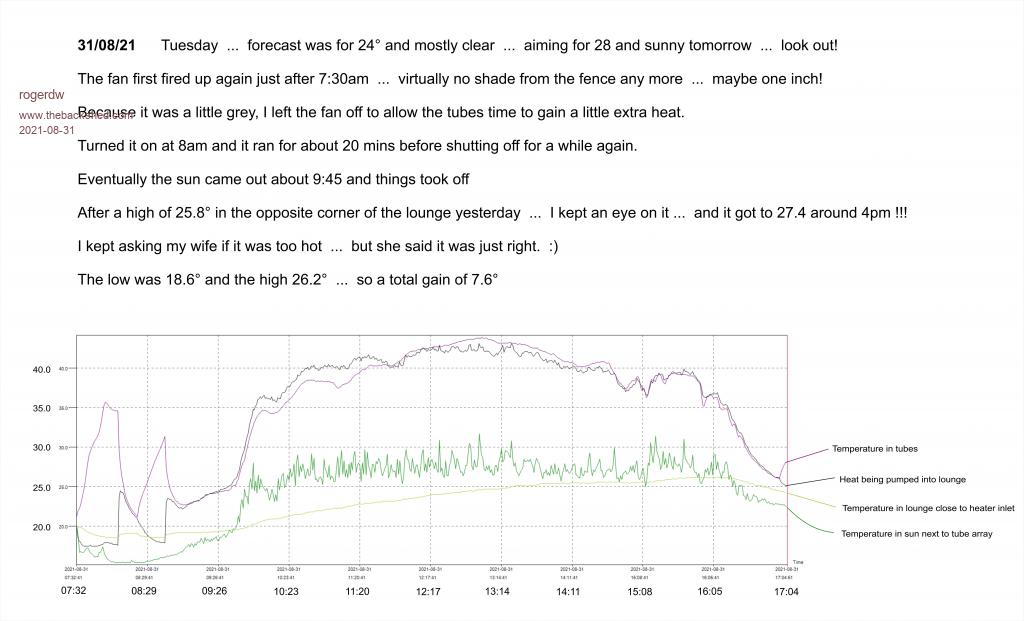

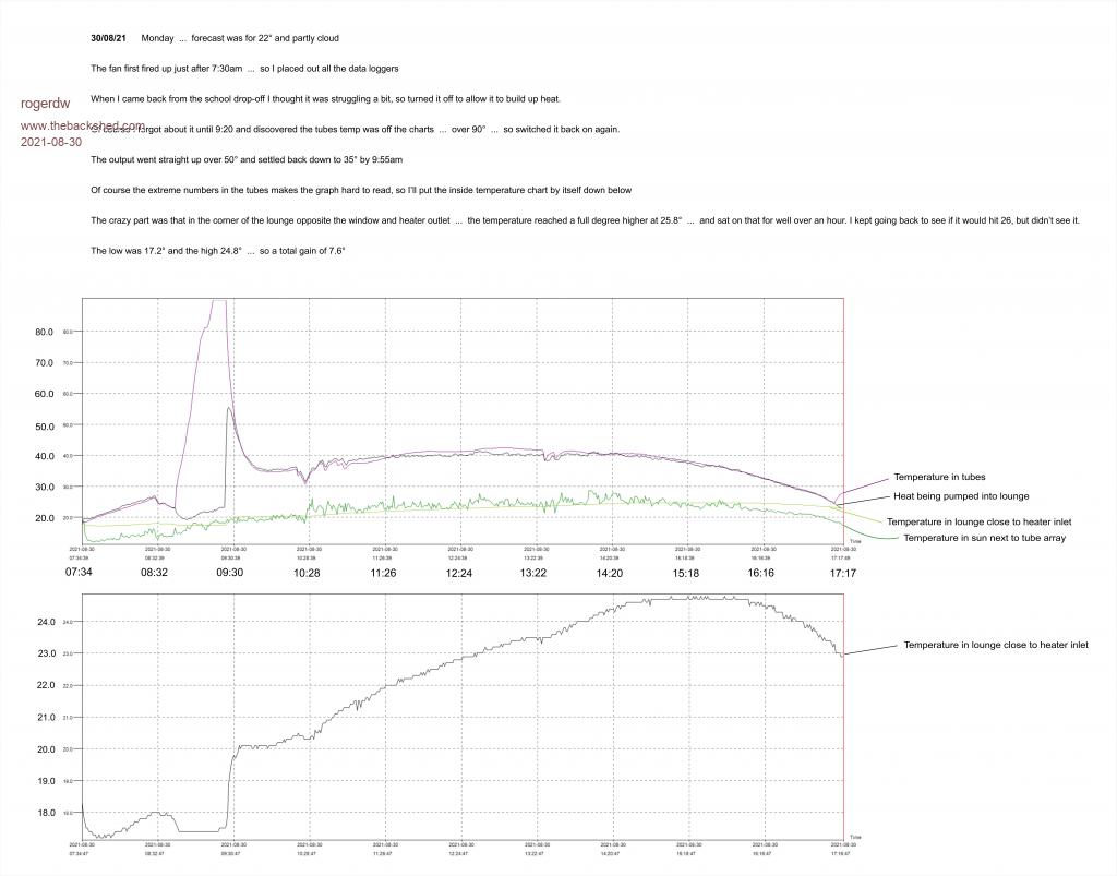

  Warpspeed said  It should be possible to just leave it switched on 24 hrs, and just let the differential controller do its own thing. No need to let the tube temperature build up initially, that is just wasted heat.
If its 13.7 inside and its pumping 19.5, that is still heat gain, which will then rapidly increase as the sun rises. It will likely cycle a few times by itself initially if it needs to, but just let it take care of itself.
If it ever does start pumping continuous cold air when its freezing outside, adjust the controller settings up a bit.
Yeah, that is what I've been doing ever since I've set up the differential controller  ...  it was just yesterday being so cold that made me think if I left it off for even 15 or 20 minutes it would have time to rise 20 or 30 degrees.

Those brazing rods are really good, but like many things these days, there is a lot of fake crap out there. Plenty of horror stories on the internet about e-bay bargains.
The proper rods melt at a temperature far lower than the melting point of aluminium. The fake rods have a higher melting point, and are probably just very expensive aluminium filler rods !
If you buy from a respectable tool or welding company, American, Australian, or European, they should be o/k.
The ones I bought from e-bay were called "HTS-2000" and worked very well.
I also have an ac/dc MIG plus argon, but its sometimes difficult to get right into very restricted corners with the arc. The arc tends to jump away from where you want it to go.
On the other hand, the brazing rod can be poked exactly where you wish, into a very confined space, once the whole thing is sufficiently pre heated.
The secret seems to be scrupulous surface prep using fresh new aluminium, and you cannot really go wrong.

  Warpspeed said  Those brazing rods are really good, but like many things these days, there is a lot of fake crap out there. Plenty of horror stories on the internet about e-bay bargains.
Yes, exactly the conclusion I had come to. With the dud rods, I ended up with the aluminium so hot that I was poking holes through it with the rods as I was trying to make them melt.
When I first tried the ultrabond rods from Hampdon.com.au  ...  it was obvious they were melting at a much lower temperature. I could see the effect just like shows on their youtube videos.
  Quote  On the other hand, the brazing rod can be poked exactly where you wish, into a very confined space, once the whole thing is sufficiently pre heated.
Yes, that part is handy  ...  being able to poke it into any tight spots.
I think what surprised me the most was when some ran through a gap  ...  a couple inches down the outside of a tube.
I figured it would just break away  ...  like solder does when it drips down something  ...  but this stuff was bonded well and truly  ...  and it was way down onto a section that I hadn't cleaned.
For me, the secret seems to be in getting the whole area really hot  ...  not just a square cm at a time like you do when using an oxy. I was blasting the whole area I wanted brazed  ...  melt some on  ...  heat some more  ...  then finish the job.
I set up the second bank of 30 tubes today and had them all brazed in in under 2 hours. Very happy with how they turned out.
Cheers,  Roger
Posted: 12:41pm 29 Aug 2021
Very nice indeed Roger, that will be very strong too.
As Dave says, the braze will completely fill the joint, no need to do the other side.
Looking at this pic on it's own with no insight, one Might be forgiven for thinking you were making a shark Cage, a flash set of bars for a Prison, The worlds largest towel heating rack or a ladder for fat, wide people with little feet. Doesn't look like my boots would fit through the gap in those rungs. The width might be appropriate though.
Again, VERY neat and professional looking mate. Shame you have to hide it.

  Warpspeed said  Very nice indeed Roger, that will be very strong too.
Thanks Tony. It certainly feels strong enough  ...  and will be good not having to pour all that heat into it again to do the other side.

I haven't posted any charts lately so thought I'd throw one up. I did try turning it off this morning for a while to let it build up more heat, then promptly forgot to turn it back on.
Certainly performed once I set it going again.
I realise most of you would be turning on the air conditioner if you had it that hot!!
Cheers,  Roger

I think I'm gunna run out of time for using the big one this season  ...  it's warming up already.
Forecast was for 24 today, 28 tomorrow and 32 on Thursday!!!  ...  though 17 on fri and sat.
The lounge hit 27.4 today and the wife claims it was 'just right'.
Cheers,  Roger

I want to see what sort of gains you can make on thursday.  Don't worry about being too hot, will be cool on Friday, rack up some thermal  heat sinking. Crank that Baby up, we...... errr, YOU, need to see the data so you can set the New one up to keep your wife comfortable and happy which is the whole reason you are doing this and what you live for Right Mate..
Make sure you remind her of that, Frequently.
Maybe you could experiment with rising the cut in point a bit. That's all you are doing in effect with turning the thing on later anyway.
There is definitely an amount of capacitance in them so you probably aren't loosing any heat anyway.

  Quote  Maybe you could experiment with rising the cut in point a bit. That's all you are doing in effect with turning the thing on later anyway.
Yes, that is correct. I think the problem only really shows up when it's particularly cold  ...  if I have say 15 degrees inside and the fan comes on when tubes read 27 (12 above)  ...  it doesn't take long and the output drops  ...
...  and it doesn't turn off until it gets down to 20 degrees. Which even though it's 5 degrees warmer than the room, still feels cold if you get in its way.
If it's 18 in the room, then it's quite a bit different.
The reason I don't want to make the high temp setting (Hd) any higher than 12 degrees is because often the tubes will have quite useful energy still left in them  ...  but they struggle to get much more than 10 or so degrees above room temp  ...  so the fan doesn't come on to extract it.
And once the room temp is up around 20 or so  ...  the low cut off is 25 (Ld at 5 degrees)  ...  and that is still ok to have pumping in if you are feeling that breeze.

  Warpspeed said  If its anything like Melbourne, its 28 degrees one day and 15 degrees the next.
Probably time to start thinking about a room thermostat to tame the monster.
Haha, yep. Though it's good that she's happy to have it get really hot because it must retain it a lot longer. I have to go back out to the workshop coz it's too hot for me  ...  but just happy to know we're saving lots of wood.
