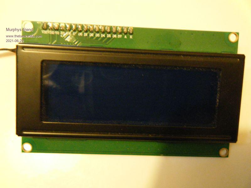

It looks as if I have a question already , I found this display panel;
It looks as if  it has that required serial port on the little piggy back PCB, would this be suitable for the home brew MPPT project?

It has the I2C port. 4 wires, 5V, GND, clock and data.
It is easy to connect this LCD to yet another nano, program it and then connect the nano to both the LCD and the mppt.
Why go this way with extra nano?
I find the I2C bus to be very sensitive to EMI and this can upset the
smooth running of the mppt firmware.
I have tried using I2C direct from LCD such as yours to the mppt.
The EMI from the choke is quite intense and it stuffs things up.
This was the case with the last mppt I built, with it all inside the
Festo jigsaw metal carry case. Your build might be OK with I2C. Who knows.
I sorted it out permanently with the nano/LCD communicating with the mppt
with the 3 wires going through a mains clip-on choke 2 turns.
The 3 wires are 5V, ground and data (for serial data, 9600 baud, 8 bits, 1 stop bit
no parity)
Earlier in this long thread I posted the LCD nano code.
There are two versions, depending on what LCD you have got.
Some people have LCDs without the little I2C board attached and
so we communicate directly with the LCD controller chip.
Others have the LCD as you have, with the I2C module.
So there are two different programs for the nano/LCD assembly.
I go to all this trouble to end up with 3 wires connecting the mppt and the LCD.
The wire lengths are quite long, maybe 8 inches or more.
I want to have the wire leading into the mppt nano going to a more
EMI resistant pin, to be setup as a digital output pin.
This means the EMI has to pass back through the pin's output stage and then into the
microcontroller chip's guts. And this is a lot harder for the weak current
of the EMI.

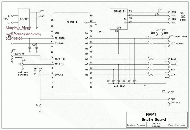

Murphy's friend
Joined: 04/10/2019
Posts: 678
Posted: 08:52am 01 Jul 2021
Thanks nickskethisniks, I know you are being helpful but its like as if you are talking in a different language to this programming challenged person.
For example, the many acronyms programmers are so fond of using are nothing but a mystery to me. If I cannot find a similar mention on the schematic, showing just where that particular signal is, I'm lost.
So I have no idea what sda or scl stands for, sorry. Can you explain please?
I like building electronic things but when they require a nano to  program in order to work, that is a major hurdle for me.
What I would like to do is to lay out a MPPT brainboard PCB with the same footprint than my LC Display panel so they can be piggy backed on spacers.
I need to know if the extra nano poida mentioned to 'program' my above shown display panel is a permanent or temporary affair. So, one or two nano's for this project?
If I can get the PCB's and all required connections sorted out first I can find somebody to do the programming bit for me if this proves to be to big a challenge.
Oh I'm trying to fit this into a commercially available case, that's why I use my own PCB's.
poida
Joined: 02/02/2017
Posts: 1497
Posted: 10:11am 01 Jul 2021
Murph, it's a piece of piss.
get a nano, program it with this
nano_serial_to_i2c_LCD.ino.zip
connect it to the I2C LCD you have. 4 wires, 5V, GND, CLK and DATA
The Nano I2C clock is pin A5, data is pin A4.
after programming, when it reboots you get a message
"yada, yada, 9600 baud etc.."
good.
find 5V pin on that Nano, run a wire from it.
Find GND, run a wire from it
Find D10, run a wire from it, this is serial data IN for this Nano.
So there are 3 wires.
These 3 are hooked up to 3 of the pins of the 4 pin connector of the brainboard.
But you will make your own PCB. Great!
The mppt firmware outputs serial data via pin A4.
Only 3 wires. connect A4 of the brainboard equivalent (you will be designing)
to pin D10 on the Nano that is hooked up to the i2C LCD.
And 5V and GND.
There are a few reasons I like going this way.
1 - low EMI fed back into the mppt Nano. Pin D10 is set as digital input and
much more robust.
2 - ZERO and I mean 1/2 of f%ck-all overhead from sending the serial data.
3 - NO F^CKING LIBRARIES ARE USED. This is important. Most libraries in the Arduino system use interrupts and other things that can interfere with YOUR/MY code.
The mppt code such as
mpptv5_BV_tempco.zip
which is the code I run on both of my mppt controllers
runs like clockwork when we use the serial data coming out of pin A4 of the Nano on the brainboard.
It has not stopped or failed ever.
So I now require this. That is to say I support anybody who builds using it.
And I want to discourage use of I2C on the brainboard Nano.
I2C libraries mess up my interrupt timing and they need 2 wires,
A4 and A5 to be high impedance and wide open to any low power but high frequency EMI
that is around and about.
I hate that.
Since I first build mppt number 1 and ran it well before September 2020, I have never needed to reboot it. It's ran continuously since then.
It just works.

Poida, I took the liberty to re draw your schematic to include what you wrote in the post above.
Can you please have a quick look to see if I got it right or missed something? Thanks.
Note, There is no 10 pin connector, I don't like the ribbon cable idea. I made provision for shielded cable for the V & I in/out signals. I'm also using a small (3W) isolated on board DC/DC to get the 5V from a battery voltage to 12V DC/DC elsewhere.

it looks about right.
I would drop the current sensor (pin D6, D7) since I have little faith
it will work.
I do like how you have made a clear separation of the I2C and the Nano1 that drives the PWM.
The existing latest code will work with this too.
Make sure the 5V supply can drive the LCD and Nano2.
I would allow 100mA for that.

Thanks Poida, that was a quick reply .
I will drop D6 & D7, the less parts the more room for others on that PCB .
That 5v DC/DC can do 600mA, should be enough  for all the 5V requirement. Its a RECOM R13 Series isolated converter I get from RS components. Nice and small too.
