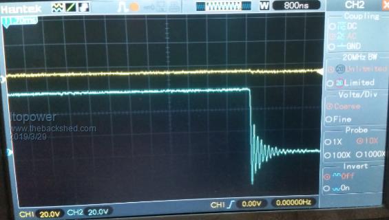

Posted: 08:31pm 28 Mar 2019

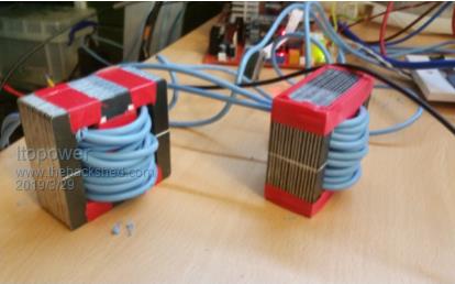

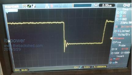

Bit more testing... gapped two of the E70's with 6 sheets of paper so around 0.5mm to 0.6mm gap, which should bring the AL down to around 1500.
Added 8 turns to each E70, so approximately 102uH (still waiting for the inductance tester to arrive.....) and then connected in parallel so overall approx 51.2uH...
Idle current is now even lower than ALL of the previous test combinations, but there is something a little odd, or not ?
The switch off is showing some ringing and an overshoot..... the switch on shows nothing significant.
Now, I do have the supply for this test setup rigged up to a boost converter, which is also showing ringing, which I'm now presuming is the inductance energy trying to go back to the source supply after switch off ? That's my guess and probably wrong...
Quite puzzled how idle has dropped further with such a small gap added even though the E70's are nowhere near saturation currents. Does the very small air gap impact the di/dt that much ???
ltopower
Joined: 08/03/2019
Posts: 64
Posted: 08:33pm 28 Mar 2019
These are the E70's (twin wire as its one wire per winding, could have joined them and made it easier with a single wire...).

This is a better capture on the scope... my scope is not quite as good...
This is a switch off with the ringing. around 6.25MHz.
ltopower
Joined: 08/03/2019
Posts: 64

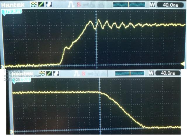

Posted: 11:22pm 28 Mar 2019
Realised the gap was 0.5-0.6mm across so the gap the inductor sees is double that.... so re-wound with 12 turns (approc 126uH each) of single wire this time and the idle dropped even further to around 19W.
The signal is now sort of clean....
Switch on as the top trace and the switch off on the bottom.

My thoughts on the ringing are that it's due to the paralleled MOSFETS.
One conducts just that little bit before the others, and then the whole thing
is monstered by that eager switch, pulling the Vds down a lot, on it's own, then it lets it rise, the others might switch on then, pulling it down, Vgs now is altered, letting the switches open a bit, and so on. A right party with lots of booze.
I am very keen on the idea of separate primaries for each of the full bridges.
This will mitigate the Vds thing with parallel switches.
But be extensible to the power needed. All with clean switching.

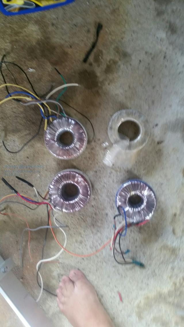

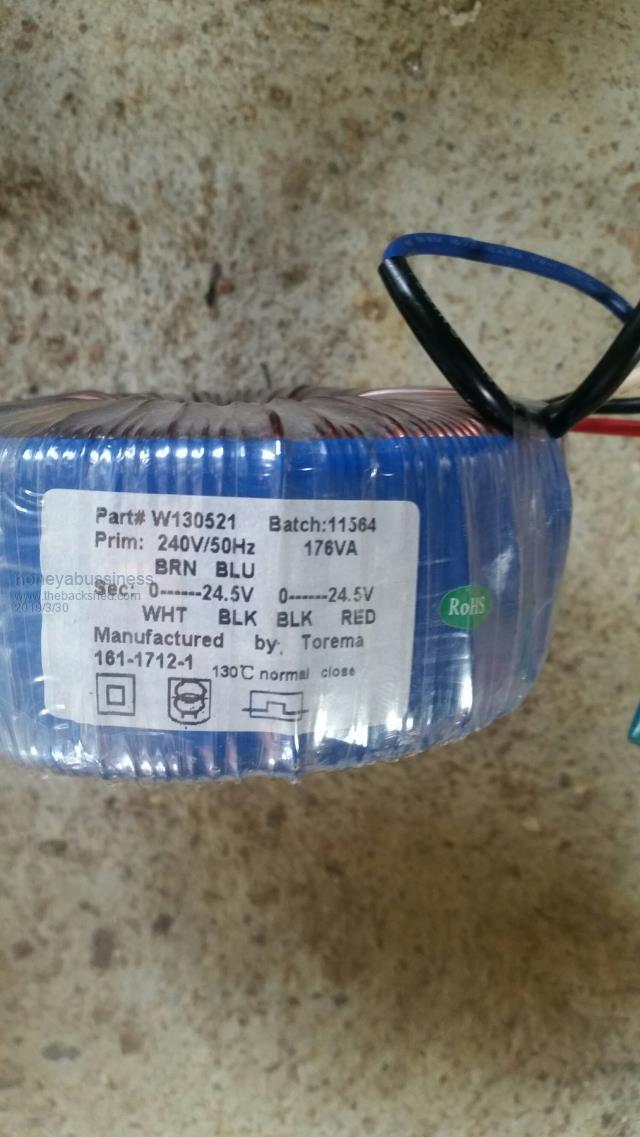

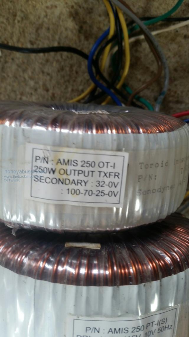

noneyabussiness
Joined: 31/07/2017
Posts: 527
Posted: 04:57am 30 Mar 2019
  noneyabussiness said
  poida said

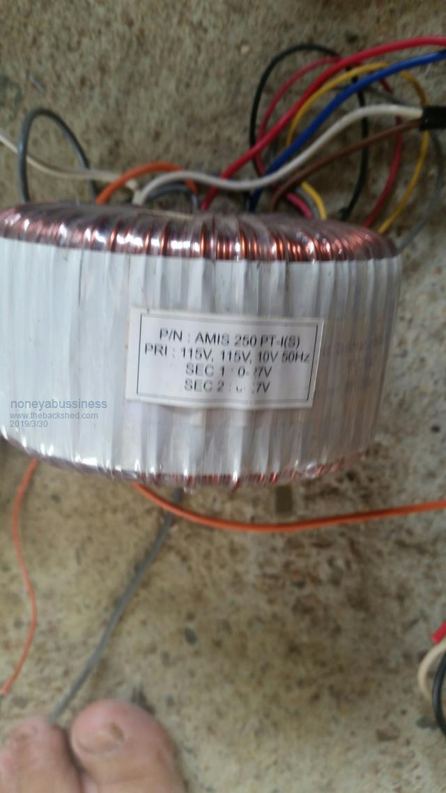

  noneyabussiness said   Poida, i have a few small toroidal cores you can have , around the 250watt mark, if you want... ill double check, but i have at least 3, maybe 4... just let me know and ill post em to ya..
I think they might be useful, what are the winding voltages?
I am hoping convenient. I don't want to hand wind a 100V at 0.3V/turn.
Ill check them out as soon as i can. I have 1 bare transformer, but the others are still factory set...
Let me know if useful and which one/s you want...
I think it works !!
noneyabussiness
Joined: 31/07/2017
Posts: 527
Posted: 04:58am 30 Mar 2019
The first primary voltage is 27v
I think it works !!

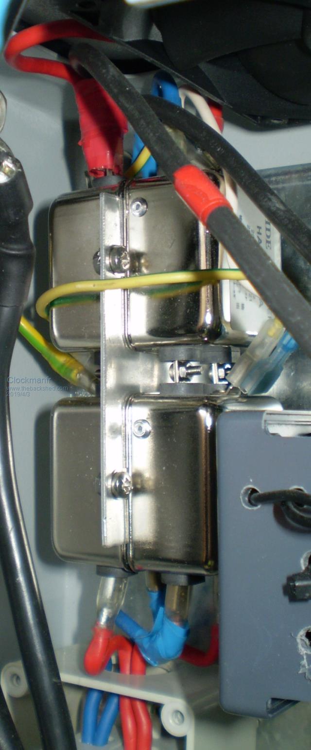

Clockmanfr
Joined: 23/10/2015
Location: France
Posts: 437
Posted: 07:53pm 02 Apr 2019

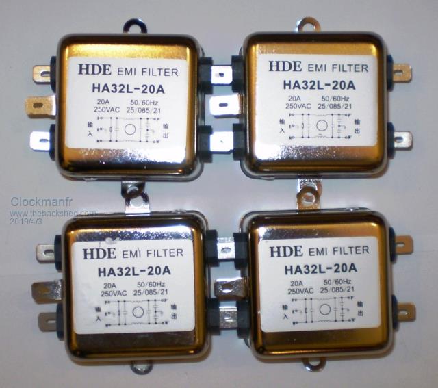

EMI Filter.
For my 6kW OzInverters I am using 4 EMI filters rated for 20 amp, 250vac and 50HZ.
“May need hf filter on the 240v outputs to get rid of all the switching noise.
For the HZ meter to not track properly I assume it is an auto ranging meter... they are a pain if there are any harmonics around, or the fundamental is not very very clear.
The lack of shielding ( spread across the desks ) will allow a lot of RF radiation too at high power, and these frequencies will range up to and over 20khz... a big filter will help control this when it is in a metal box.... keeps the hash inside...”
“Look for EMI filter. You may need a few to get the current rating. I see a few from china 20A fir 10 AUD... four of these series parallel would be fine. They are single stage, so one after another will be ok, and doubled up in parallel to get the40amp rating we need…….. oztules
That’s 2 lots of 2, parallel, giving me 40amp rating and a double stage EMI filter.
