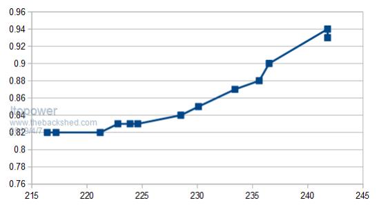

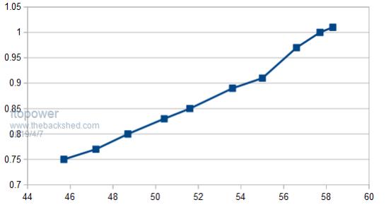

Been doing some more testing on the inverter using two E70 gapped chokes on the primary and noticed a few things.... thought this was themost interesting...
The idle current has a "sweet spot" for minimal current draw depending on the inductance (the bottom axis is turns).
This setup the chokes had a saturation around 43A per choke, two in parallel, so about 4.1kW at nominal input voltage. While testing and trying to measure overall efficiency there appeared to be a small change in overall efficiency around 4.1kW. This may have been by chance or not..
So far I must have tried and wound well over 50 choke variations and many screen shots of the scope output. But, even with all that I'm still struggling to actually see the true "consistent" effect of the choke behaviour.
This is the impact on idle current draw compared to the battery input voltage....
This is the impact on idle current with various output voltage settings (no change to choke arrangement).
Separate set of data also shows specific knee point where I think the "ideal" choke inductance occurs.
For all the testing so far I'm becoming more convinced that there is a specific inductance required per inverter. Above that point losses increase. Below that point losses increase. What I'm still not clear on is does the minimal no load idle losses really actually represent the ideal inductance to be used under load.....

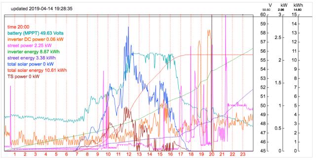

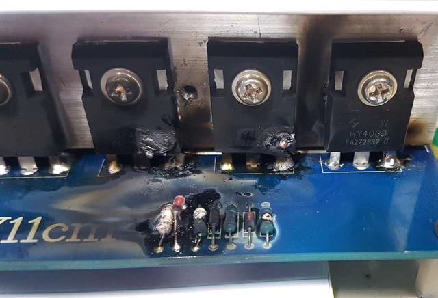

Part 30: External influences beyond any reasonable hope of control
And so, it has come to pass...
This is an inverter driven by an 8010, and the 50Hz 1/2 bridge blew up, taking the gate drive diodes, resistors, all 6 MOSFETS, and the EGS002, and the 2 TVS protection diodes. Things were going so well: that's what we always think.
Here is the data from my monitoring system.
The failure occurred where the black vertical line is located, almost exactly 8pm or 20:00hrs
It shows the DC power drawn by the inverter, in Orange.
See the two large peaks just before failure, and the rest of the day was low, maybe only
250 to 500W.
What happened?
My wife had done some rearranging of the power leads and stuff in the spare room.

In the past my blowups had never dealt such damage to the gate resistor/diode network. Those were the result of bad voltages finding their way back to the gate drive IC inputs.
This time I think this is what we get when we run things too hard and the MOSFETS get too hot.
I had the inverter board running again the next morning and I have relocated the radiator to use street power. And I asked my wife to consult with me prior to changing the supply of power for any appliances in the house from now on.Edited by poida 2019-04-15

Posted: 01:57pm 14 Apr 2019
I see, you are still using street power as well - I do not and did not realise you do.
Regarding your excellent blow up picture above, you can see the mosfet got hottest just above the source leg. That is exactly where inside the black housing the two tiny wires from the leg to the substrate are located.
Yours was a slow heating effect, a fast one blows the housing apart just there.
Interesting to see you recorded the trace of the event.
At least now you have a good excuse to build a much more robust (against overloads) inverter from scratch .

Brilliant post, shame about the damage. I'm guessing it's the same board you lnked to a post in another thread (BenandAmber).
Interesting overheatin, the load appeared to be around 2.5kW with FET per leg, which seems low ? Colling fan issue ? Choke saturation ?
Think I might be applying more solder to the legs on my board to help with the heat dissipation a little. I left it after the last post, but will re-visit and sodler them.
Is it possible to add a small heatsink / bar to the front of the FET as well ? Drill through a small aluminium bar and bolt it to the front of the FET packages (using the through bolt) ? Downside might be blowout failures might cause a bit more damage ?
The other option I was looking at was dipping the FET board in oil and removing the majority of the heatsink, although I wondered how FET failures would behave under oil, throwing oil.
