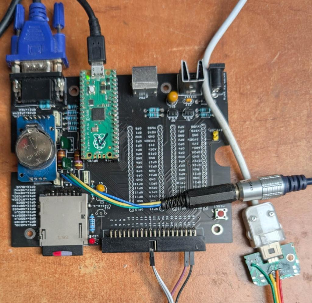

This is a stripped section of PETSCII that will crash in 2 minutes 16 seconds (1360 loops).
It is not 1 minute 42 seconds, but I fixed the game loop in this test to 100ms (10fps), and the actual game is slightly faster.
As there is almost no memory usage, heap is not important. If anything, then C-stack.
This code only prints dots on the screen while playing music and scanning WII classic remote. Nothing else.
wii_test.zip

Hi Peter,
This is the option list for the PicoGameVGA platform (very similar to the VGA design 2). Using GP26/27 for I2C for RTC and WII.
> option list
PicoMiteVGA MMBasic RP2040 Edition V6.00.02RC20
OPTION SYSTEM I2C GP26,GP27
OPTION KEYBOARD US
OPTION RESOLUTION 640x480 @ 252000KHz
OPTION SDCARD GP13, GP11, GP12, GP10
OPTION AUDIO GP6,GP7', ON PWM CHANNEL 3
OPTION RTC AUTO ENABLE
OPTION MODBUFF ENABLE  192
OPTION F5 flash run 2
When I run PETSCII from commandline, or run it from the filemanager, has the same problem. F5 invokes the filemanager in my platforms.

Harm
We knew this was going to happen.  Your test program doesn't crash for me. Running on a "genuine" vga design 2 board. The only difference is that I'm using GP14,GP15 for the system i2c and have the RTC module plugged into the board.
Have you tired different CPU speeds? Can you correlate the crashes with the mod file looping round? Can you run the test on and RP2350 to see if it makes a difference?

@Peter,
I can also duplicate it on the VGA design 2. Connecting the WII classic to GP14/GP15, with the RTC placed and using V6.00.02RC21.
It only takes more time. In all cases, the screen is filled with dots (the code prints these), and the final character before the crash is always en "E", not a dot.
Please let the code run for 20 minutes, and check for silence (sound stopped) and an "E" on screen.
Posts: 11827
Posted: 03:56pm 05 May 2025
I've been testing this to destruction and I'm beginning to believe it is a bug in the Pico SDK I2C routines.
When you finally get a readable error message it says that a function isn't found which is clearly part of the source.
Neither the system stack not the user heap are showing any issues.
The next step is to try recoding the I2C routines using the bitbang versions and see what happens.......

Posts: 11827
Posted: 05:00pm 05 May 2025
I've tried with different mod files and also replicated on RP2350 VGA AND RP2350 HDMI
That eliminates USB and VGA interrupts. I've also replicated with I2S audio. I've also removed the modsample. I haven't yet tried with playing WAV, FLAC or MP3.
Posts: 6095
Posted: 05:07pm 05 May 2025
@Peter,
When you do not play a modfile (no sound at all, just comment out the "PLAY MODFILE" line) it also crashes, but more impressive, with corrupted VGA screen.
So just repeating the DEVICE(WII B) is sufficient to crash the pico eventually.
Posts: 11827
Posted: 05:10pm 05 May 2025
DEVICE(WII B) does nothing other than read a preset memory area - the interrogation of the Wii takes place in the background every 20mSec. In which case it should crash without that as well - please try.
This is why I'm suspecting the underlying I2C sdk code.

Posts: 6095
Posted: 06:05pm 05 May 2025
Original RC21. Confirmed that just WII CLASSIC OPEN is sufficient to crash the pico eventually.
I will try above version later tonight.
Posts: 11827
Posted: 06:42pm 05 May 2025
V6.00.02RC22 is available on
Fixes a bug in scrolling in the editor when loading a file which creates continuation lines.
Adds a check in the editor which won't let you save and exit if continuation characters create a line longer than 255 characters.
Makes changes to handling Wii Classic and Wii Nunchuck to try and circumvent what appears to be an sdk issue where I2C commands return before completing.
Github updated
