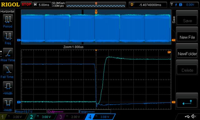

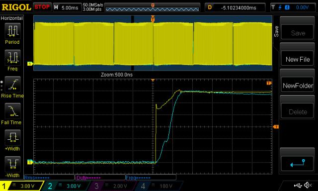

Part 31-B: Looking at gate voltages on the Madness powerboard, driven by Mad's control board
RenewableMark asked "but what about Mad's boards?".
Same test conditions:
52V DC supply
same choke, toroid, cap.
Madness's power board this time, driven by his control board.
** The power board has only one HY4008 fitted to each of the 4 legs of the full bridge.
First, there has been a bit of discussion about the slowness of the TIP41C/TIP42C transistors used in the power board. I thought I could easily show the time delay of the gate drive as it passes through the totem pole drive.
This is looking at the 23kHz PWM half of the full bridge.
(Being a EG8010 derived system, one half of the bridge is driven at 23kHz PWM, the
other half is driven at 50Hz)
Yellow is the IR2110 low side output, taken right at the chip's pins.
Light Blue is the resulting drive from the totem pole circuit, taken across the 20K Gate to Source pull down resistor.
We can clearly see the fast edges of the IR2110 and the totem pole output is a little slower. Notice that there is nearly identical duty time between the two.
looking closer, we see more details.
for the left side of the first capture, and
for the right side.
Certainly a little slower rise times.
But look at the HY4008 specs: rise times are specified.
Turn on and off times are of the order of 20-40nS.
I suspect the "slowness" of the totem pole design is not an issue, it's fast enough
even when using the TIP41/42 combo.

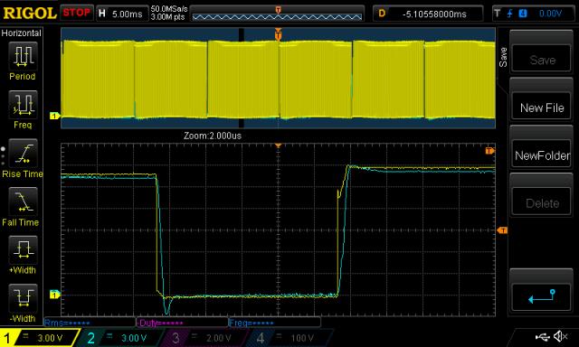

Is there any evidence of shoot through?
This is completing the post I did just before, so as to include Mad's boards.
Light Blue is low side gate voltage (Vgs)
Dark Blue is high side Vgs
No evidence I can see. It looks great.
And the inverter ran nearly silent.
Another example
Where ever I looked I keep seeing these clean gate voltages with no little low side pulses as seen in the previous post of mine.
This is the best I have seen so far and I can't see how it could be improved.
Maybe a little fast rise times from low to fully ON, so as to minimise the
switching losses, but this is good.

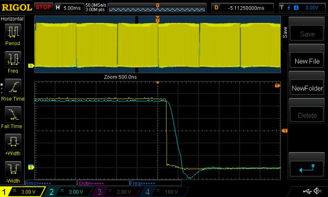

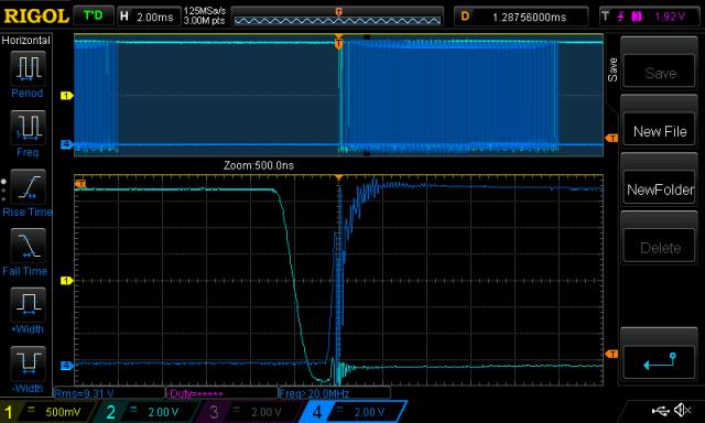

Part 31-C: A powerjack control board driving Mad's power board.
For completeness, I now run the Powerjack control board against the Mad power board.
Yellow is low side gate drive, at the MOSFET pin.
Blue is high side gate drive, at the pin.
It looks to have a bit of overshoot on the low side rising edge.
closer..
Clearly some sort of overshoot and ringing.
This might be a result of the PJ output driving a different impedance now.
The PJ controller is designed to drive opt-couplers, not the totem pole
as fitted to the Mad board.
Notice the 2uS dead time.
No shoot through at all, and the idle current was 0.37A
When the nanoverter is driving this board, the idle is 0.31A
The dead time is hard to determine due to the slower rise and fall times.
Maybe 500-800nS?

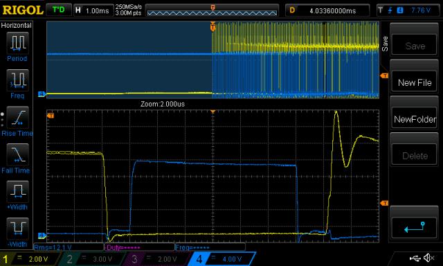

Here is the gate drive voltage from the nanoverter.

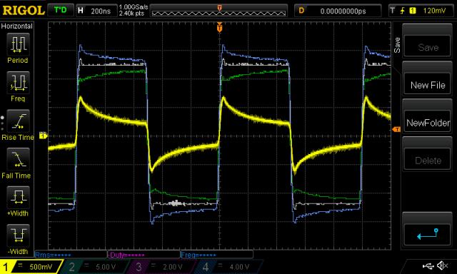

Part 32: Ferrite bead on MOSFET's leads
Anybody who has opened up a Powerjack LF inverter will see there are tiny ferrite
beads on the Drain pins of the low side MOSFETs, on both 1/2 bridges.
The Low side Drain pin is of course that which is connected to the output of the inverter board, leading to the transformer primary winding.
In operation, this output (and also, the low side FET's Drains) are pulled down to DC supply ground or pulled up to DC supply positive.
(pinout for those who might need it)
In previous posts I have gassed on about "dv/dt" more than somewhat.
This post assumes you are across dv/dt and understand cross conduction or shoot through causes and why it needs to be avoided.
RenewableMark gave me a handful of rather large ferrite beads a while ago.
It's time to see what they do.

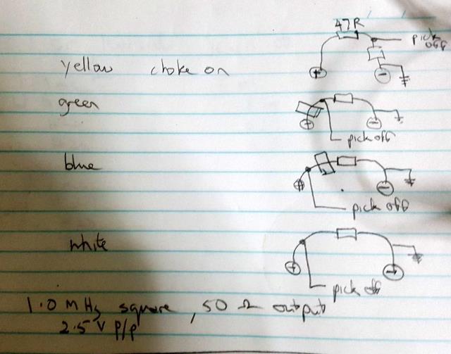

First I set up a simple test to show the effect of one bead on a fast enough rising edge. I put a 1Mhz 2.5V p/p squarewave into a 47 Ohm load and see what effect the bead has. As it happens it has profound effects depending on where you put it in relation to the oscilloscope pickoff point.
White trace is just the squarewave output across the 47R load.
the results:
The test set up:
27V DC supply, into the Mad power board with one HY4008 on each leg.
Same old primary choke, toroid and 10uF cap on the secondary into zero load.
I am driving it with the nanoverter.
I placed one ferrite bead on the low side MOSFET's Drain.
I left the other low side MOSFET as is, with no ferrite beads.
Now we compare the gate voltages of LOW and HIGH during switching
and see if there is any effects due to the bead.

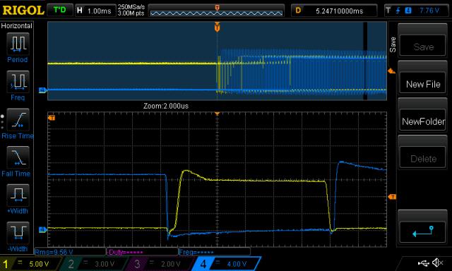

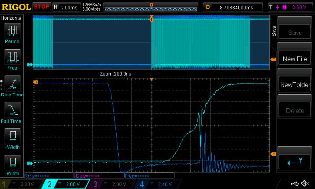

Looking at a time in the AC waveform, about 15% into the sinewave which is
1.5ms from zero crossing, I find on my test inverter oscillations and cross conduction.
Here is the unmodified switch event, when the LOW side opens (i.e. gate goes to zero)
and HIGH side switch closes, pulling the output to DC supply.
The unmodified 1/2 bridge
Yellow is low side Vgs, Blue is high side Vgs

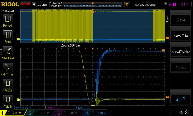

The other 1/2 bridge I chose to add the bead to the Drain.
First, UN-modifed. Looks like the other one. And so it should.
Light Blue is low side, Dark Blue is high side

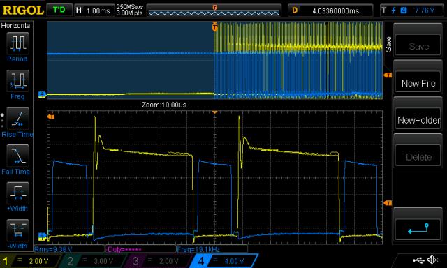

And after the addition of a bead on the Low side FET Drain
This I can only describe as a huge change to the oscillation.
Both the low and high side gate voltages are profoundly altered.
Undoubtedly I will be using these beads in any future builds.
The particular ferrite beads Mark gave me are very conductive and large in size,
so big that they can touch both the Drain and Gate or Drain and Source pins
when installed. The DMM reads about 400 Ohms when you touch one side and the other.
When I installed the bead, I used some shrink tube to insulate things.
The two DSO captures are the same switch event in both cases.
Possibly it's the 25th cycle of the 200 PWM cycles that make up the half wave.
So much for the low side MOSFET and a ferrite bead.
Might there be any advantage in fitting beads on the high side FETS?
There certainly is some oscillation remaining.
I leave this for the next post.
Any views on which pin I should place the bead? (Gate, Source or Drain?)
