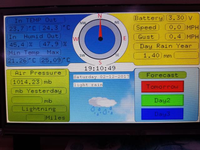

I've now got to the stage where my Serial2 sub is getting the info from the com port
but It won't go onto SUB T1
This is the complete code

Any ideas why it won't get to SUB T1?
The Fieldarray function works perfectly on COM1 so I'm pretty sure that isn't the problemEdited by lew247 2017-12-03

Why is this used?
T$ = Input$(2,#2)
You look to be requiring 2 chars but one is all you probably want at a time.

Run the following code for SERIAL2 sub as is, no variable changes, no comment changes.
Sub SERIAL2 'Com2 ESP8266 Weather Forecast
LOCAL INTEGER M, C
M = GetFieldArray(ESP$)
IF UCASE$(FieldArray$(0)) = "STX1" Then T1
PRINT ESP$; " ESP$ - received from COM2"
PRINT M; " Entries found in ESP$"
For C = 0 to M
PRINT UCASE$(FieldArray$(C)); " entry "; C; ", length "; LEN(FieldArray$(C)
NEXT
End Sub
Fix the typo added to the ISR input:
T$ = Input$(1,#2) 'Get data into temp buffer
Post the results

It's a bit long - I let it run many times but only pasted 2 loops
for some reason the 1st loop it got to the SUB T1 ONCE - but never returned back to it and I let the program run for 5 minutes

The result of all the above - now showing the correct weather icon and description for today (and the rest of the days once programmed)
