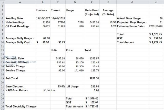

Phil23
Joined: 27/03/2016
Posts: 1667
Posted: 09:58pm 14 Jan 2018
  Gizmo said  This thread was a about the misleading information provided by Silicon Chip about going off grid, and most of us would agree the figures they used are way off the mark.[/quote]
Perfect opening for a feature article, maybe in an alternate publication....
Personally I find a lot of publications & the media in general need to stick to facts & avoid a colourful slant.
[Quote=Popular Science Recently]
"Set two Bowling Ball sized lumps of Coal a blaze...."
[/quote]
Not much fact in that statement; would rather know the breakdown of the original energy each kg contains.
My average usage here is sitting at 60kwh/day; next meter reading is due in 2 days time.
The bill that will arrive will be pretty painful after the latest rise & now looking at new ways of bringing it down, so good hard facts are great to absorb, while the colourful Left/Right slant serves only to confuse matters.
Phil.
Madness
Joined: 08/10/2011
Posts: 2498
Posted: 10:11pm 14 Jan 2018
Wow, there must be ways to improve that, at $1500 plus that would give me major bill shock!

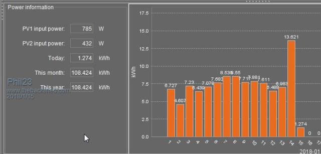

Phil23
Joined: 27/03/2016
Posts: 1667
Posted: 11:22pm 14 Jan 2018
Hoping so. Projected @ $1727.49 when it arrives, and I'm usually within a $$ or so.
Should add that I run a Home Business/Office here with 2 Xeon Servers on 24/7, 4 NAS's & the couple of PC's & 2 laptops that don't ever shut down; Add another 100W+ for security DVR & Cams etc.
2 8kW split systems, one a multi-head (3 rooms); Try to use them as economically as possible; including burning around 100W removing the 55°C air from the ceiling cavity.
Am in the process of trying to pull it back with a Hybrid in certain areas.
New learning curve for me; getting the best of what I have.
Phil.
