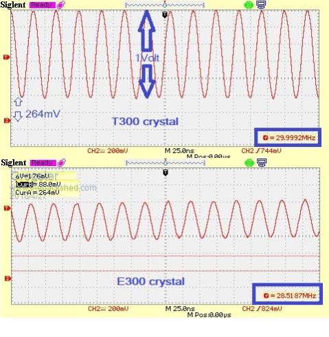

UPDATE:
Phil over at the PICAXE forums has received two of my clone modules, and has tested the crystals - they are stunningly bad......
An extract from an email that he sent me:
[Quote=Phil from PICAXE forums]28.5MHz and less than half the amplitude of the signal across the “T300” crystal![/Quote]
Please visit the PICAXE thread for an image he has posted comparing the genuine with the clone crystals.
I have asked him in an email if I can repost his image here, because you can't get the full-size image from the PICAXE forums, unless you are logged in, and many members here won't be members of the PICAXE forums. As soon as he says that is OK, I will re-post his image here.
EDIT: Permission granted from Phil to re-post his scope image, so here you are:
For a crystal that is supposed to be 30.000MHz, this is not good.... Edited by Grogster 2018-04-28

Just a little update for this thread:
[Quote=reginald on the PICAXE forums]I had three HC-12 30mhz crystal variant left whch did not communicate well(or at all) over distance with my T300 type. I obtained new crystals from farnell type
7M-30.000MEEQ-T - Crystal, 30 MHz, SMD, 3.2mm x 2.5mm, 10 ppm, 10 pF, 10 ppm, 7M Series stock No 2308724
Swapped these today and now all three boards are happy chatting away with no errors. One was a USB type plugin which failed and on opening up it had a HC-12 board piggy backed on the USB board which I had swapped with 30mhz type (before I new the difference) and wondered why it didin't work. Shows not all crystals are equal.[/Quote]
I have ordered some new crystals, but they are not here yet. I got mine from Element-14 here.
I am now very hopeful that I can revive some of my dead ones by recrystallizing them.

My replacement TXC-genuine crystals have arrived, and when I get a spare moment, I plan to replace the crystal on one module with the TXC one, and see if I can replicate the results from reg on the PICAXE forum thread.
I am quite hopeful that I will. (fingers crossed)
Posts: 10042
Posted: 12:38pm 08 May 2018
OK, after about half an hour, I have replaced one 30.000MHz crystal, with a genuine 30MHz one, and just like reg on the PICAXE forums, this module now works spot-on frequency as it should be.
Replacing the tiny crystal package was a pain in the arse. Reg made it sound so simple.... I will practise on another module tomorrow. I think part of the problem is my rework station has a very small nozzle on it - 2.5mm OD, and 1.8mm ID, which is pretty small, and I think it just is not heating up the crystal package evenly enough, cos even if you 'Draw circles' around the package, one side is cooler then the other, and starts to re-solidify and then the bloody thing won't shift.

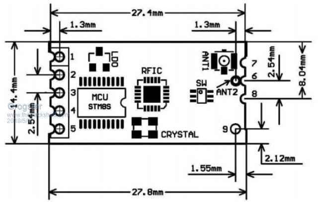

MicroBlocks
Joined: 12/05/2012
Location: Thailand
Posts: 2209
Posted: 02:44pm 09 May 2018
@Grogster,
Could you measure the HC-12 module. I am busy with the tibbit enclosure and i think it will fit nicely when i include a footprint for such a module.
I have ordered some but the sooner i get the dimensions the better.:)
ONLY when you have time of course!!
Posts: 10042
Posted: 11:20pm 09 May 2018
@ CaptainBoing - Now that's an idea! Hmmmmmm.........
@ MicroBlocks - Here you go:
I cropped this image from one of the listings on AliExpress.
