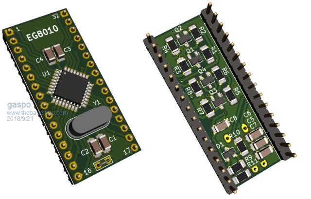

Wiseguy, added TL431 and a combo through hole/SMD crystal. I do not think there is more room for anything else. Attached are all necessary engineering files for manufacturing.

There is no need for cutting. PCB makers like JLCPCB let you panelise smaller boards onto the 100x100mm PCB with V-cuts between them. You just snap-off the boards from each other and file the edges a bit.
JLCPCB charge about $A30 for 10 100x100mm PCBs with 2-5 days DHL shipping. You can fit 10 adapter boards onto one PCB - so about $3 per 10.
I could order and post it if more people interested or you can pick it up if in Perth.
Gerbers with more GND vias.

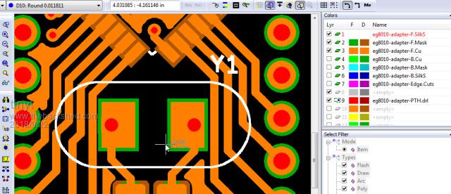

Nice work Gaspo. One comment if I may. Looking at the footprint for the crystal, it seems that the top copper pads are rectangular and a bit too large. They are also exposed.
If the crystal is packaged in metal, the bottom metal case of most of them extend too close to the pins. If the crystal is soldered with its bottom flush to the pcb surface, the case can short the pads together. Maybe make the top pads into small anular rings (as small as possible) or make the top solder mask cover the top pads up to the drill holes. No need to change the bottom pads. Just my suggestion.
Edited by tinyt 2018-09-23

  tinyt said   Nice work Gaspo. One comment if I may. Looking at the footprint for the crystal, it seems that the top copper pads are rectangular and a bit too large. They
The reason for the square top pads on the crystal is that both the SMD and the HC49 packages can be used. I have these SMD crystals that I want to use.
You can solder HC49 crystal so there's some gap between the board and the metal can or use some kind of spacer as Warpspeed suggested.
Now I understand. Another option is if using the SMD, solder it at the bottom or if using the HC49, solder it at the top.
If the top pad is unchanged, use spacer per Warp or temporary shim when soldering. Or if the top pad is changed per my suggestion, no need for extra part.

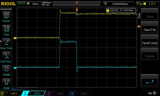

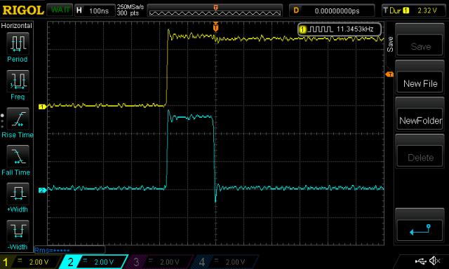

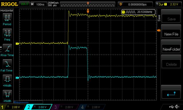

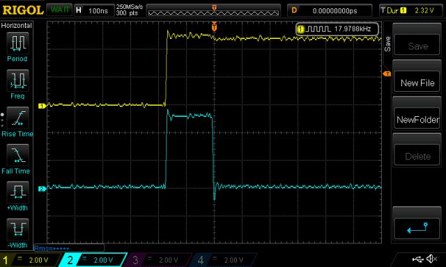

This is just a follow up for Tinyt:
I had a look at the problem with all 4 dead time settings.
Here are the 4 DSO captures of the same event, being resume after over temp.
in order they are:
500ns
300ns
1us
1.5us
I see no difference in any of these.

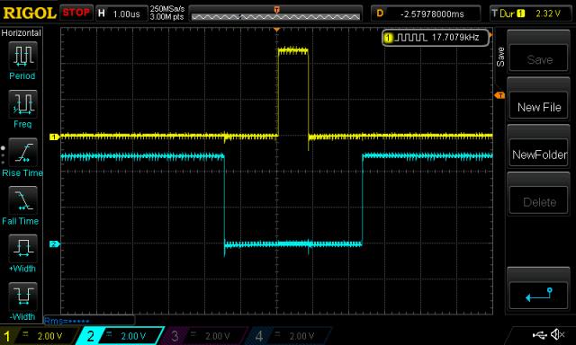

I confirm the dead time setting of the last one with this:
See the 1.5us dead time either side of the yellow pulse high.

Poida, would it be an idea to test it at the fet itself to see if that is getting to the fet with the different dead time settings?
