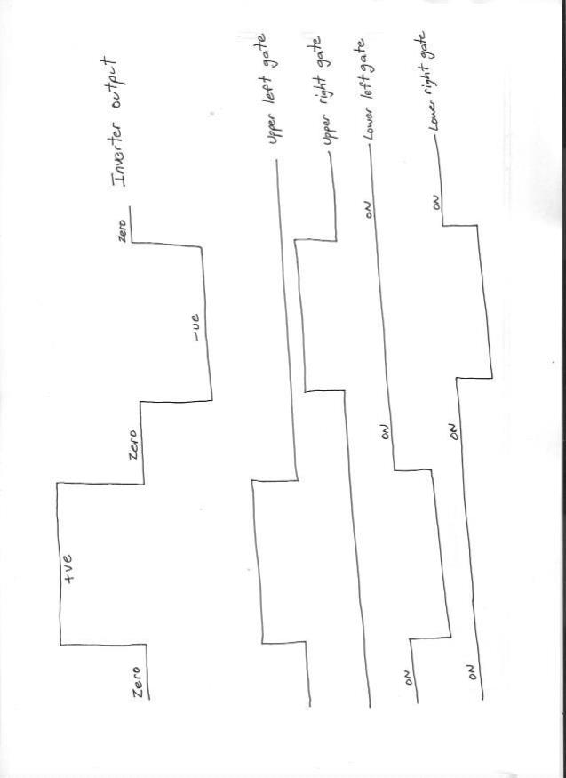

One other peculiarity about this type of inverter that needs to be known about and understood.
The transformer secondaries are all series connected, and the full inverter output current still flows through the transformers that are "off" or in the zero output voltage condition.
We cannot just open circuit the primary by turning off all four mosfets.
We absolutely must clamp the primary to zero volts by shorting it out, and we can do that very easily by turning on both lower mosfets simultaneously.
The drive waveforms to do this are really simple, and its a very important and easily overlooked feature of the control board design.
The upper mosfets "U" are driven directly from data coming from the EEPROM.
Lower mosfets "L" use the exact same waveform but inverted by HC04 inverters.
Dead time is added at the half bridge boards.
Klaus, flux density calculation is different for sine and square waves. Sine waves are measured in rms (.7071 x peak) but the flux in the core sees the average value (0.637 x peak) and there is an 11% difference.
Faraday's law uses 4.44fnab for sine waves, and 4fnab for square waves.
If you use the usual sine wave transformer equations and design all four transformers for 50Hz sine waves it will work fine, and give 11% extra margin on actual flux density.
For our hypothetical 40v to 225v square wave transformer, just plug in 40v rms and 225v rms into the transformer design spread sheet, the turns ratio will be correct, and the flux will be o/k too.

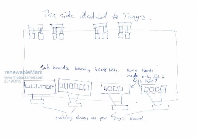

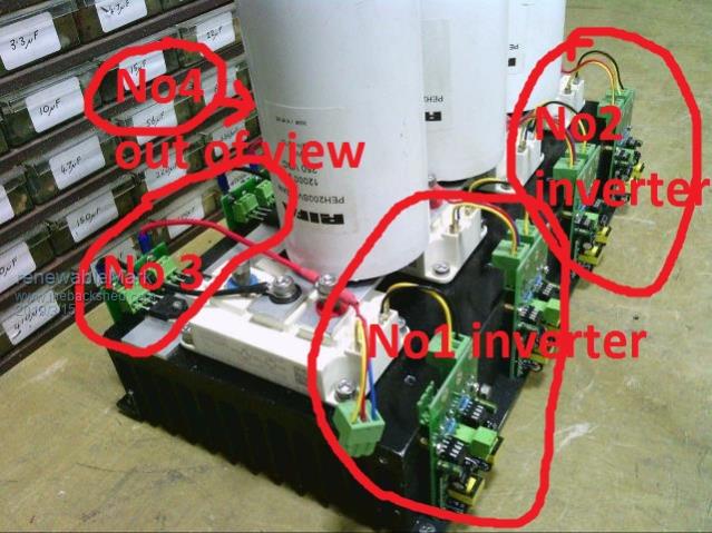

Tony I'm not too bright so it took a little looking at to work it out.
So basically you use two IGBT's instead of multiple fets to drive the big 2 inverters.
The smaller two are the ones on the back connected to the shiny al strip using mosfets instead of igbt's.
Are these IGBT's ok
Re transformers, can you use toroid cores that are too big for the smaller ones, does it matter if they are oversize?
It's just the turns that counts isn't it?

Yes those IGBTs are pretty much identical to what I am using, and the price is about right for Chinese clones, which is what I have.
Only really required for the largest inverter, but I used another pair for the second inverter because I already had them, and it makes a simpler neater physical layout.
These are far more suitable for a 100v inverter than a 48v inverter for two reasons.
Your current will be twice my current at the same power level. Probably not a problem, but its going to have less maximum overload capacity at 48v than at 100v.
IGBTs also drop about two volts each at very high current. That is about 4% conduction loss at 100v but 8% conduction loss at 48v so they are going to develop about twice as much heat and power loss at 48v than at 100v when worked hard.
Its certainly workable. It will be slightly less efficient at medium and very high power than mosfets, but infinitely more robust and capable of huge power surges such as motor starts.
The two smaller inverters just use individual mosfets, a pair in each half bridge.
In my case 600v 50 amp devices, but you would be better off with HY4008's.
The transformers only need to be big enough to handle max power. No problem with over sizing the smaller ones. Toroids will be fine, they are just more difficult to wind.
I am slowing down in my old age, and let my mate wind my transformers for me.
He is no spring chicken either, but he winds transformers for his day job and has all the right gear. For him its just one more job to do with all the other customer orders.

Thanks Tony,
are you happy to share your layout design?
If so those wanting a 48v version could use most of your design, but incorporate sub boards to mount the 4008's for the two bigger inverters, same boards for simplicity but maybe fit fewer fets to the second one.
Perhaps in the centre another cap board that could house multiple caps, perhaps two rows could fit?
I have a double stacked 6kw core wound for the Oz/Mad unit, so needs a new primary.
And have a few 2kw cores that could easily be wound (that doesn't worry me)
So looking at it, if you are happy to share your design, this shouldn't actually be too big of a job at all.Edited by renewableMark 2019-03-16
Cheers Caveman Mark

Posted: 01:42am 15 Mar 2019
Sure, the whole idea is to share ideas.
Many different ways to lay the thing out.
You could even dedicate one large heatsink just for the large inverter, and build the other three inverters onto a second heatsink.
Using individual HY4008's will be more electrically efficient at 48v, and a lot cheaper too. I used parts I already had here, so my layout was appropriate. But it would be an expensive thing to do again if I had to go out and buy all the parts.
Individual mosfets are going to be a lot more fiddly, and all those mosfets are going to take up a lot more heat sink space than IGBT power blocks.
Physical layout will be far less critical switching at 50Hz rather than at 23Khz.
Just put plenty of thought into the track widths and the huge currents those tracks need to carry.
Andrews solution to all this is particularly clever, and well worth studying.

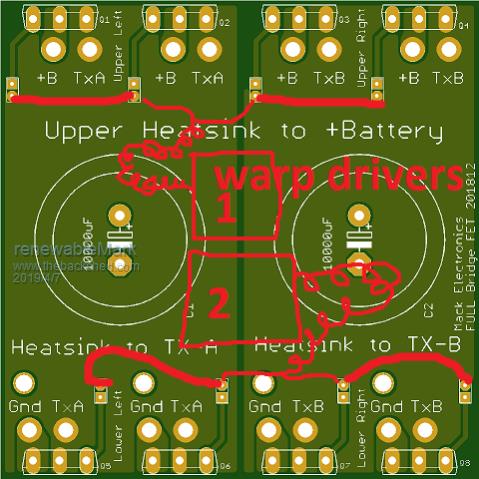

I'm trying to work out how to use the existing designs to make a fet driven Warp machine.
Mack's construction confuses the hell out of me, but I can get my head around your one Tony.
So is it possible to use the std Warp control board and the 8 warp driver boards, but send the signals to the Mack fet board, so each twisted pair would then be separated and sent to each 1/4 like this.
Cheers Caveman Mark
Off grid eastern Melb
Posted: 11:37pm 06 Apr 2019
Andrews FET board is a mechanical assembly to tie all the larger parts together physically.
It requires a piggy back board with the little 15v supplies, and the opto isolators, in addition to the picture above.
The easiest way to get started is with eight of my small half bridge boards with a pair of HY4008's fitted onto each. Bolt all the mosfets onto just a large plain sheet of 3mm aluminium with insulating hadware. The mosfet legs will be strong enough to support the small circuit boards.
That will give you a 100% working inverter, but power limited by only having four mosfets in the largest inverter.
Andrew is working on a microprocessor board that will plug in directly instead of my control board. Directly swappable, same plugs, same pin connections.
Next step would be to get really serious with a proper heatsink, large electrolytics and a whole bunch of HY4008s.
But meanwhile, you can have some fun and prove that the whole thing works.

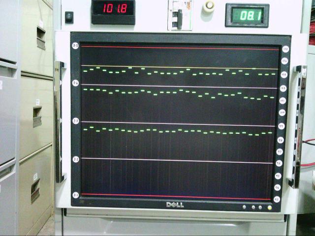

Posted: 02:48pm 22 Apr 2019
Shane,
During the day, even on very cloudy days, the inverter draws power direct from the solar panels. The voltage at the inverter input being well above the battery voltage.
This allows the battery to have a long slow continuous charge for about seven hours at mid winter, and seventeen hours at mid summer.
My battery is quite small, only 50Ah, so the bulk charging current is set fairly low at 10 amps.
It charges at 10amps constant current (if available) up to 3.4 volts per cell, then the charging current tapers down above 3.4v to zero at 3.45v.
Charging is controlled by a battery monitoring system which monitors and displays the voltage of each cell on a 17 inch flat screen video monitor.
Its the highest voltage cell that always takes control of charging.
As soon as the highest voltage cell reaches 3.45v charging terminates for the day.
The cell voltage display has a peak hold, so I can see the highest and lowest voltages each cell has ever reached.
At night the solar panel voltage falls to zero, and this resets the charger so the charging process can begin again the next day.
My cells receive one long continuous charge that then terminates, and then one long discharge at night.
From what I have read, that is the best way to get longest battery life, as few as possible charge and discharge cycles.
I also have individual cell balancing resistive loads at each cell, only 27 ohms (about 130mA). The loads are at each cell, but the on/off control for these balancing resistors is controlled by central software that uses the same voltmeter for monitoring every cell. That makes it very easy to keep all the cell to cell voltages within a very few mV at the end of charging, where the cells normally can tend to go a bit wild.
The whole thing has been a long slow process of steady development and improvement, and at this stage I am very happy how the whole battery management system is performing.
