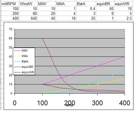

I'm not sure the resonant theory is correct. If it is, there's still another practical problem, determining/measuring inductance of the generator. From Flux's explanations (long time ago, can't refind the thread) I recall that it's not as simple as hooking up an inductance meter and reading the value. Apparently the rotor comes into play too, and the 'real' inductance is also dependent on the speed of the rotor, IIRC. I don't know how one could easily measure or determine the correct inductance. If anyone knows how to, please explain.
As stated, I'm not sure the resonant theory is correct. Recalling Oztules' recent experiments, where he used an axial flux in a heating experiment, I think it's interesting to have a look at the load characteristics of battery charging (standard), battery charging with capacitors in series, and heating:
In Oz's heating experiment, voltage goes up as RPM and windspeed go up; the voltage isn't clamped by the battery: as RPM rises, voltage rises; the curve is a rising line. Recall that Oz mentions a relatively large power, larger than when battery charging. Obviously the load, generator and wind are better matched somehow.
In a plain battery charging application however, voltage is clamped by the battery. As RPM goes up, voltage stays the same. The curve is basically a horizontal line.
In a battery charging application with series capacitors, we see the effect that at low RPMs the caps present a relatively large impedance, thus reducing available voltage (and current) for charging. As RPMs rise the impedance decreases. The new (combined) voltage curve of the batteryload and capacitors is again rising, due to the lowering of the capacitors' impedance as RPM rises. At higher RPMs the capacitors basically disappear and the flat, horizontal curve of the battery is dominant.
Keeping Oztules' recent experiments with water heating in mind, the similarity of the curves in both situations (heating and batterycharging with caps) may explain the higher observed powers.
At least, that is my guess. As in Zubbly's experiments, the extra impedance of the capacitors disappears as RPM (and thus AC frequency) increases. It's my suspicion that it is this that causes a better matching of the (battery)load to the windturbine and/or wind. (devious thought: I wonder; does wind have an impedance, as for example space does to RF?)
The above may or may not be the same thing as matching with caps to achieve resonance; one would have to fill in the figures and do some math; it may very well be that both explanations explain the very same observed phenomenon in two different ways.
Or does anyone know how to determine whether it's a matching issue or a case of powerfactor correction (PFC) of the inductive component ? If it's a matching improvement, replacing the caps by resistors (of the correct value at the specific RPM/frequency/windspeed) should have the same effect on power output. If it's a powerfactor correction thing (to correct for inductive impedances), series resistors would not yield the same results as series capacitors. Edited by Dinges 2008-09-26

Dinges, the blades already overpowered the mill, so resistance won't help. Inductive reactance killed it off at 11 or 12 amps... so this is the culprit.
I have a lot of time for Gills explanation, and it fits the facts pretty darn well. It is the only decent reason I can see for getting the amps up. I entertained some wild ideas about how the caps could increase the current some other way, but they didn't hold up.
In the end it was the effective lowering of the resistance (by lowering the ac impedance ) of the coils that was the key.... then the dc wire resistance ceased to be the limiting factor.
I think the other thing with the MPPT argument, is that you can never recover the cubic function of the wind with any gadgetry..... because the alternator only goes up with the square of the blade speed. The blades only go up linearly with the air speed, but the wind is doing it's own thing as a cube of the wind speed.... so I think squared is as good as it gets.
If you can hold the R losses by resonance at the point where your max power is, I think it will be as good as it gets.
If you look at Gills graph, it is a X sq looking curve with frequency.... which is exactly what we want to match the alternators X sq output.
If the caps are chosen well, I suspect no amount of gagetry will beat this arrangement for MPPT..... the alternator is just not capable of X cube performance. (W=Esq/R)......
Now this extra magnitude that we can't track with the alternator, may show up partially.
If we assume that the blades will speed up a little as they are not being loaded correctly as the practical wind rises, we may get a bit more voltage than we would have... ie the rpm increases over linear as we increase wind speed, but by how much, and do we use that advantage already... I'm sure we do as the alternator will take up the extra rpm .....until the blades finally win the tussle and finally overpowers the alternator.
This may skew the calculated cap value for wind speed..... but not rpm.
All in all I think we are slowly getting to the bottom of this.

  oztules said   Dinges, the blades already overpowered the mill, so resistance won't help. Inductive reactance killed it off at 11 or 12 amps... so this is the culprit.
Ah ok, missed that. Yes, that seems to basically rule out the capacitors acting as 'powerless resistors' to match the genny to the load.
Now with the series-LC circuit analogy all kind of other thoughts prop up... Like Q-factor. What would the Q of a F&P be ? If it's high, would it be beneficial to lower it (with a series damping resistor) so the resonance peak becomes broader and thus bandwidth increases?
Or maybe 'stagger tuning', as used in IF filters ? Have one phase tuned to a certain frequency, phase two to a slightly different one, and phase 3 to yet another frequency. This would broaden the curve (but also lead to imbalance between the phases).
Or even continuous tuning, by switching in or out capacitors (via relays? SSR?) to make sure that there's always the right amount of capacitance to achieve resonance at any frequency (RPM) ?
Plenty of (silly) ideas come to mind...
If anyone knows how to determine the inductance of a generator, I'd be very interested. I once measured the inductance of the 10 hp conversion stock winding with the LC meter (11.7 mH per phase), but was later corrected by Flux that this wasn't the 'true' inductance, as it didn't take into account the effect of the (rotating) rotor.
For the series-LC technique to work one would need to have an idea of the generator inductance with which to calculate required C at a desired F (=RPM), so the inductance measurement issue becomes real. Or one would have to resort to trial and error.Edited by Dinges 2008-09-26

Certainly, I'll concede there may well be influences that cause a variance to the resonance equation in theory and practical terms, though it is the basis of my rational. Observation and experimentation will reveal this if our knowledge of theory cannot.
oztuls,
I disagree with this
  Quote  I think the other thing with the MPPT argument, is that you can never recover the cubic function of the wind with any gadgetry..... because the alternator only goes up with the square of the blade speed. The blades only go up linearly with the air speed, but the wind is doing it's own thing as a cube of the wind speed.... so I think squared is as good as it gets.
though here is not the place for that debate.
I do agree here
  Quote  If the caps are chosen well, I suspect no amount of gadgetry will beat this arrangement for MPPT.....
at least for the stage 1 of my MPPT proposal and provided blades are correctly chosen, though I don't see it negating the need for stage 2. Again that's not the main thrust of this topic either so I must let that go for another time too.
I have tried to get measured values for the inductance in the stator but both my analysers suit frequencies from 500kHz, 1.8mHz and above. I never do well at measuring impedances.
Cheers Gill _Cairns, FNQ

I have just gone through some of the relationships that an ideal windmill has to have.
I have taken 3 points only in the wind energy spectrum
An initial say 10W at the shaft, 80W, and 640W. This corresponds to a doubling and doubling of an initial windspeed giving a starting wind energy of 30W for the particular rotor. Ideally the TSR should be constant with increasing windspeed.
assume the 10W gives 100rpm and we have a nom 24V battery. [A battery presents a very low impedance]
this is a sort of table for the power relationships at the various wind energies.
I have tabled approx wind energy to mill rpm and mill voltage and calculated current and then battery current.
WindW = wind power at shaft
millrpm
millV = loaded mill voltage
millA = loaded mill amps
BatA = battery amperage
equivBR = equivalent resistance at battery voltage to dissipate power
equivWR = equivalent resistance at windmill voltage to dissipate power.
The battery and windmill are not anywhere near the impedance that is required.
A series capacitor creates this type of matching, as at low frequency/rpm it is a high resistance and as the frequency increases the impedance drops.
I do suspect that the series caps cannot boost the voltage, so a separate boost method is required, but above the battery voltage the caps perform the required function.
I need to follow up with some more testing of currents.
Gordon.

GWatPE
Joined: 01/09/2006
Posts: 2127
Posted: 08:58am 26 Sep 2008
I fixed the table above and provided a graph of what needs to be done by any impedance matching system.
My maximiser performs this task electronically. The series caps seem to do a good job without the complexity.
