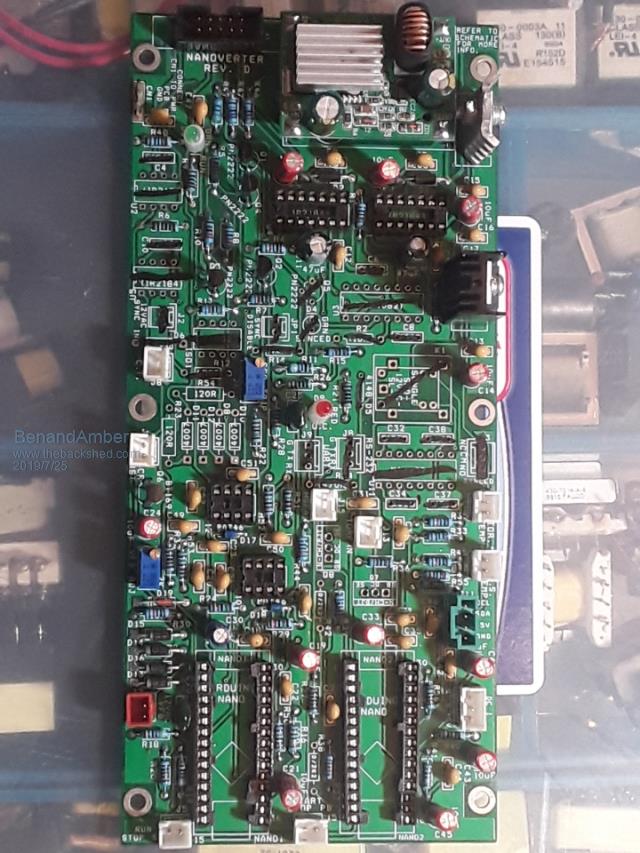

I am pretty much finished with both boards besides programming and figuring out what N Channel BJT to use
I'm sure that information is somewhere
I just haven't had the chance to try to find it yet
I have been very busy lately not much time for electronics
if anybody sees anything else I've missed please let me know
Edited by BenandAmber 2019-07-14

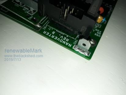

renewableMark
Joined: 09/12/2017
Posts: 1679
Posted: 10:23pm 12 Jul 2019
You need the spade connector for ground CN1
It's near the corner where the ribbon cable is.
That connects to ground on the power board.
Like this
Yours is in a slightly different spot, this is the old board.
Edited by renewableMark 2019-07-14
Cheers Caveman Mark
Off grid eastern Melb

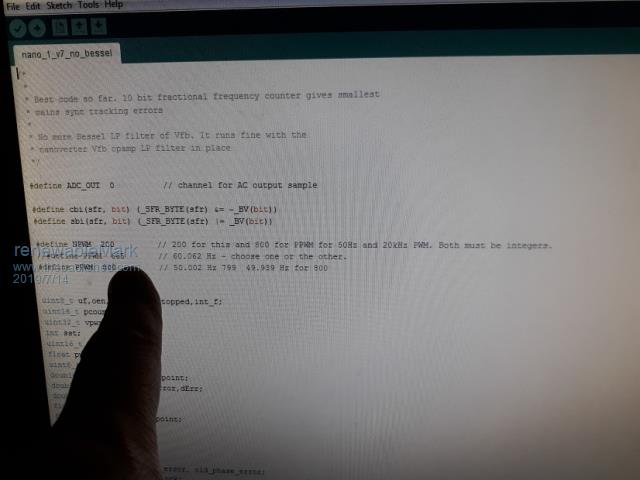

renewableMark
Joined: 09/12/2017
Posts: 1679
Posted: 12:22pm 14 Jul 2019
If you open up the arduino programme, it will tell you what to do.
Default is 50hzEdited by renewableMark 2019-07-15
Cheers Caveman Mark
mason
Joined: 07/11/2015
Posts: 86
Posted: 12:52pm 14 Jul 2019
Thanks Mark,
I'm not at that stage yet but just wanted to clear that up..

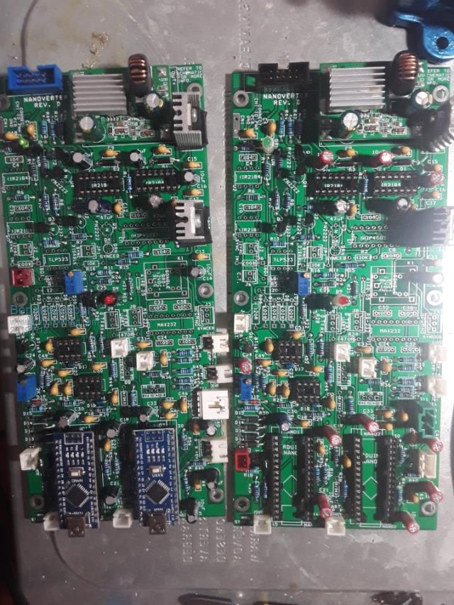

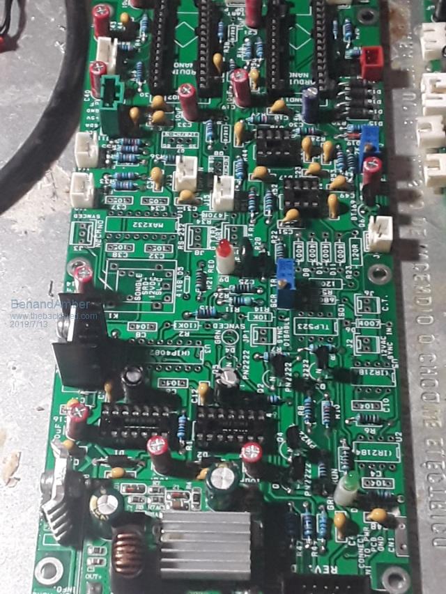

the very last component came in for my Nanos
and they are all done as far as I know
unless I missed something only thing they need is programming

Ben, you haven't fitted a lot of the parts, are you going by the picture Poida posted here on P2?
If so you are still missing some bits.

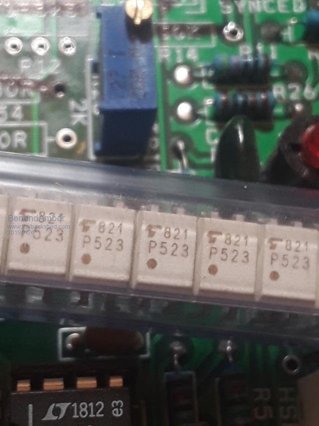

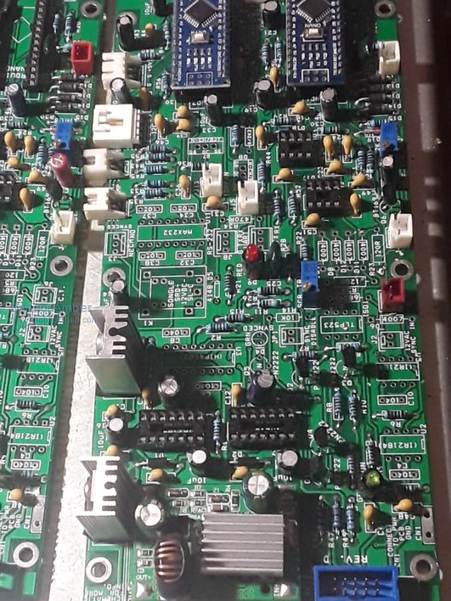

BenandAmber
Joined: 16/02/2019
Posts: 961
Posted: 01:44am 25 Jul 2019
The parts that are not installed with the exceptions of the ones that are blacked out
are the 4 0 0 7 diodes the 120 R half watt resistor and the two mosfets for the fans
I'm pretty sure I have the mosfets just have to dig
I do not have the 120R half watt could two quarter watt resistors be used
I saw and another picture where the 4007 diodes were not installed
Are they required
I will not be main sinking
I would like to have a way to turn on a DC gas powered battery charger automatically if that's something this board can do
Thank you guys for your help there is absolutely no way possible I could do it without it
I Honestly think that if you guys on here put your heads together
you could do absolutely anything that is possible to do
So impressed with the wisdom and intelligence on this formEdited by BenandAmber 2019-07-26

I ended up ordering a bunch of these if anyone needs them might be faster than slow boat

Posted: 10:55pm 02 Aug 2019
Sorry Ben, I missed your question there,
you either use R3 OR R54, but don't fit both.
Myself and Poida used R23 and left R54 empty.
The 4 by 4007 diodes next to R54 need to be fitted for the SCR to work.
Cheers Caveman Mark
