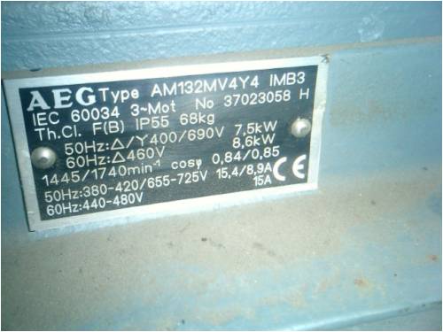

Ok, let's look at it from another point of view using figures taken from the real world. Here is the nameplate data of the 10hp motor, when it was still a motor:
Let's assume a 50Hz system. We get the following figures for that:
in star : U=690V; I=8.9A ; P=7.5kW
in delta: U=400V; I=15.4A; P=7.5kW
From the above, we can deduce that (for one single, disconnected phase, i.e. neither star nor delta) phase voltage = 400V and phase current = 8.9A; then phase 'resistance' (yes, I know, should really be impedance...) becomes 400/8.9= 45 ohm; we will use that phase resistance (45ohm) to verify the next calculations:
We can now calculate the 'source impedance' (rather: sink impedance, in the case of a motor):
in star : R=U/I= 690/8.9 = 77.5 ohm (verification: 45*1.73=77.9ohm)
in delta: R=U/I= 400/15.4 = 26 ohm (verification: 45/1.73=25.9ohm)
The ratio between these two impedances is nearly perfectly 3: 77.5/26=2.97
(note that in the above I assumed that impedance is purely resistive, which of course it isn't; the resistance of one single phase was 1.85ohm for this motor... the rest ( sqrt(77^2-(1.85*1.73)^2) ) is inductive reactance.) But still, I hope you see the main point, how it varies with delta vs. star:
in star, voltage goes up by 1.73 times; in delta, current goes up by 1.73 times; assuming constant power (i.e. comparing apples with apples), this means the difference in source impedance is a factor 3.
[quote=Oztules]I'm not sure you are correct with your star resistance being 1.73xR.[/quote]
Note that I meant with R the -phase resistance-, i.e. the resistance of one single phase. In star the -source resistance/impedance- of the 3 phases together would be 1.73 * R; in delta, it would become R/1.73. The ratio is 1.73/(1/1.73) = 1.73^2=3.
I believe the thing to be conclusively proven by just looking at the nameplate data of any old 3-phase motor... ?
At least, that's how I understand it. But I don't claim to be an expert in 3-phase power calculations. On the contrary. If I'm wrong, please correct me.
Peter.

No... not misunderstanding, just not agreeing.
Delta has 1.5 times the current of a single phase... yes sticking by my post above.
The name plate only suggests that they can multiply and divide properly. If we jack up the voltage x 1.7 to go from delta to star (and we both agree that star is 1.73 x delta) we have to divide the current by the same amount, multiply them out...to get the same power rating... no more cunning and no less..... or maybe just maybe they agree with me too.
If you look at my example above, the current for star is I=E/R... = 1.73/2 = .865Amps in delta its 1/.667=1.499A
The ratio just happens to be 1.499/.865= 1.73 Funny how using the .667R and the 2R figures get the right result.. for the right reasons.
Delta gets only 1.5 times the current of a single phase group... not 1.7... just cant do it. It is coil group 1 plus an equivalent current through twice the resistance of the other two phases... so half the current....= 1.5 times a single coil group
Star current must run through twice the resistance (cu loss), and that can't be waved away through anything short of resonance... and we don't have that at low frequencies, but the relationship remains the same regardless of frequency. The vector addition is for voltage... which turns out to be 1.73 times a single coil. The current has to wade through two coil groups resistance. It can't avoid this.... so 1/2 the current.
