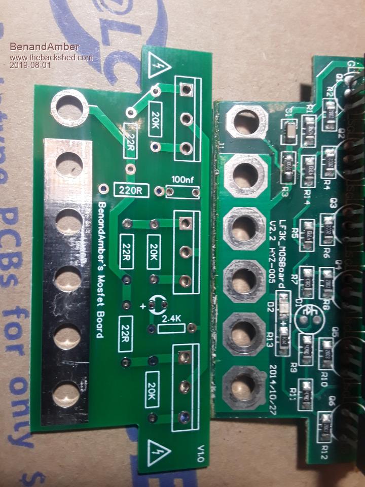

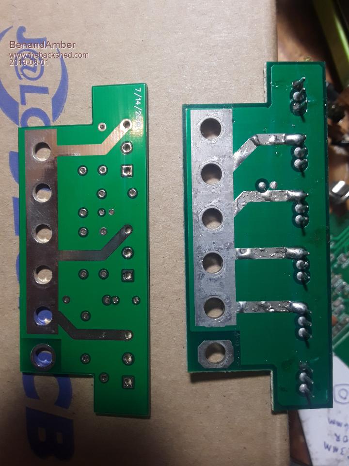

My little mosfet boards came in
Kentfield dude design them for me
Does everything look good as far as the component values to you guys
The mosfets will be Hy 4008
I think Kent done a awesome job
Thank you Kentfielddude

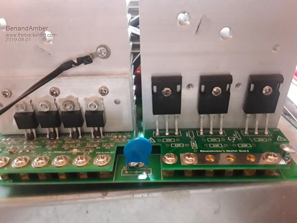

BenandAmber
Joined: 16/02/2019
Posts: 961
Posted: 06:38am 01 Aug 2019
The existing holes in heat sinks can be used or if you want your legs to be shorter you can drill new holes

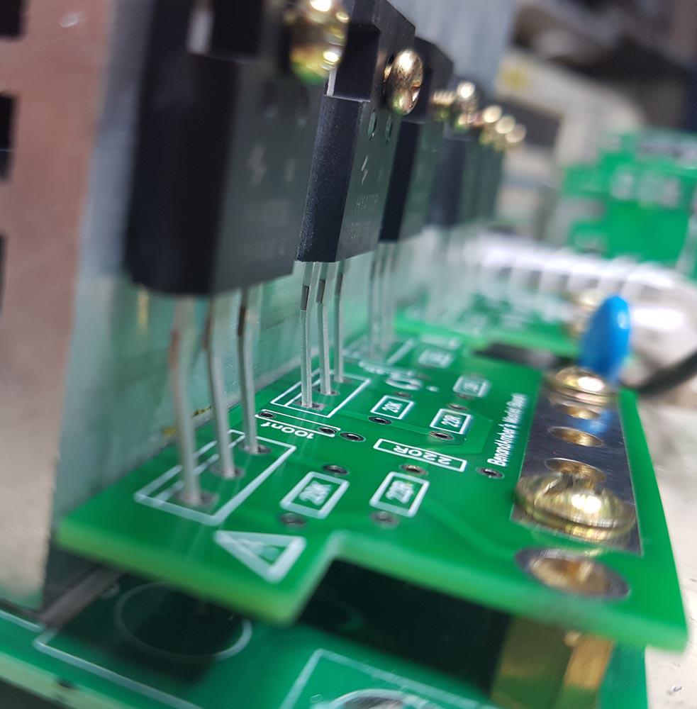

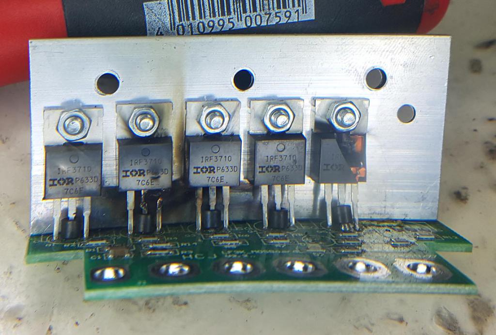

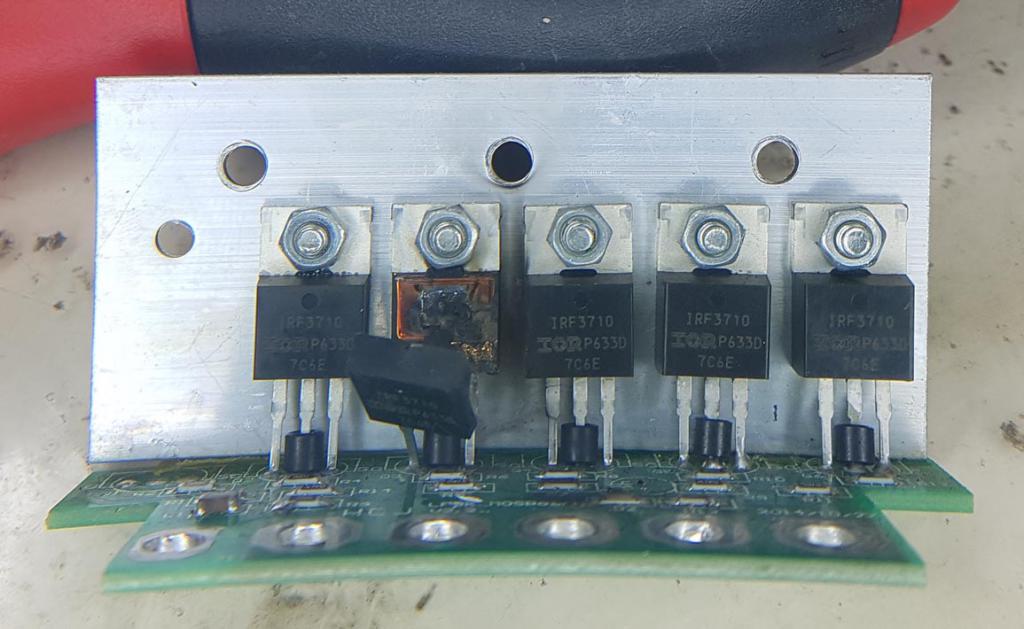

Today I was a bit careless when I tested the Powerjack inverter.
I have added a remote on/off control cable and I had a bit of a whoopsie.
The remote cable plug was able to touch one of the primary winding connectors
while running.
And so, it comes time to replace the 4 MOS boards with those Ben&Amber sent me.
I will show here how it all goes....
But first I need to buy a few metal film resistors tomorrow.
the damage:

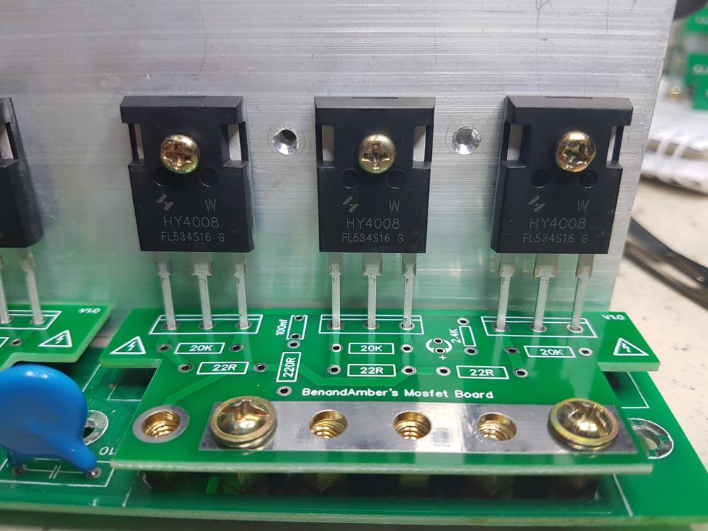

how the HY4008 TO-247 package fits with Kent's PCBs
using the existing tapped M3 holes - perfectly.
and the leads need a little bend:

I have built all 4 boards and placed one HY4008 in each.
No need to blow 4 or 8 at a time.
I powered the power board alone using the nanoverter since the 10 pin connector is
compatible.
It ran OK but with a high idle current. This is normal.
See here where I looked at the powerjack power board driven by the nanoverter before this blowup
Once I installed the powerjack control board on top of the power board and then
inside the inverter, it all seemed OK.
It did not run. The LF-driver board LED is not lit up so probably some issue there.
I tested the MY and NY SOT devices and one seems to be shorted.
Ebay has one of these for sale, about $45 plus $88 postage. This is a ripoff.
I ask people here:
what devices are the MY and NY marked SOT smd devices?
My first search hinted at "triode" FETs. What kind of beasts are they?
Oztules, have you repaired these things and if so what did you use when the totem pole drive transistors need replacing?

Posted: 12:20pm 11 Sep 2019
2sc2873, complementary pnp 2sa1213 .. and i have used them to replace damaged original and worked fine...

Posted: 09:17am 18 Sep 2019
I replaced the 4 transistors with similar speed 50V 2A devices.
No LED on the driver board and no pwm signal coming out to the MOSFET gates.
The lf-controller board beeps after a little while.
I think I will write this one off for now.
I need to spend the time on things that I have the schematic and can replace
the parts - home brew inverters.
