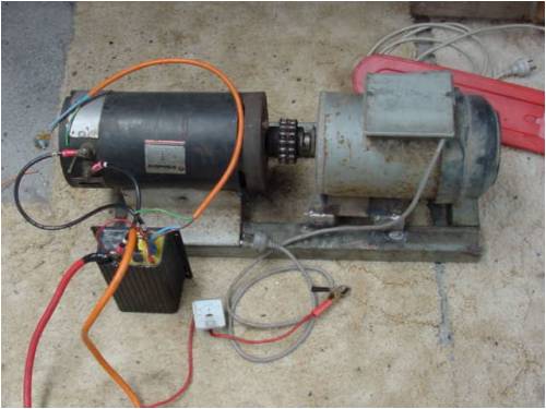

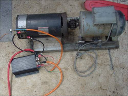

Karl, a quick version goes like this.
I used a 4pole 1 phase induction motor in my latest grid driver. It is about 1500w, just previously, I used a 4pole 7kw induction motor... anyway it does not matter which, but the 3 ph is smoother and has better results, but the system is the same... dead simple.
We'll use the single phase one for this.
I direct coupled a motor to a 4kw 36vDC brush motor. I ran the induction motor connected to the grid, to check it's direction, and wire the DC motor for the same rotation.
I then removed the run capacitor from the motor. This is to stop self excitation should the grid drop out.... islanding I believe it's called. (and it drops out all the time over here so was relevant).
Next I hooked up a 275 amp dc motor drive to the battery bank.
Started the DC motor to drive the induction motor. when I guessed it was around just under 1500 rpm, turn on grid to the induction motor. It pulls the dc motor up to grid HZ-slip.... approx 1440rpm.
I then slowly increase the rpm on the dc motor with the motor controller, and the sound of the hum changes, and the DC motor starts to dig in. We are now driving the asynchronous motor, and the grid is magnetising it at grid frequency. The rotor is now over 1500rpm (synchronous frequency) and drives EMF into the grid. We turn the DC motor up further, and watch the meter run the household power, and run the meter backwards. We drive a bit harder, and it spins backwards quite quickly, as well as driving the house.
If the power grid fails, the output stops immediatly, as the magnetising current disappears, and the emf stops, the DC motor is now unloaded, and just spins the ac motor for no effect.... islanding.
This is exactly how the grid tied windmills work (without the windy boy inverters)... just replace the DC motor with your favourite windmill with a approx 13:1 step up gearbox and 20 foot blades, and a bigger 3ph motor. (they use a soft start system to interface, but they are also pushing out lots more KWH than this experiment.
Hope that helps.

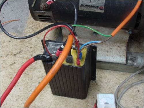

Dinges, here is the poor mans grid connect kit complete but for batteries:
Note the hot glue holding the front of the power controller. Thats after I fixed it up, couldn't think what else to weather proof it with.
The motor has NO capacitors in it at all. I run the dc motor up to about 1200 rpm, then turn on the ac motor. It pulls up to 1440, then wind the dc one up to however many amps of battery you wish to sacrifice... thats it.
Replace dc motor with motor gearbox and blades, add black box from breezy or brew your own... (so you don't have to sit there and turn it on and off), and your done.... oh and a tower... and brakes..
