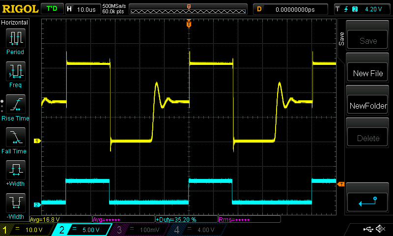

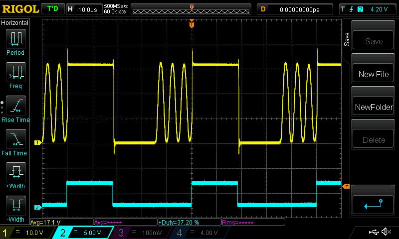

So I just tried the small ferrite bead on the drain of the switch.
Oscillations are back.
and with no bead
Hardly any difference with or without a bead on the drain.
So the bead stays on the source.
The input current, for the standard test case of 30V in and 15V/5A out
is for the three cases of bead on drain, no bead and bead on source:
2.63A, 2.64A, 2.65A with uncertainties of about +/- 0.03A
Efficiency for the bead on source situation is 93-94%

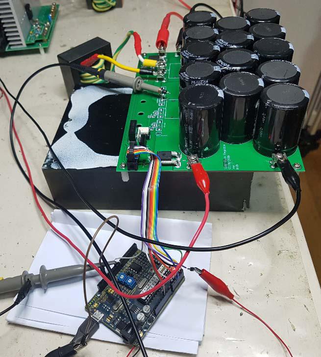

Lightning struck the lavatory (as my dad would say)
The boards have arrived.
Top quality as always.
I plan to build 2 boards, one for software development and various investigations
such as sensed input quality and noise levels, etc.
The other is to be used as a MPPT charge controller, taking over from the
45A Morningstar PWM.
And tomorrow I build the 50A DC load. Good grief...50A DC load..am I on drugs or what?

Thanks Mike and Mike and Volhout for the advice.
I built the first board today using 150V FDH055N15A MOSFETS
and HY5110 as diodes with gate tied to source.
2x each.
30V  2.71A in, 15.6V  5A out.
Efficiency is (15.6 x 5) / (30 x 2.71) = 95.9 %
Oh yeah.

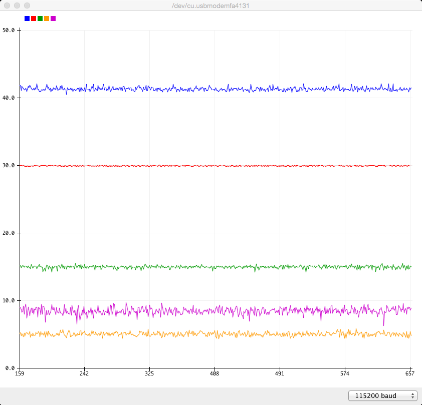

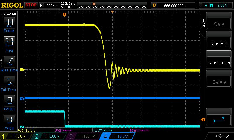

Nicks, EMI is big.
But your PCB layout is good I think.
here is a plot of
PWM% x 100, Vin, Vout, Iout, Iin
Blue: PWM
Red: Vin = Volts input
Green: Vout = Volts output
Purple: Iout = current output, uncalibrated, in ADC counts
Orange: Iin = current input, uncalibrated, in ADC counts
lots of noise.
The PWM is driven by the output voltage, which contains noise.
I think I will make a small board that has an Arduino Nano
on it and some low pass filtering within millimeters of the Nano ADC inputs.
Even 5 inches of wiring from the 10 wire ribbon from the the PCB picks up a lot of EMI.
It is hard to filter out high frequency EMI that is of a higher frequency than the sample rate. Always there will be aliasing of those high frequencies, unless we LP filter it prior to sampling.
The current sensors used with this board are not genuine parts, they are some I got from aliexpress for less money and I thought "are they any good?"
Well, they are about 1 ADC count = 0.66 Amps and there is a lot of noise from the buck converter.

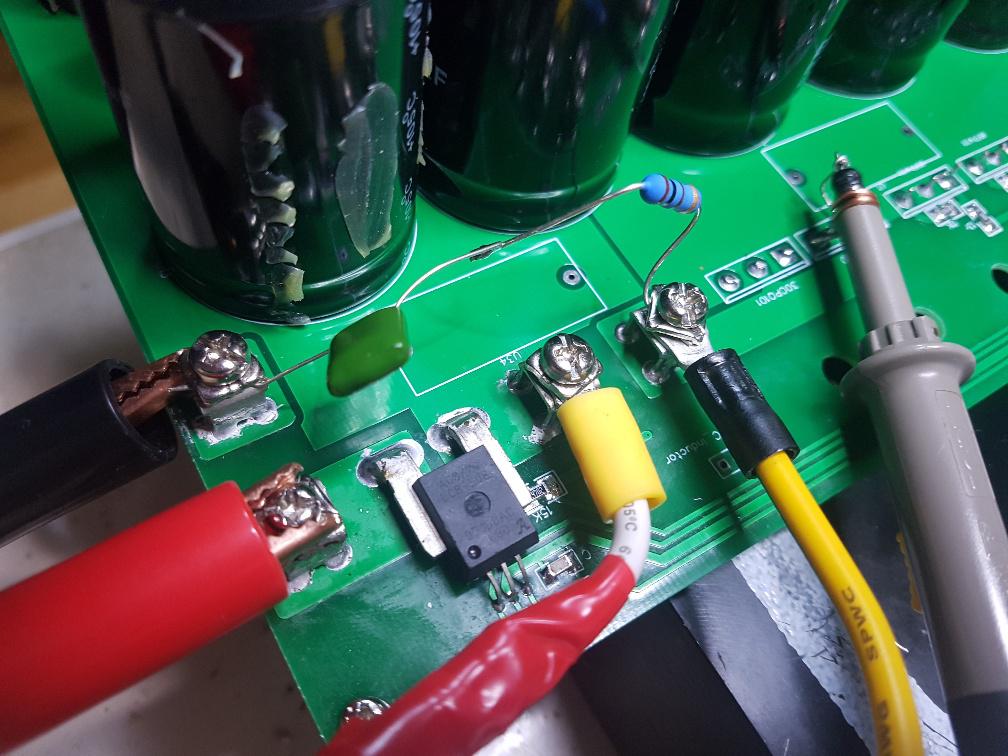

I think the PCB is nearly exactly correct. Maybe a few things can be done (silk screen showing resistor and cap values..)

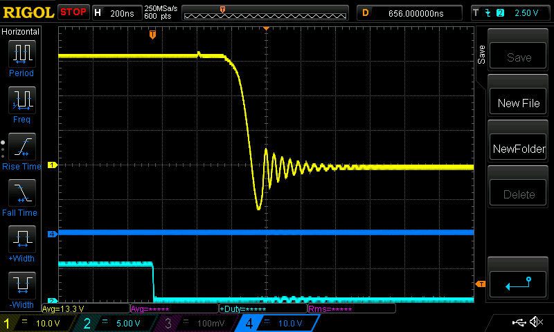

Some snubbing of the switch/inductor node will be good too.
I just placed a 104 cap and 100R in series with that node and ground.
before:
after:
I just guessed some values, of course better values will have even less oscillation.
That is, critically damped.
Probably tomorrow I try with 53V in and 25V out to see how things go.
(I think the HY5110 is a better and cheaper diode than the one you used in your system. But I am always happy to be proven incorrect... )
Edited 2020-04-18 21:32 by poida

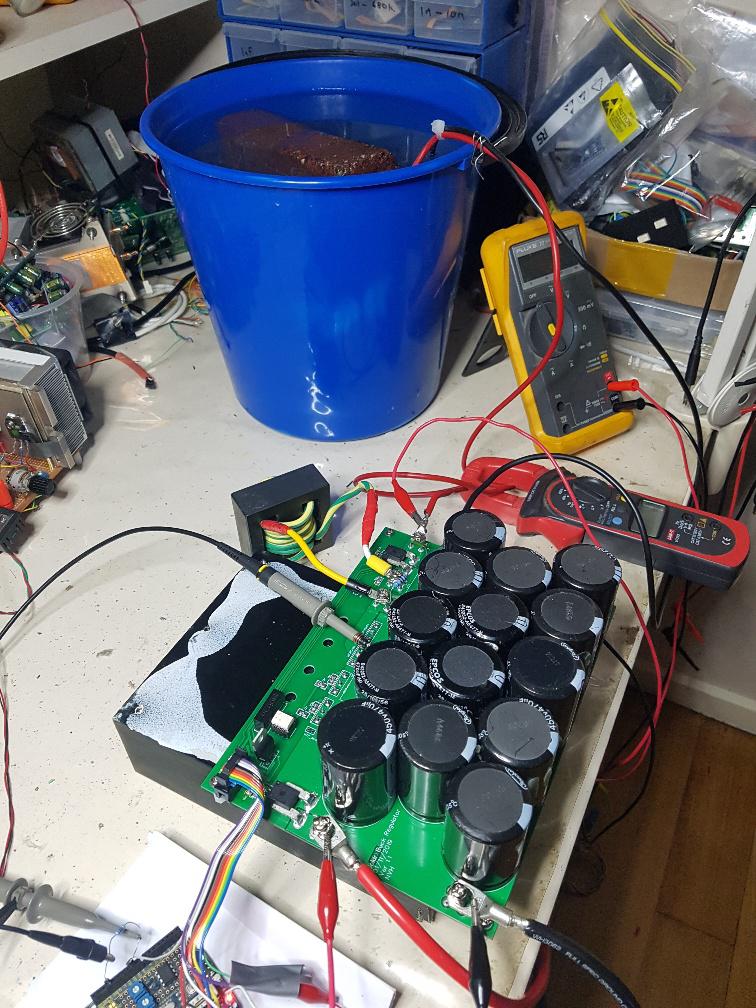

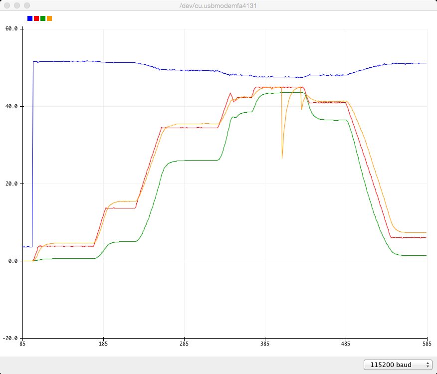

Now for a bit of pressure testing...
I have the board now connected to a spare 48V SLA battery via some 4mm2 cables
from 10 meters away. That is DC IN. There is a 20A AC contact breaker in series
with the supply and it appears it's about as useful as tits on a bull.
But it still functions as a switch.
The load is a few meters of the 0.75mm galvanised steel wire, wound around a small
concrete paving stone, all in a 10 litre bucket of (now quite warm!) water.
It's resistance is about 1 Ohm. That is one Amp per Volt.
The below graph is the Arduino Serial Plotter output for
Vin, Vout, Iin and Iout as Blue, Red, Green and Orange respectively.
Calibration for current is a bit dodgy, I can not seem to get acceptable accuracy
and offset nulling. The current sensors are about 0.7 Amps/ ADC count. That is
not sensitive enough for me.
No magic smoke was lost, even going to 40A or more.
Nominal Vin is about 51V, I vary Vout via a potentiometer.
There is something special about cranking up the output to 45V at 45A just from
a simple twiddle of the fingers. POWER!
You can see the Orange line hit the hard limit of 45A and the PWM is quickly
reduced, and then when reduced, it climbs back up again.
I have no idea why the Output voltage did not drop as well.
Nothing gets warm even during this test, except the water.
The only thing that has increased in temperature is the inductor winding
and that is only about 3 degrees more than ambient. The heatsink is still cold to touch.
(150V MOSFETs, 100V HY5110 as diodes. 2x each.)
This is going to fly I tells ya.
Edited 2020-04-19 17:46 by poida

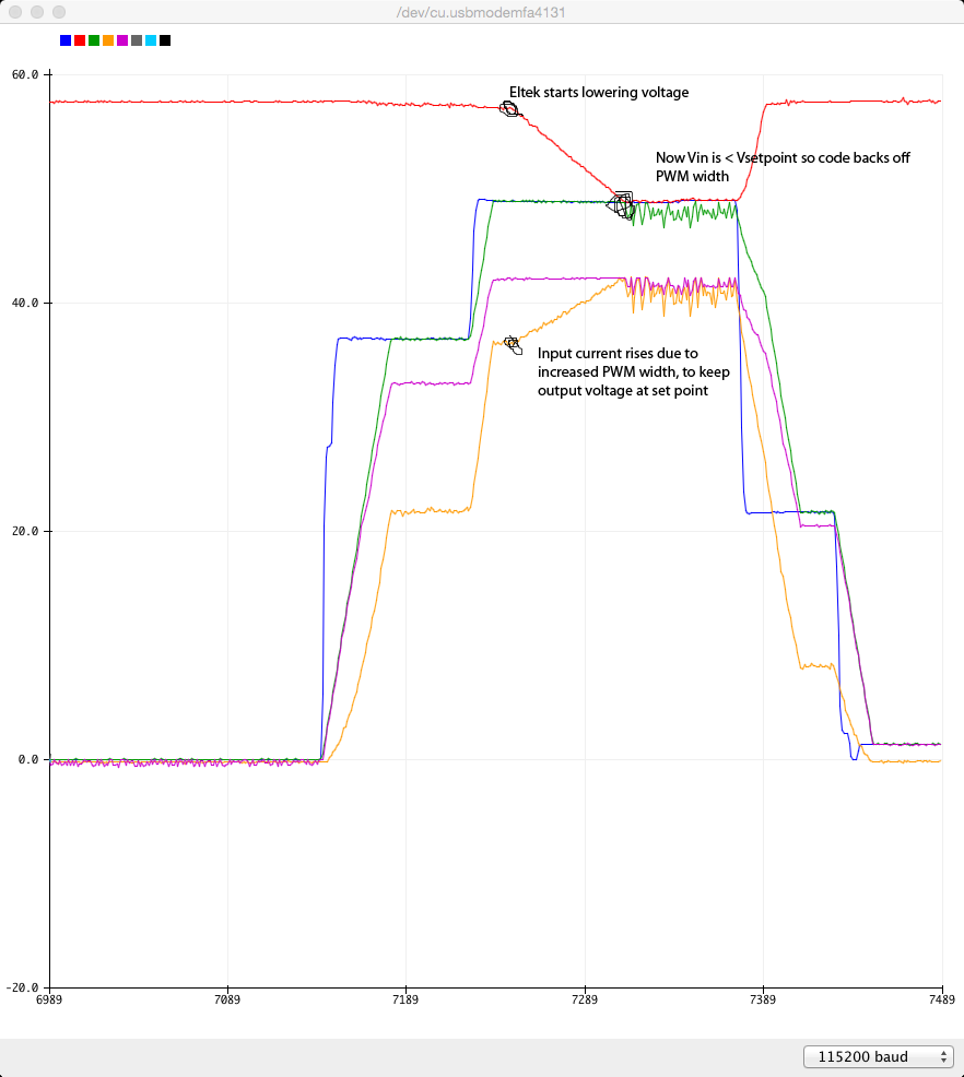

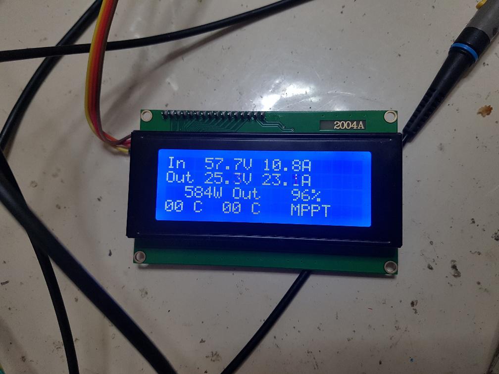

I've nearly boiled the bucket of water. It's steaming.
The only change is to use the Eltek 57V 2000W switchmode supply for DC IN.
Below shows V set point, Vin, Vout, Iin, Iout which is
Blue, Red, Green, Orange and Purple.
I run it up to 1/2 power, then go to about 2060W.
We can see the Eltek think "oh, more than 2000W, I will reduce voltage until things get acceptable"
Meanwhile the buck converter increases PWM width due to falling input voltage.
And then Vin becomes less than the set point voltage. My code then backs off PWM width
until Vin is > V set point.
Resulting from these tests today the heatsink gets about 5 C warmer, the inductor about the same. And I have some very disgusting smelling hot water in the bucket.
Also I have this:
The converter's vital signs. It's only as accurate as the current sensor resoulution etc so I use it as a guide. For proper measurements I use the 3 Fluke DMMs and DC current meter.
Edited 2020-04-20 15:37 by poida

Mark, it's not ready for Prime Time Viewing yet.
There are a couple of things I would want to change with the PCB.
But you are looking at a handfull of SMD resistors and caps from Alltronics, about $10
2 x good 150V MOSFETS and 2x current sensors and one DC-DC converter
from RS-Components, $38. You can find 14 x big capacitors from busted Areosharps or whatever, no need to fit 14 x 10,000uf in that case just fit 5 of those if you have them.
I used the 470uF 450V items that were used in large numbers on the Aerosharp boards since they came for free. Thanks mate.
The PCBs used 2 oz copper, the cost was about $100 for 5 boards, you could do it for less with slower delivery times.
One 47uH big current inductor, using the big ferrite cores from RS-Compnents that I like.
I am working on the design of the controller. It will be a small board with a 10 pin connector that goes to the main power board. It will work fine with or without the LCD. And it will need a 12V supply from battery to drive the small board as well as the DC-DC converter.
And a big heatsink, probably any offcut from something we would have built as an inverter. The MOSFETS and MOSFET/diodes do not get hot at all. Anything would do if it weighs about 1 kg.
Cost for me is $10(SMD bits) + $20 (PCB) + $38 for RS parts.
I had the inductor and heatsink as spares.
This is a 45A MPPT controller that will not need any cooling fan and will as a result run at high efficiency, for about $100. Victron offer one for $400. Yeah, but you can't repair it. Morningstar 45A MPPT is a lot more $$ and you can't repair it.
(don't beleive me? ask them for a circuit diagram..)
