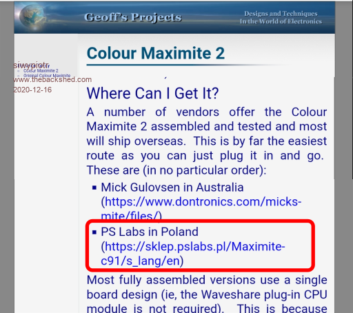

Posted: 05:38pm 15 Dec 2020
Thank You Geoff Graham for placing link to my Maximite Deluxe on Your web page!
