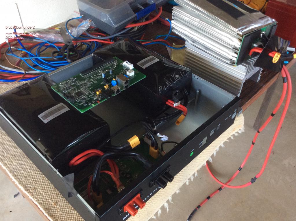

Thought I,d show what’s inside a Flat Pak battery pack .
Looks like the card of battery management control for equalising and 10 sacks of chemical consisting of the Lithium and other combining ore.
Each of 3.2 volts making 32 volts per battery pack ,'3 of these in series for a 48 volt battery.
This one is DEAD. .I think ?. The packs are very SWOLLEN aaaand unwrapping them just found each pouch connected to a PCB board which made up the negative and positive connections to the outside world. Not much else , so maybe ,when this is in good working order, it,s purely the container for the 2.5 Kw of battery power. Input and output cables are in parallel ,so maybe one set for charging and the other for powering A load.
Don,t know if I can buy the individual packs, will investigate that later.
Weighs in at 22 kg. So not very portable ,but for 2.5 Kw it,s probably around half the weight of gel cells or sla,s .
It,s a standard rack mount. Lovely connecting terminals and well made
SONNEN  2500 LFP2
Australian made.

They look exactly like my RC aeroplane batteries, even down to the orange xt60 connector. Where can we buy them in Australia?

Just did a quick search, going by the size of the I think they are 25Ah each cell found these.
They are Lifepo4 not to be mistaken with li-polymer, different stuff as far as I'm aware.
There are other options, will have to look around some more.
@Haxby I have a few of those old flight packs, polymer type they have an enormous discharge rate,but short cycle life, my RC chopper had about a dozen successful flights, then after could only manage a hover.
Cheers Aaron

Posted: 09:41am 20 Dec 2020
Thanks for the feedback, Aaron,
Yes,they certainly look the same as mine.
30 pouches won,t be cheap,so maybe if I can,t re charge these ,  then the only thing nice to reuse will be the big terminal posts.,,,,
And ,maybe a slim line rack unit for a new inverter,no, too narrow for our Torodials?.

It might charge up ok, don't leave it unattended, there could be some bad cells and others good, will see.

How would I know If I have some bad cells
They all look like new ,like no discolouration, visual breaks , etc..

The cell might heat up or expand a bit more, or once charged a cell will drop its voltage compared to others.
That's what I think anyway, perhaps the control system might not let it charge, don't know yet.
It would need the BMS connected by the looks of.

Very interesting tour, my cells or ,pouches, as I called them ,look very similar.
I was going to ask if anybody had dismantled one pouch to look at the chemical contents ,but now realise it would be foolish and dangerous .  The contents maybe toxic.
Would be interested in knowing what actually happens because of mis management in either the charging process or shorting out of the pouch .
But , I now realise that any physical or electrical cause would render that singular pouch to die or worse still effect the adajecent and other pouches that are in series. Just my ,Chain of events, thought on the destruction?.
Tanks Oreo,you have me much wiser , now.

Could just be age related swelling, or possibly heat/overcharging.  I have seen packs that still output >60% rated power that were badly swollen.  Some manufacturers keep the cells under compression using straps or bolted plates.  With them being Lifepo4, at least you don't need to worry to much about them burning down your house:).

Those flatpack batteries could have been drained flat by the BMS, I have found this a few times with laptop batteries and cordless drill batteries, seen it happen with a bunch I had in the shed they were sitting there charged for months, had a storm come though and they got a little damp in the shed with open sides.
All the leds on the the BMS circuits lit up and drained the cells completely, later on after circuit boards where clean and dry I charged them all up only to find all of the run flat again (several attempts), cut off the BMS from the cells and charged them again and all the cells were fine, they have been running the house since.
So there might be some fault finding to be done if the battery voltage Doesn't hold up after charging, could be the BMS, could be a cell not so good and the BMS goes into protection mode and safely drains the whole thing....This is only a guess at this stage, I would be interested to see how it turns out.
Expect the multi-meter to get a lot of use checking each cell's voltage, 15s 2p by the looks of it, in the flat pack.
