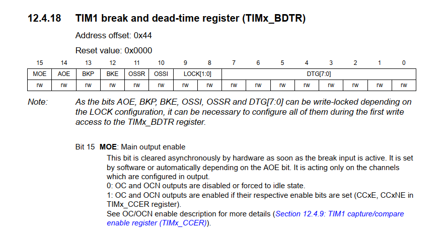

I lost more an afternoon to understand why with timer1 it is necessary
TIM1-> BDTR | = 0x8000;
In other timers it is not necessary.
Can you trust the precision of the Deadtime compared to the classics IR2110 or 2183?
Cheers, Angelo
poida
Joined: 02/02/2017
Posts: 1497
Posted: 09:50pm 07 Jun 2022
Hi Angelo
for most timers it's not but for TIMER1 (only one with DT)
TIM1-> BDTR | = 0x8000 is needed. on page 310
Precision of DT is very good. the 0x50 as used is
80 clocks delay of the 84MHz main clock
We can resolve it to single clock counts and from what I've seen
on the DSO it's invariant over time.

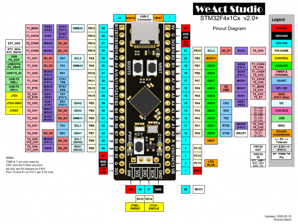

Poida, if I was to design an Arduino clone brain board for my 3 phase power board, would you recommend I use the black pill as the basis?
poida
Joined: 02/02/2017
Posts: 1497
Posted: 11:12am 14 Jun 2022
for sure the black pill micro.
3.3V outputs so choose your gate drive IC input resistors carefully.
Maybe they are voltage inputs, not current driven so it's all OK.
The Arduino nano can only do one pair of complimentary outputs
and those do not have dead time. So scrub that.
The Arduino mega can do 3 channels of the same but no dead time.
No good. Unless you choose to use IR's gate drive ICs that generate dead time
or roll your own with caps, logic gate ICs and whatnot.
The STM32F401 (black pill) can do 3 channels with dead time.
I can give you the pinout for the PWM outputs and analog inputs.
from
it's
ch1 high side A8, lowside B13
ch2 high side A9, low B14
ch3 high side A10, low B15
Analog inputs are A0,A1, A2 for the 3 phase Vfb and maybe A3 for a AC output setting
if needed, else just use trimpots on all 3 Vfb.
All analog inputs need to be between 0 and 3.3V
pin B9 could be inverter run/stop signal
pin PC13 is connected to the on-bard LED so I use that
to signal inverter is running.
uploading the firmware needs a bit of software to be installed.
Let's go there when needed.
(STM cube programmer and arduino IDE plus STM's board definitions.
It works fine on Windows 10)
close examination of the above image shows pin B14 is "timer 2/channel 2"
this is a mistake. It's timer 1/channel 2 which is what we need.
Before you draw up a PCB please make me confirm the pinout by physical testing.
(I just confirmed the pinout this morning at work. They made an error in the above image)
Edited 2022-06-15 07:47 by poida

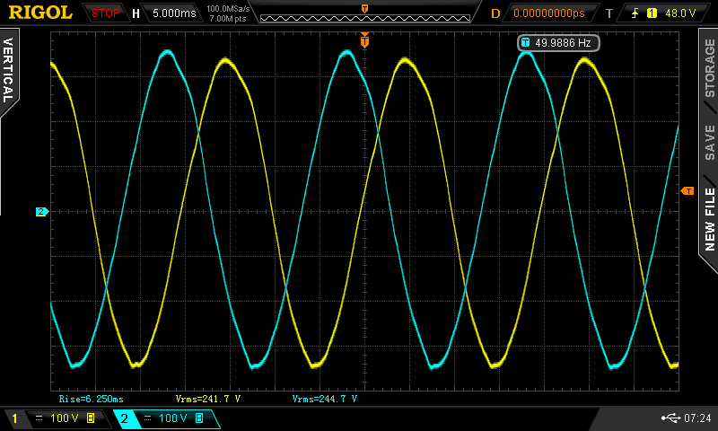

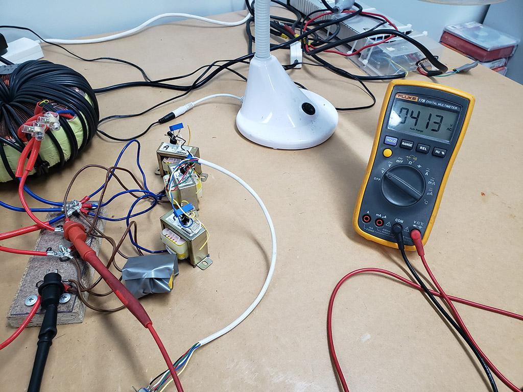

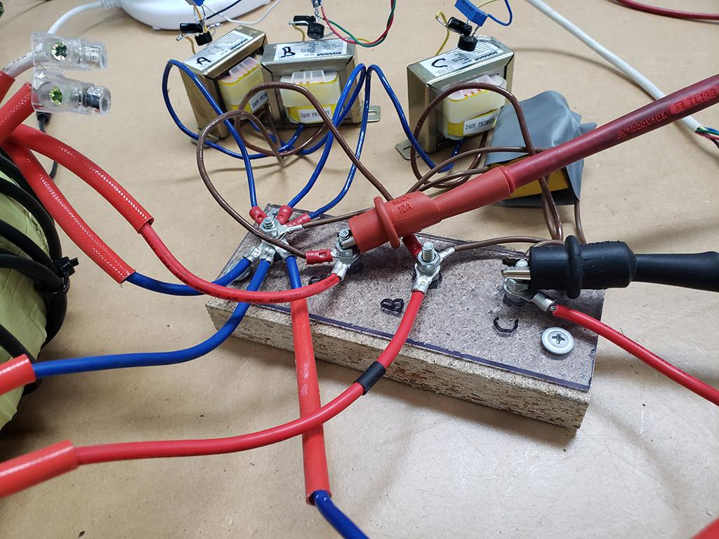

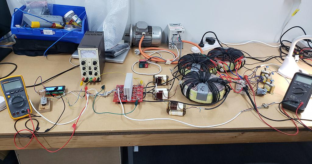

poida
Joined: 02/02/2017
Posts: 1497
Posted: 12:57am 22 Jul 2022
It works!
It does not have the DC bus caps installed yet, for safety
The code is a simple variac control.
The potentiometer goes from zero to 100% modulation
or 0 to 100% possible power. Best to power it up
when the pot is set at zero.
This code lets you slowly discover issues that would be
fireworks if powered with closed loop control.
f401-timer3-pot.zip
It runs on the STM32F401 Black Pill uC
60V DC input
230V AC out each phase
415V AC phase to phase
1uF caps across each 240V single phase to Neutral
too many primary winding turns, I need full SPWM modulation to get
this output. So just take a few turns off
60V and 1.1 Amp DC input for zero load.
This seems a bit high. I expected less. It's 22 W per toroid.
I used 2 x 1.5kW and 1x 2kW toroids so the amount of iron is not
that large enough to consume 66W.
Maybe 66W is reasonable after all.
The IGBTs are run at 20kHz PWM so that might be where some loss is
occurring. The heatsink gets a little warm, maybe only 5C warmer than
ambient.
Deadtime is 1uS, maybe too long. or maybe too short.
I recall finding deadtime could effect idle power losses
when fiddling with the single phase inverter prototype years ago.
Later I will add DC bus caps, check closed loop control code
and finally attach the 2kW DC supply.
Then try it with a 1/2 hp motor as a load.
Edited 2022-07-22 11:15 by poida
Revlac
Joined: 31/12/2016
Posts: 1309
Posted: 09:19am 22 Jul 2022
That looks good peter,
I expect the idle current to improve a little after adding some capacitance on the DC bus, it worked that way for the single phase, I think we might need more than 1 metalized polyester capacitor to help with the 20Khz, perhaps, will wait and see
I don't have a STM32F401 Black Pill yet.
Cheers Aaron

I tried 2x and 1/2 DT and still got the 1.1 Amp draw at idle so
I expect deadtime is not that critical with the parts I used and
1us deadtime as standard.
The 3 Vfb signals are badly effected by EMI and useless.
Some signal conditioning at the microcontroller board is needed.
I made Vfb from a 240 ->6V transformer/diode bridge/1uF cap and 10K trimpot
voltage divider, then the now 0.55V DC signal is taken back across the entire
calamity to the control/power board.
Measuring the signal with the DVM shows it to be 0.55V but there is a LOT
of EMI present.
So there was no closed loop control of the output, just direct control of
all 3 phases via the pot. All three phases are different voltages, differing
by 2 Volts or so. I want to eventually have them all the same from using
individually adjusted PWM duty for each phase. Then we have a balanced
3 phase voltage output.
For a start I could have Vfb = 3.0V instead of the 0.55V I use for some
dumb reason. (I confused 0.55 as volts when it is in fact 0.55 x 5V ..)
The Black Pill micro is 3.3V based so analog voltages need to be no more
than this. So 3.0V for 240V output will give a bit of headroom but give
6x the signal for the same noise.
Next week I do this, work permitting..

Tight placement of components is key to decrease EMI. With no power supply caps, the whole thing might be acting as a transmitter.
To decrease EMI I strongly suggest:
1. Put low value film type caps on the PCB bus bars, and install the electrolytics. I used 3 of the 1uf film caps that came out of aerosharp inverters. Very low ESR. Nice and close to the IGBTs.
2. Place the 3 chokes as close as possible to the 3 output terminals. There is a fast dI/dT and dV/dT right at the MOSFET legs. You want to convert it to a slow sinewave using the chokes, with the shortest amount of antenna wire between IGBTs and chokes.
3. Get the black pill within millimetres of the driver chips. I'll be designing a carrier board to do this. Don't run logic signals off the board. Don't even run the micro power supply off the board. Keep it all compact and on board.
4. Vfb wiring needs to also be short between the transformers and microprocessor. I'm talking 3cm at most. Use small transformers. I have some TV1013-1M that might work. They have a 0.5+- output. I can send you 3 of them.
I wonder if the +-0.5v output can go directly into the micro through a resistor without being rectified. The micro may tolerate the negative voltage. Many are ok with their pins going negative 0.5v

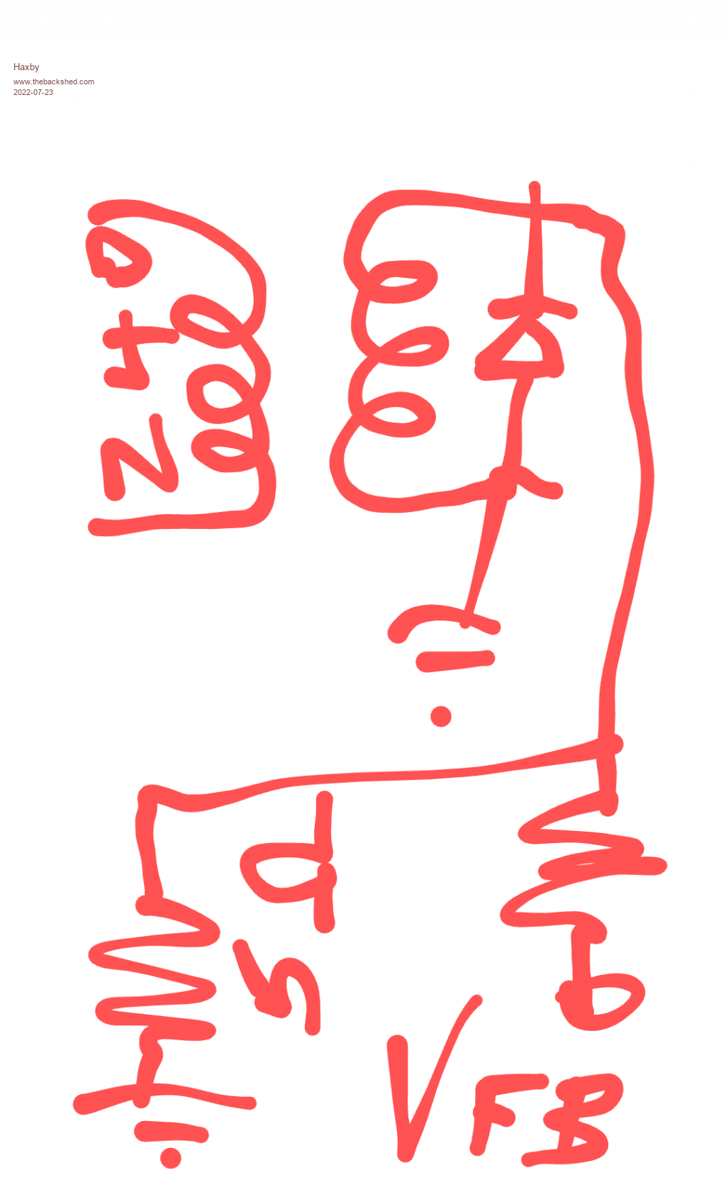

Regarding Vfb, thinking about it some more, maybe something like this will work, using the little current transformers.

Important fact re. Black Pill
We must be able to remove the module to program it or reprogramming
The Arduino IDE + STM Cube combo needs us to hold the cpu between fingers
when entering DFU mode (needed for programming)
The Black Pills have non-optimal results entering DFU mode.
We need to alter the cpu/cpu temp sensor/cpu clock/something!! by holding it
between fingers while pressing the two buttons in sequence.
So forget about soldering the Black Pill module in place.

Haxby, I have 13 turns on each of the chokes.
Since the heatsink is getting warm during 5 minutes of zero load at 240V AC output
I was wondering if there is a bit of shoot through.
The DT test I did earlier suggest not.
I put a current sensor on the DC supply and with the board having no
DC bulk caps installed I should be able to see high current spikes
at the start and or end of each PWM event.
I only saw typical ramps up in current, no large spikes.
Maybe the IGBTs have a relatively large ON resistance compared with FETs..
Something is making the heatsink warm up

I have a usable Vfb now. The 6V AC -> diode bridge -> 10K trimpot is now set to 3.0V
This winds past the EMI sources piking up lots of crap and back to the power board.
This signal now goes to a RC low pass filter, 2K2 and 10uF soldered direct onto
pin A0 (and A1, A2) on the Black Pill.
Noise is about +/- 2%
Now I can start work on closed loop control.
I want to control each phase's output voltage and keep it tight to about
+/- 1V of each other. I will need lower noise levels than above...
(then after that, put in the soft start/stop and PID control, test that
a bit and then add the bulk caps, test again, then finally hook up
the proper power supply and see if it can run the motor)
