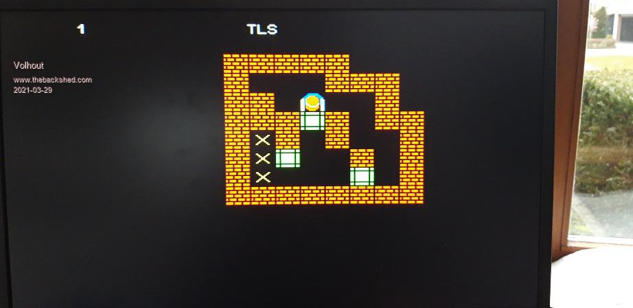

Ok, one day of bad weather, wife out the door, a last moment release for the TLS (Ten Line Sokoban) entry.
I am still within the boundaries for the challenge (100 characters, 48 lines).
This is 37 lines of 80 characters. I had to improve the sprites a bit. Using 14x14 now versus 9x9.

Game task: move the green boxes onto the yellow crosses.
You (the Mario type guy) can only push the boxes, not pull.
Typing lower case "r" reloads the current level.
There are 20 levels. The level is shown in the left top corner.
Mario is controlled using cursor keys
A picture of the game play...
Edited 2021-03-29 03:49 by Volhout

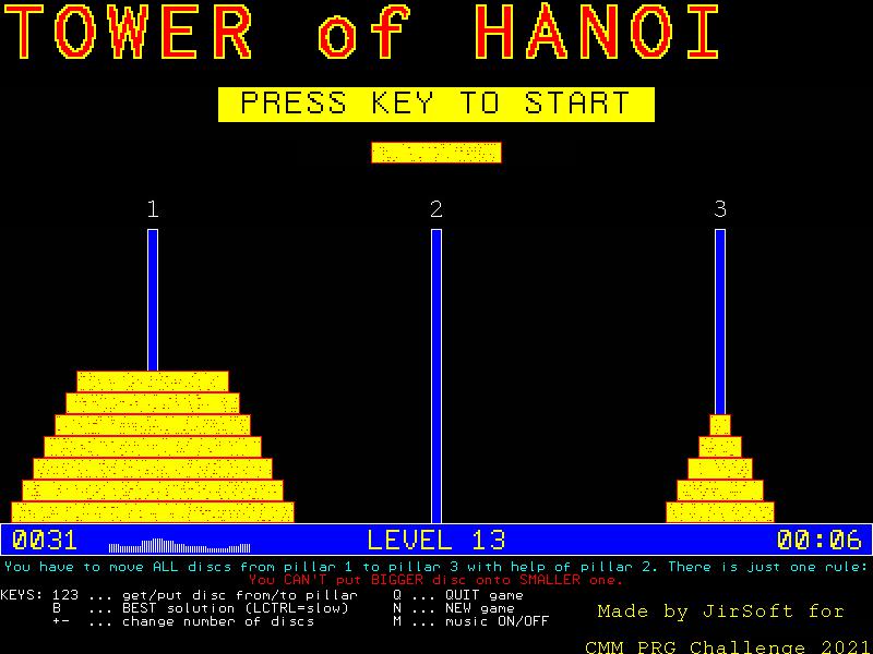

Hi
here is my "piece of gold" - Tower of Hanoi. I worked on it all the weekend, but it still can't be compared to Mauro's or Vegipete's work

Jiri

  Volhout said  I had to improve the sprites a bit. Using 14x14 now versus 9x9.
Looking pretty slick!
Could you check level 6?
(Data 6,6,,,3FF,3FC3,3C23,3CE3,3163,317F,32F0,30C0,3FC0)

Posted: 06:51am 29 Mar 2021
Hi Vegipete,
I fixed that level in a previous release. But the change got lost (I need version control....;). The correct level should be:
Data 6,6,,,3FF,3F03,3023,30E3,3163,317F,32F0,30C0,3FC0
I do this at my work, from a piece of paper and memory. Do not have my CMM1 here.
Tonight I will check on the machine itself, and update my entry for the challenge.
Thanks for finding the bug...
Posts: 6169
Posted: 07:53pm 29 Mar 2021
Vegipete, thanks for checking the game. Really appreciate it.
This is the full listing. After checking all levels, I found one more bug.
Here is the final listing with all levels playable.
s=11:z=16:Dim f(s,s),t(s,s),v$(16):GoSub 1:Sprite Load"x.s":Do:Mode 4:Read x,y

For the person who wants to try an run this CMM1 (basic 4.5C) version of TLS on a CMM2...
First of all, thank you for trying. But if you start, please try this first:
I noticed by loading the code into the MMBasic DOS interpreter (newer basic 5.04) that (besides the commands it does no know) the interpreter adds spaces in some locations.
This makes the lines slightly longer.
Especially for the FOR-NEXT and DO-LOOP commands the NEXT and LOOP must be close enough to the associated FOR and DO counterparts or this will cause trouble. Maybe related to the way the MMBasic interpreter look-ahead buffer works. But if you place the NEXT and LOOP at the beginning of a new line, it works.
Below program simply puts LOOP and NEXT at a new line. Maybe that makes it work.
Of coarse you need "OPTION LEGACY ON".
Alternatively I can make a nicely formatted version, that also make the code much more readable....
For i=1To s:Read a$:l=Val("&h"+a$):For j=1To s:f(i,j)=3And l:t(i,j)=(f(i,j)=1)
l=l\4:

(I added a cheat to skip levels ;-)
Posts: 6169
Posted: 10:16pm 03 Apr 2021
Thanks Vegipete,
I noticed you also replaced SPC() with Space$(). Small lingual differences.
Nice implementation of the "n" for next level.
Please also replace:
Data 2,3,FFC,3FC0C,30C8C,300BF,37F23,37203,3703F,37230,37F30,30030,3FFF0
With:
Data 2,3,FFC,3FC0C,30C8C,300BF,37F23,37203,37003,3723F,37F30,30030,3FFF0
Otherwise level 12 gets very hard to solve.....
