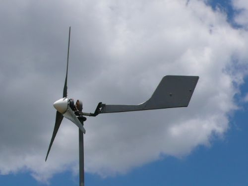

Hi All ,
I have finally put the mill back up and have used a dual stator set up in 2 x 80s 2s 7p with one in star and 1 in delta , both have the caps and voltage doublers and std rectifiers in parallel and twisted poles approx 10deg, as you can see from the pic of the cabnet at the base it is a bit of work to get it all set up , especially for someone who is a bit challanged in the electricial finner points
It went up last tues at 2.30pm in a very light 10 to 15 klm patchy breeze and the moment it started turning it sounded completly different from any of my previous mills , The quad ( would not have been turning ) The dual Neos wouldn't have looked at at spinning , my first dual , which are the same stators fitted here had to have the bridge recs in series and the output was dismal , BUT this is the WINNER buy a MILE , instantly the amps were sitting on 1 to 3 and even when it died down to just moving the leaves I was still getting .2 to 1 amp into 53V ... As Gordon has said " POWER WHERE THERE IS USUALLY NONE "
A couple of slight puffs came through of approx 20 to 25klm and the amps instantly shot to 12 ( 600watts ) for a few brief moments and with in 4 hrs 225 watt/hrs were accumulated on the piclog , the next day was even more dismal for wind and 250w/hrs were accumulated , 1/2 Kw where all my other mills would have been lucky to do 100W/hrs..
As was posted in the graphs Gordon did from my Lathe tests on output from a dual in this config it seems to be performing exactly as the power curve says , cut in is @ 100rpm and just keeps going up in relation to the wind .. The blade dia is 2.850mt and are the same blades that hit the deck on the Quad , cut down and reshaped and I feel they are still to big for this set up as the tips are making a fair bit of noise at higher rpms .
I am unable to publish the data from the piclog at present as there are problems with the Rpms as the AC pulse is all over the place and very high voltages , due to the Caps hopefully this will be sorted out soon , I also don't have a annemometer as this was destroyed with the quad failure , hopefully soon it will be all working better than before as I now have upper guys and the A/C leads running through the pole and have made provision for the annemometer to mount just below the blades on the pole .
In summing up to this point .. I must give credit to Dennis L for starting the cap testing and Gordon for his tireless efforts with the Caps and Doublers etc and Brian for the twisting poles to minnimise clogging . As stated many times over IT DOES WORK!! and I don't really care how it does it and how the capacitor works or what happens to the flux before and after etc ..etc ..etc.. as many out there seem to want to debate the finner details . I am just over the moon with watching the results on an amp/watt meter going back into the grid inverter is enough for me ,and of course to keep testing and posting results ...Regards to all...
PS.. The big gap behind the rear rotor was for the Quad Stator which needed 6 blades to even try and match the output of this mill , #2 is on the way and it wont be "THE BEAST"...

Excellent work Phill, you quite right to be proud of it.

Well done Phill.

Very nice looking set up there Phill. It works and that s the key thing. Gordon has done a great job testing out different configurations, and it looks like it has culminated in a very usable system for you.
The doublers seem to fill the gap of electrickery quite nicely, and this is a good thing for the pwm challenged. It means a simple inexpensive bulletproof system is only a wiring job away for the F&P'ers.
As with all the things you do, it looks the part as well.
Nice work........

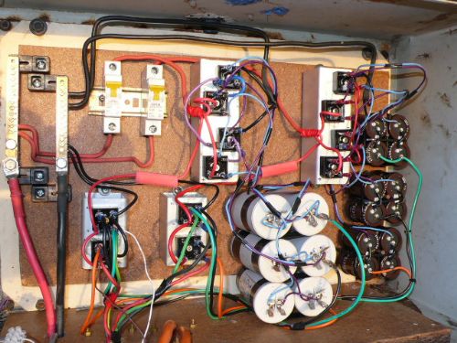

However, do we have a comprehensive schematic of a F&P mill incorporating capacitors anywhere?
GWatPE
Joined: 01/09/2006
Posts: 2127
Posted: 01:18am 17 Jan 2009
Hi Kiwijohn,
There is a schematic that I posted for the capacitor doubler on p15 of the visual effect of caps thread, but I will include a link here. cap cct
The doubler is connected across the normal bridge rectifiers. This is a parallel arrangement. The wild AC from the normal rectifiers inputs connects to the sets of caps in the doubler.   The rectified outputs from the doubler connect to the DC lines to the load.
It is important to NOT leave out the normal rectifiers. Cap values of 50uF to 250uF 240VAC, or equivalent continuous rating will work for a 24, and 48V setup. larger and smaller cap values will decrease doubler effectiveness. I have no testing for 12V system.
