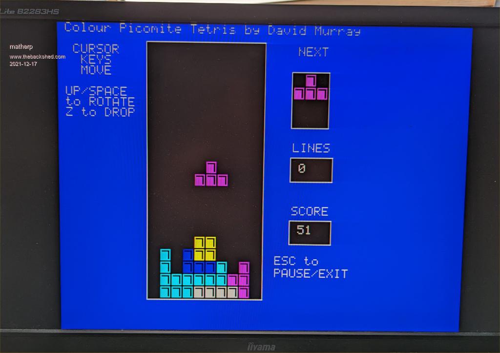

PicoMiteVGAV5.07.01b4.zip
Fixes a bug in writing to the colour screen with black text
Just for fun I added some small level of original Colour Maximite graphics compatibility like the CMM2
Available in the PRINT statement is the @ function for locating the cursor (see CMM2 manual)
OPTION LEGACY ON/OFF is a temporary option to be used in a program. It affects the following commands
COLOUR - uses colours 0-7, see original colour Maximite manual
PIXEL - see original colour Maximite manual
LINE - see original colour Maximite manual
CIRCLE - see original colour Maximite manual
To prove compatibility here is David Murray's Tetris implementation running with no changes on the PicoMite VGA edition

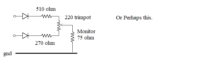

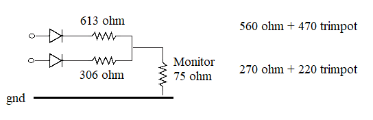

An alternative 2 bit green mixer. Might make PCB layout a bit easier.
The calculated values are for linear spacing of the steps but that isn't overly important.
Choose what looks best to you, as long as the parallel combination is about 204 ohm.
This is less than the 220 ohm on red and blue because of the diodes.
Edited 2021-12-18 09:33 by phil99
Posts: 11861
Posted: 09:13am 18 Dec 2021
Phil99's circuits miss the critical issue. It is not the balance of half green to full green that matters. The key one is the balance of RED/BLUE with FULL GREEN otherwise there will be a colour cast to white text and the eye is VERY sensitive to this
My component values were what gave me a clean white image but for more certainty replace the 150ohm resistor in my circuit with a 220ohm trimmer
The values in the R2R DAC don't matter as much as long as you can tune the white balance. The advantage of an R2R DAC is that it is by definition correct and has a defined impedance (always equal to R regardless of the number of bits)
Posts: 3380
Posted: 12:09pm 18 Dec 2021
"there will be a colour cast to white text and the eye is VERY sensitive to this"
Yes, good point so scrub the bottom one but the top one with 2 trimmers making up the odd resistor values could get that balance.
