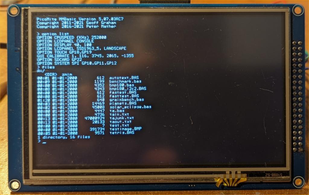

Just playing
Grogster, fancy doing an adapter?

What are we looking at, is this some sort of parallel display panel ?
Posts: 9133
Posted: 06:24pm 04 Jan 2022
It is, yeah. I got one some time ago to go with my F4 (but still never got the two connected together as it involves some serious cross connecting when you put them back-to-back)! It's a pot-boiler project.

  matherp said  Just playing
Yippie SSD1963 on the Picomite... or not?
PicoMite MMBasic Version 5.07.03RC7
> option LCDPANEL SSD1963_5, LANDSCAPE
Error : Invalid display type
Aaaargh how can I get my hands on that version?
Edited 2022-01-05 05:55 by fred777

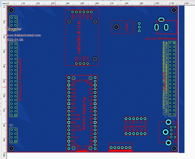

  Quote  Grogster, fancy doing an adapter?
Sure.  Send me the schematic or post it here, and I can whip one up.
Are there any pins left on the Pico after connecting a parallel LCD and touch?

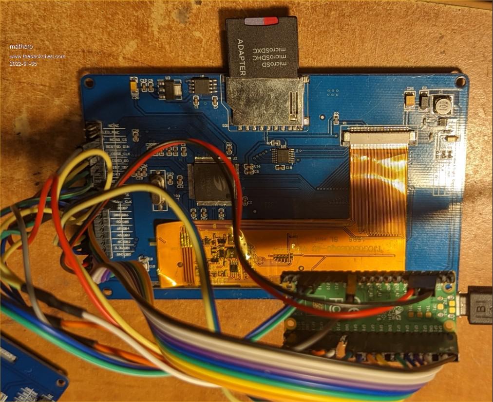

Posts: 3379
Posted: 04:22am 05 Jan 2022
"Are there any pins left on the Pico after connecting a parallel LCD and touch?"
Looking at Peter's photo just a handful, If a keyboard and RTC are added it's about full.
Posts: 9133
Posted: 07:23am 05 Jan 2022
You only need 4 pins. Two for a keyboard, two for an I2c. An external I2C DAC would be fine if you want analogues, or a 28-pin Micromite for mixed IO. RTC can go on the same I2C bus.
There are I2C keyboard designs around, in which case you only need two pins. :)
Or use a "soft" on-screen keyboard, of course.
Edited 2022-01-05 17:24 by Mixtel90

This is what I have so far - just doing the major component placement at this stage:
PM down the bottom of the board to give easy access to its USB socket.
ER connector at left side, standard 4-7" TFT connector at right(both on bottom)
3940 1A LDO 3v3 regulator to power both types of screen.(won't use the PM 3v3 output)
Four-channel 5v/3v3 bi-directional level corrector(two channels for keyboard, the other two for COM1)
Standard RTC module.
Six-way PCB header for the six pins left over after all the tracks are laid.
I plan to squeeze this layout a bit more horizontally, to make it 100x100.
Once complete, I will certainly release all gerbers and drill data files etc.
I think I will start a new thread for this board, so as to not hijack this one.
