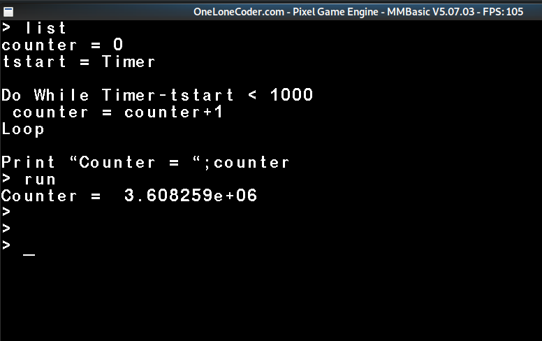

this are the results with the gui version: FPS 105 but loop with 3.6 mio/s
-andreas

Posted: 01:56pm 27 Jan 2022
  andreas said  this are the results with the gui version: FPS 105 but loop with 3.6 mio/s
-andreas
Well more than that, actually because you are doing the Timer - tstart for every loop.

Posted: 02:17pm 27 Jan 2022
  Tinine said  Well more than that, actually because you are doing the Timer - tstart for every loop.
Yes!
Dim integer counter = 0
Timer = 0
Do While Timer < 1000
Inc counter
Print "counter="counter
BTW: FPS: 17 (4*3 GHz)

Posts: 6604
Posted: 07:44pm 27 Jan 2022
  matherp said  Need to find a better timer - any ideas?
On Windows I use QueryPerformanceFrequency to get the timing resolution
and QueryPerformanceCounter to get the ticks.
You only need to use QueryPerformanceFrequency once at the start of the program.
I have never tried on Linux but I think you get the same with clock_gettime & clock_getres.
They should be easy enough to use for the TIMER function but I am not sure how it fits into SETTICK etc.

Posts: 11856
Posted: 03:32pm 28 Jan 2022
MMBasic.zip
Timer function now accurate to 0.1uS and reported as a floating point number of milliseconds. Settick and pause remain as-is and have an accuracy of around +/- 16mSec. I could fix this but only by having a thread running continuously reading the high resolution timer. If you need accurate timing you can have the tight loop in basic with the TIMER function
timer=0:do:b=timer:?b-a:a=b:loop
Some other reported things fixed
Currently working on the PAGE command and second display layer

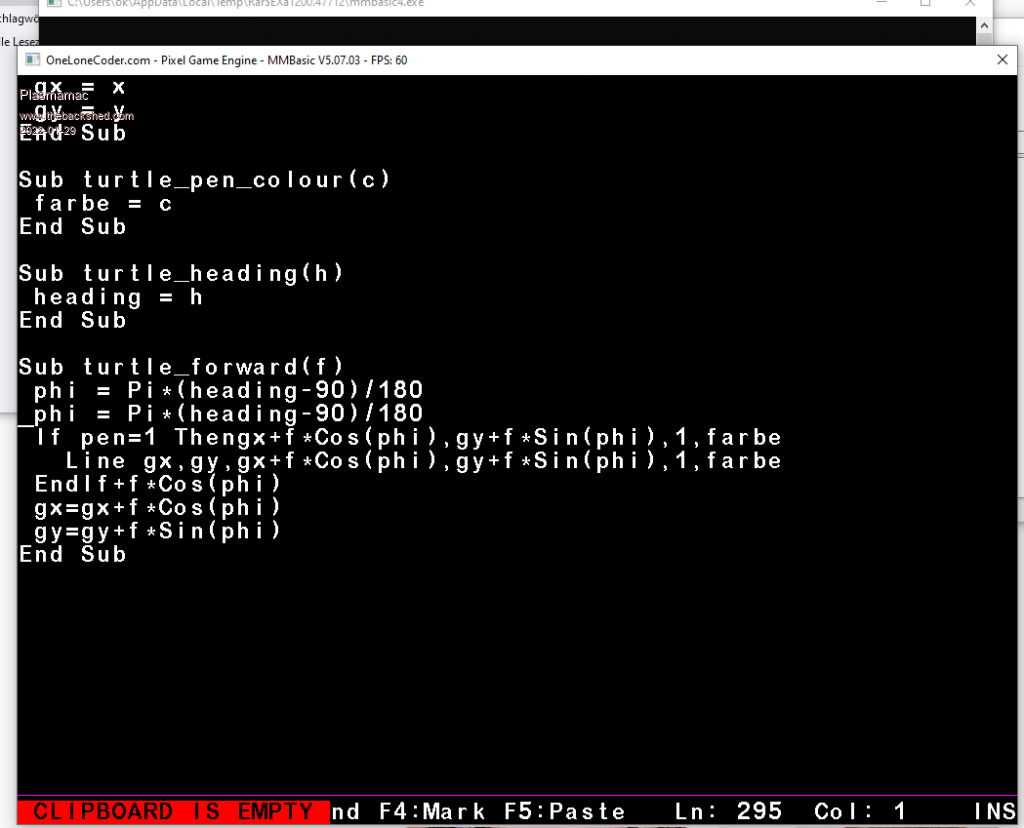

Hello, I'm very happy with this MMBasic Version and waiting every day on new releases.
I'm using it under debian linux and wine. The advatage is, I can edit the source code using linux editors and after saving the code to the ~/documents folder a simple switch to the basic gui allows a load " myprog.bas to get the code loaded. I do this by pressing the up-arrow which has the last load in the history.
Here is my nikolaus program running under 5.07.03pa1 - have fun!

Plasmamac
Joined: 31/01/2019
Posts: 620
Posted: 05:48pm 28 Jan 2022
Hi ,
trying the turtle code from andreas gives me an error in line 296
then type edit
press enter
the line show double  but clipboard is empty
hope it help
Edited 2022-01-29 03:49 by Plasmamac
Plasma
andreas
Joined: 07/12/2020
Posts: 226
Posted: 05:52pm 28 Jan 2022
  Plasmamac said  Hi ,
then type edit
press enter
hope it help
The original code should be:
sub turtle_forward (f)
 phi = pi*(heading-90)/180
 if pen=1 then
   line gx,gy,gx+f*cos(phi),gy+f*sin(phi),1,farbe
 end if
 gx=gx+f*cos(phi)
 gy=gy+f*sin(phi)
end sub
possibly an transfer error...
-andreas
andreas
Joined: 07/12/2020
Posts: 226
Posted: 07:02pm 28 Jan 2022
I get the same error as Plasmamac when using pa2 version. Nikolaus runs using pa1.
-andreas
