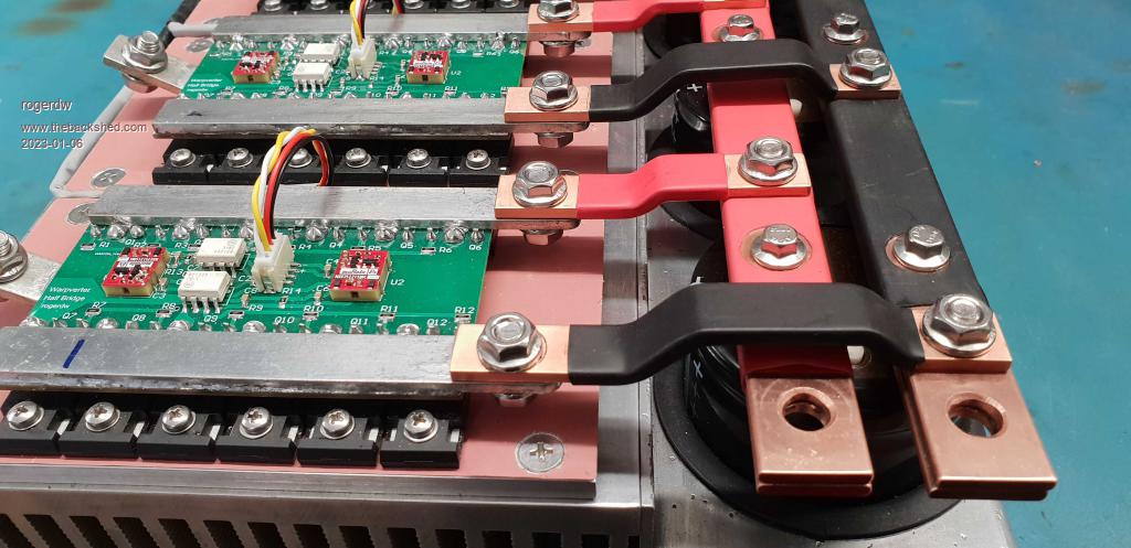

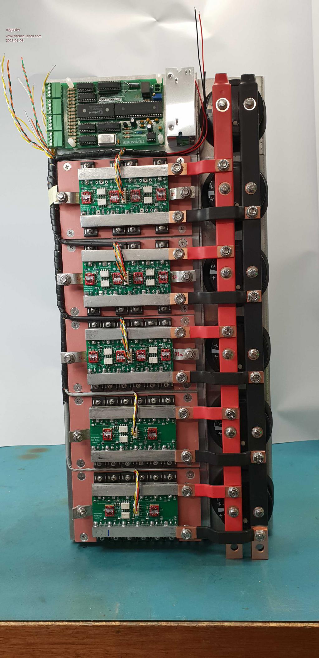

  Murphy's friend said  Very neatly build Roger.
I hope those copper busbars stay as shiny as they are now. Else you could tin them.
I found that's quite easy when one smears that solder paste (the one in little jars on Ebay) on them, holds on bar end with vice grips and using a heat gun gets the paste to tin everything very neatly. Then wipe it smooth with a (non synthetic) rag while is still liquid.
Thanks Klaus.
Yeah I like the look of newly polished copper too but not when it's all tarnished.
I like your idea for tinning though, I had not thought of that way. I have a 120W soldering iron I bought for some job many years ago and that worked really well to tin and solder the bars that I soldered to the boards  ...  a lot better and quicker than I expected.
I did start off trying to tin them in a solder bath  ...  but at only 100mm in diameter it was a bit messy.
In the mean time I have fitted heatshrink to much of it to help protect against accidental shorts etc. Maybe I could have masked the connection areas and used a clear laquer on it  ...  but no going back now.
  Quote  Regarding stacking the toroids on top of another, leave a decent gap to avoid magnetic coupling. I went to great lengths to orient each toroid at right angles from the next for that reason.
Whoops, I hadn't thought of that either. I'll see how it goes I suppose.
My initial thoughts were to keep them flat so the cooling fan can blow up through the centres  ...  but of course with most of them virtually full of wire, very little air will get through anyway.
If it becomes an issue, maybe I can tip a couple on their side.
  Quote  I like your clever capacitor mounting channel, you could fan cool them there .
Thanks, it was just some stuff I had lying around and seemed to lend itself to the idea.
It would look a lot neater if there was a cap on the channel top and bottom, but I recognised it would be important to keep them cool too  ...  so I'm leaning towards a barrell fan all the way across the bottom  ...  blowing air through the capacitor channel as well as past the heatsink and toroids.
Cheers,  Roger

Ha Roger, your heat shrink solution is very neat indeed. It must have taken you quite some time, you are a patient man who likes to do things better than I can   .
Another suggestion, why did you only bend the half bridge transformer connection busbars at 45 degrees? Connection at all the full bridges would be easier with 45 degree bent busbars as you might need to get a spanner to the bolt head as you tighten the nut.
Make sure there is no charge in the caps when you connect up .
You realise, of course, that you now have to fit the whole caboodle inside a clear Perspex case for future generations to admire .

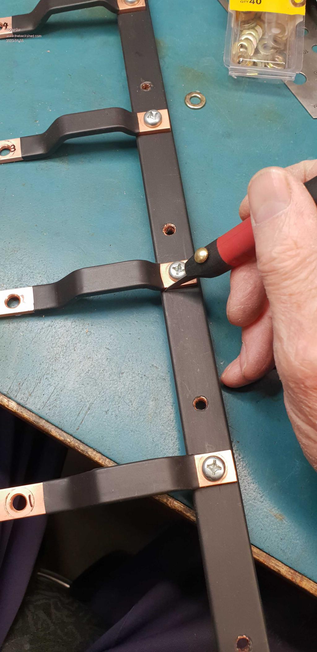

  Murphy's friend said  Ha Roger, your heat shrink solution is very neat indeed. It must have taken you quite some time, you are a patient man who likes to do things better than I can   .
Thanks for the compliments Klaus but as I mentioned above, I've learned a lot from you and the way you build things  ...  and I've just seen your new battery management  system  ...  and that is a work of art as well as being a very detailed project.
The heatshrink was surprisingly easy. I just fitted a piece to each busbar and while it was still hot, pressed into each hole to identify where I needed to cut.
I used a wad punch to cut the round holes and a scalpel to cut out the square bits. On the second one, I loosely bolted the short bars in place and cut up close with the scalpel, which was quick, easy and accurate.
  Quote  Another suggestion, why did you only bend the half bridge transformer connection busbars at 45 degrees? Connection at all the full bridges would be easier with 45 degree bent busbars as you might need to get a spanner to the bolt head as you tighten the nut.
That's a good question  ...  it does look a bit odd having them different.
I think my reasoning was that the large transformer will have very thick wire connecting (70mm­²)  ...  which will likely be fairly difficult to line up and connect.
The smaller transformers will have much smaller wire, so hopefully will be easier to connect to. Will have to wait and see.
And the wires joining onto the RHS lugs can face back to the left and avoid rising up close to the positive busbar. If those lugs came out at 45°, it would be difficult to face the wires back the other way.
I did make some spare modules, but of course I made them the same, so can't even just swap them out  ...  and as anal as I can be  ...  I'm not going to try and rebend them to match.
  Quote  Make sure there is no charge in the caps when you connect up .
Yes, I am slightly nervous about them  ...  especially when I use a spanner to tighten the bolts. The bolts have a flange with like a knurled surface, so don't require a lot of force to prevent rotating as you tighten up.
  Quote  You realise, of course, that you now have to fit the whole caboodle inside a clear Perspex case for future generations to admire .
Haha yeah, I was wondering if I should put a perspex front on the box  ...  but probably wont be up to 'code'. Maybe I need to borrow some ideas from the crazy gamers and have a clear case and coloured leds  ...  or maybe not.
Cheers,  Roger
