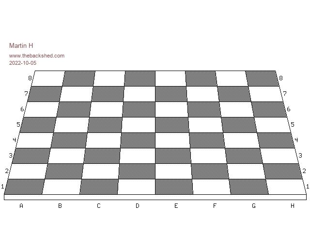

ok, that is a chellange
I squised the routin for drawing the Background to exact 900 Byte
MODE 1:w%=RGB(White):CLS w%:Colour 0
For y%=0 To 7: For x%=0 To 7:If (x%+y%)Mod 2 Then Pixel x%,y%,0
Next :Next :For y%=146 To 396 Step 8:For x%=8 To 624 Step 8:
Sprite 0,0,x%,y%,8,8:Next :Next :Box 0,0,8,8,,w%,w%
Triangle 8,146,72,146,8,402,w%,0:Triangle 568,146,632,146,632,402,w%,0
For y%=0 To 7:For x%=0 To 7:If Not ((x%+y%)Mod 2) Then
p1X%=(72-y%*8)+x%*(62+2*y%):p1Y%=146+y%*32
p2x%=(72-y%*8)+(x%+1)*(62+2*y%):p2Y%=p1Y%
p3X%=p1X%+(-8+x%*2):p3Y%=p1Y%+32:p4Y%=p3Y%:p4X%=p2X%+(-8+(x%+1)*2)
Triangle p1X%,p1Y%,p2X%,p2Y%,p3X%,p3y%,w%,0
Triangle p3X%,p3Y%,p4X%,p4Y%,p2X%,p2y%,w%,0
EndIf :Next :Next :Line 72,146,568,146:Box 8,402,625,12
Line 72,146,8,402:Line 568,146,632,402
For x%=0 To 7:Line 72+x%*62,146,8+x%*78,402:Next
For y%=0 To 7:Line 72-y%*8,146+y%*32,568+y%*8,146+y%*32
n%=8*(7-y%):Text 2+n%,32+124+y%*32,Str$(8-y%),,,,0,w%
Text 632-n%,32+124+y%*32,Str$(8-y%),,,,0,w%:Next
F$=String$(9,32):Text 40,420,"A"+F$+"B"+F$+"C"+F$+"D"+F$+"E"+F$+"F"+F$+"G"+F$+"
H",,,,0,w%
or we just use "Load jpg"
cheers
 Mart!n
Edited 2022-10-05 18:40 by Martin H.

Hi Martin,
picomite is running out of variable memory. Not program memory.
So squeezing code is not yet in order. We should focus on data RAM since that is scarce.

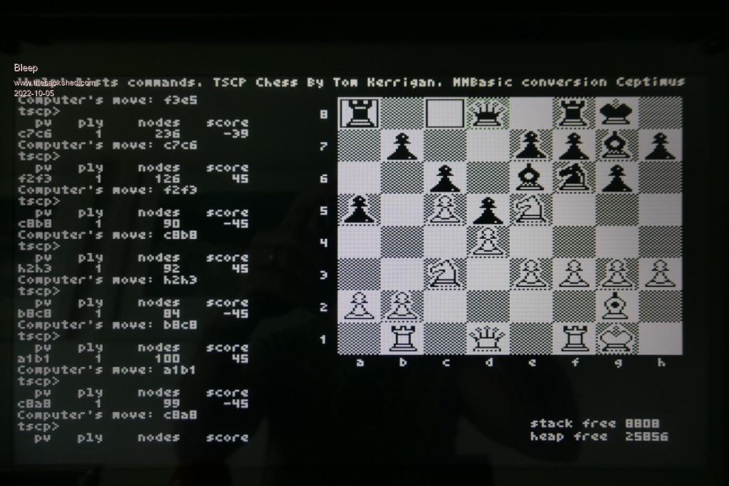

Ok,
I've now had some time to do the improved pieces properly.
I have tried the higher resolution bitmaps, but there is not enough RAM to even be able to load them, let alone do anything with them, so a Mode 1 screen is a no go, which means staying with Mode 2, so you can use colour if you want, within the usual PicoMiteVGA colour restrictions, ie 16 predefined colours.
This is how it looks on my screen currently, though there are problems, over which we have no control.
Volhout, I sent you a PM yesterday, can you check it please.

Hi Kevin,
looks very nice...
If you wish, I can create a colorised Tileset.
now I just have to learn chess
 Martin

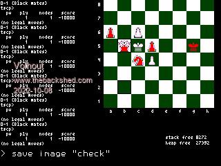

Hi chess addicts,
1/ Kevin's version can win a game. At max-depth=5 it took roughly 3 days to reach to this point, with a valid check-mate. Black (red) wins...
2/ Not sure if this would work, but in stead of using a large BMP file (260x40x4(24color+alpha)) with all the pieces, we might be able to use sprites. I mean real sprites. In our 160x160 field of 8x8 tiles, each tile on the board is 20x20. A sprite (16x16) would gently fit in the 20x20 tile. Using sprites would also require only 2x6=12 sprites, not 26 tiles we have now. (sprites can use black as transparent, or as black). The board would be drawn using BOX'es.
For sprites there is a sprite editor (at least for CMM2 and for CMM1). Not sure if one exists for the 16 colors of the pico. Maybe sprites consume less memory than the BMP will. Sprites use color numbers in the sprite definition file (1 char per pixel, using only 4 bits). Not sure how they are stored in RAM.
Edited 2022-10-06 00:18 by Volhout

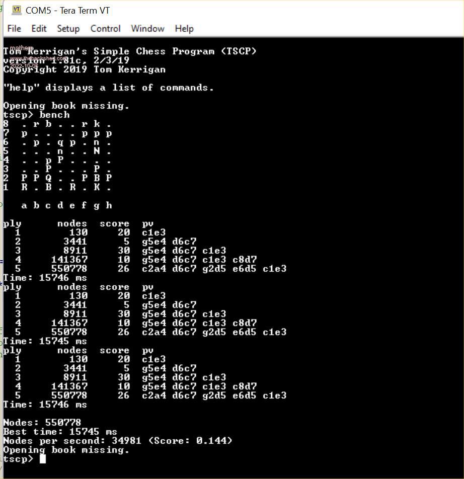

For interest this is the chess code running in C on the Pico at 378MHz
So this is pretty much the maximum speed possible with the Pico
Your terminal program needs local echo on and there is no line editing
TSCP.zip

Hi Peter,
Thanks for doing that, it's way faster than the basic version, as you might expect, I think 5 levels was taking about 30minutes.
Now we need to see if it is possible to have that as a callable routine from Basic to do a nicer board. :-)
Regards Kevin.
