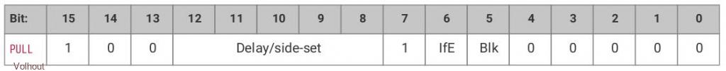

Now data is in the PIO domain, we process it further with PIO instructions. From the FIFO we read the value in the OSR register by the PIO PULL command.
DELAY/SIDE SET: we know this...
IFE: if empty, we will not discuss this here...
BLK: Blocking, this will stall the PIO when nothing in FIFO
Blocking: When there is not data in the FIFO the PIO will wait for data. This is exactly what we want. We tell PIO to generate a gate pulse when we want it to. Not go on an errand mission on it's own.
PULL block = 100 00000 10100000 = 1000 0000 1010 0000 = &h80A0

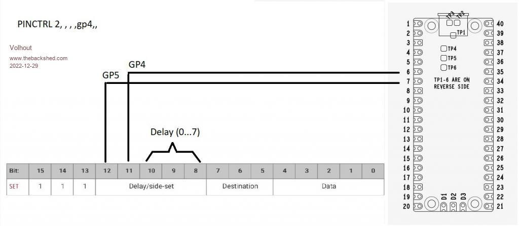

In previous chapters we have explained that SET can be used to set a GPx pin high or low. The SET command is a separate instruction, and makes use of the SET IO configuration. But PIO supports a second method of controlling GPx pins: SIDE SET.
The name SIDE SET explains exactly what it does: it can set a GPx pin high or low as a side effect of a different instruction. A JMP can control a GPx pin. A MOV can control a GPx pin, a PUSH or PULL instruction can control a GPx pin, and even the SET instruction can SIDE SET additional pins.
The SIDE SET is configured similar to the SET: in the PINCTRL register. Remember, in PINCTRL there was a field for the number of SET pins, and the first pin in the sequence. Identical SIDE SET pins are configured, only it uses different fields.
PINCTRL a,b,c,d,e,f,g
a/ number of SIDE SET pins: we are going to use this now
b/ number of SET pins
c/ number of OUT pins (not detailed here, wait for chapter 10)
d/ starting pin of IN pins (notr detailed here, chapter 9)
e/ starting pin of SIDE SET: going to use this here
f/ starting pin of SET
g/ starting pin of OUT (explained in chapter 10)
Field "a" in above is a very important field. The value in "a" is not only used to determine what pins are used, but it also is used as a separator in each program instruction.

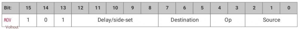

You may have noticed that every PIO instruction contains a DELAY/SIDE SET field. Up to now we have exclusively used it to program a delay. All 5 bits where used for DELAY. We could use a delay of 31 (5 bits) only because the PINCTRL "a" field was set to 0. (no side set pins).
Once we change the "a", the side set and delay functions share the 5 bit field. In case we configure 2 side set pins, 2 bits are used for side set, and only 3 remain for delay. In that case the maximum delay is 7 (&b111).
See below, where this is depicted.
Side set is a blessing, and a burden. Once you decide to use side set, you can write compacter programs, or faster, or more capable, but you have to configure the side set field in EACH instruction in that state machine. Forget one, and side set will set the pin(s) to 0...unexpected...
note: there is a mode where 1 bit in the delay/side set field is used a side set enable bit, but we do not use that mode here as you have to sacrifice 1 precious bit in the 5 bit field.
Note that SIDE SET range and SET range are independent in the configuration. Ranges can be identical, they can overlap, but they can also be adjacent. So a SET instruction can SET 5 pins, and SIDE SET 5 pins, so it can control 10 pins. SIDE SET pins are set to output the same instruction as SET pins.
If we look at the previous GATE PULS example, there where 2 instructions to SET the GATE pin high and low.
These instructions can be replaced by the SIDE SET in other instructions.

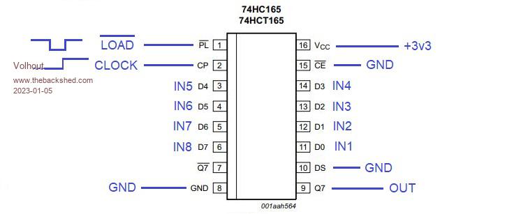

What if we would like to read a different shift register. This is the datasheet of the 74HC165. We go the same path.
this results in below connection diagram
The difference with the 4021 is that the load puls is going low for load. During shift it is high.
The first exercise is to adapt above program to support the 74HC165. If you happen to have a 74LS165, it must be powered from 5V. The clock and load inputs will accept 3.3V signals, but the serial output is 5V. A 1k/2.2k resitor divider will make a 3.3V signal for the picomite.
The second exercise is to adapt the HEF4021 program to use SIDE SET for clock and load signals. This shrinks the program size significantly, and doubles the speed. Hint: all SET commands except the first (set pindirs) will disappear.
