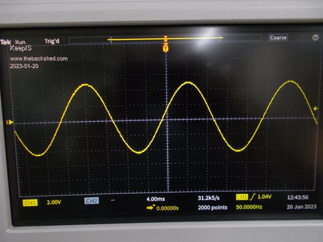

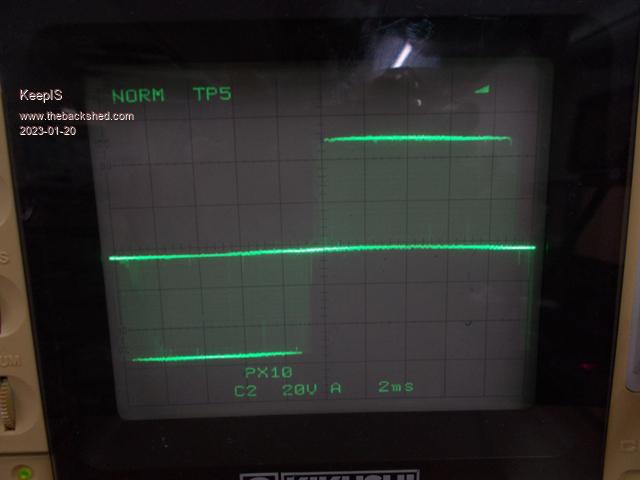

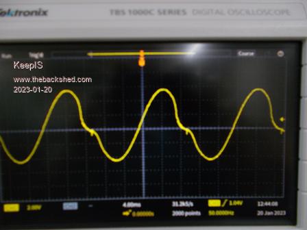

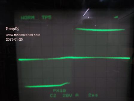

I decided to look a little further at the effect of these crap Heat Guns on Low.
This was after finding that a big UPS (CHASEPOWER) that I use for the computers causes a slight flat top on the AC output?? When it's only supplying 200 watts to the PC's. It does not seem to cause any problems, and it's not headroom a the Inverter will run the Heat Gun @ 1.5kW and the waveform is as clean as a whistle.
Here is what it does to the AC, and the HI/LO drive to the transformer [before the choke].
Before I started, I grabbed two Black ring toriods, thanks to wiseguy for telling me they were almost the same as the blue ones, so I added two to the other 6 and got the 51uH value I was looking for, this makes the output of the choke a lot cleaner and the waveforms are even better with the Heat gun.
But if I use the E-core for more inductance, it's not as good, even with the E-Core on it's own. I really need to look more into this with bad loads - or not
The Heat gun draws about 800W on Low and causes the choke winding [57A cable] and the primary windings, same cable, to get quite warm very quickly.
Running at 1.5kw on High for 10 minutes only causes a slight warming of the 57A cable, the choke cores are cold and the secondary of the transformer appears to be cool. But 800 Watts from that crap waveform really heated up the 57A winding very quickly.
So 51uH choke, heat gun high @ 1.5kW
HI/LO drive to transformer.
800W of crap from Low Heat gun setting.  Sorry for poor focus, dam camera.
The HI/LO drive is not quite as bad as I thought, but there is concern there if the CRO got this correctly.

wiseguy
Joined: 21/06/2018
Posts: 1326
Posted: 04:21am 20 Jan 2023
I dont have a lot of time right now to do this subject justice but I will try to answer concisely.
When an inverter is idling with no load the sine pwm drive per 180 degrees is symmetrical and output is 240V for arguments sake. Now present a 2.4kW resistive load and the HF PWM peaks have increased their on time drive as required to overcome unavoidable circuit losses and the higher load.
Now lets put the same 2.4kW load with a half wave rectifier in series with the load - I am assuming a predominately resistive load, not a complex load for the moment. For half the sine wave the sine PWM drive has increased for the losses for the conducting half of the sine.
But the other half of the sine is unloaded and in my mind as the HFPWM drive is now greater than that required for true symmetry for the remaining unloaded half sine, the result in my mind will cause the flux to continue to ratchet up, in the direction of the unloaded half sine.
I believe the end result is a mixture of some toroidal core saturation and the servo loop for stable voltage comprimising drive to maintain the original 240V. Again in my mind this is why the lower half wave power required actually causes more wiring heating than a balanced load.
I dont have the time to emulate/prove/disprove my theory but a current probe should assist in the investigation. Of course a flux monitor in the toroid would be priceless.  I do have some analog hall sensors and have often thought about a saw cut in the toroid and inserting a sensor to finally reveal the inner workings of the inverter toroids.

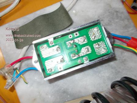

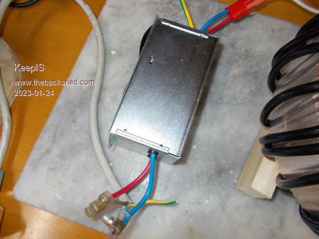

KeepIS
Joined: 13/10/2014
Posts: 2282
Posted: 01:14am 24 Jan 2023
I have not been using an AC output filter in bench testing. I have two 7A mains filters from the aerosharp (I think) and an EMI filter also from the 3kW Aerosharp, looks like it's from the mains in?
Very thick wire with dual stage toriods, 0.22uF across the AC in, 2 x 0.01uf to ground between the input and output toriods, and 0.47uF across the AC out.
I wanted to see how much difference this made to the part rectified waveform produced by the crap Heat Gun on Low.
First I tried one of the sealed 7A mains filters and it made some difference.
DC input current on the crap waveform went from 19.5A to 17.8A and the waveform on the CRO was better, the Primary waveform had far less ringing envelope around the large kink in the sinewave
I then tried the big dual filter, the DC current went down to 14A and the waveforms looked even better, it's a waveform I could live with.
The Heat gun is rated @ 240V 1.6kW / 800 Watt and I'm running it on 220V. The crap waveform is caused by a Diode in series with the heating element for low power.

So the filter removed 250 watts of heat from the Inverter driving the Heat gun on low. Current draw is almost normal.
wiseguy
Joined: 21/06/2018
Posts: 1326
Posted: 01:27am 24 Jan 2023
Mike, that is a rather amazing result & quite unexpected.  Given that they are just usually an overgrown common mode choke and capacitor set up I am at a bit of a loss to explain how it could improve the half wave loading so much.
But I have a couple of questions, was the AC feedback for voltage control before or after the filters - if I had to guess I would guess maybe after.
There is an extra 0.75uF across the mains is it possible that may be more the reason for the improved current ?
Although not fitted yet I also have the same filter that I had intended to employ in my final setup I am looking forward to see what it does with my inverter.
Cheers Mike
KeepIS
Joined: 13/10/2014
Posts: 2282
Posted: 02:52am 24 Jan 2023
I actually did this because of the fact that it's the distortion created by the load reflecting back into the transformer and I know it's nothing to do with PWM.
Why? because my High voltage inverter does not suffer from this, and it uses virtually the same EG002 board. The big thing missing is the Transformer.
The AC feedback is always connected right at the secondary winding of the transformer and the secondary CAP is across the same connection point.
So I though, what can I do the take the edge of that distorted waveform, I thought a double EMI filter may help knock some off the HI frequency transients, if it does, then it warrants more work on the type and construction of EMI filter I use with a view to doing more than just limit the EMI, but also precondition the transformer secondary connection to the nasty outside world.
The extra 0.75uf makes zero difference. I tried that again yesterday with various incremental values. I wanted to see if using a higher capacitance and lowering the Resonant frequency of the transformer down to 17Hz would remove more of the 20kHz waveform noise, after all, were all talking about the Choke and reflected capacitance  filtering this out to a degree, but NO, it did nothing and it increased the effects of the Heat gun????
So, is this another one of those contribution reasons why some inverters on the edge go bang, and others don't?
BTW just tested the Band Saw again with all changes, 229 Amps on start, almost 12kW and allowing for the voltage to sag really low, which they don't, even at 400A on 24V. I have 1m of ZERO gauge between the batteries and the DC input on the inverter board and only a 480A DC switch in between for testing.
