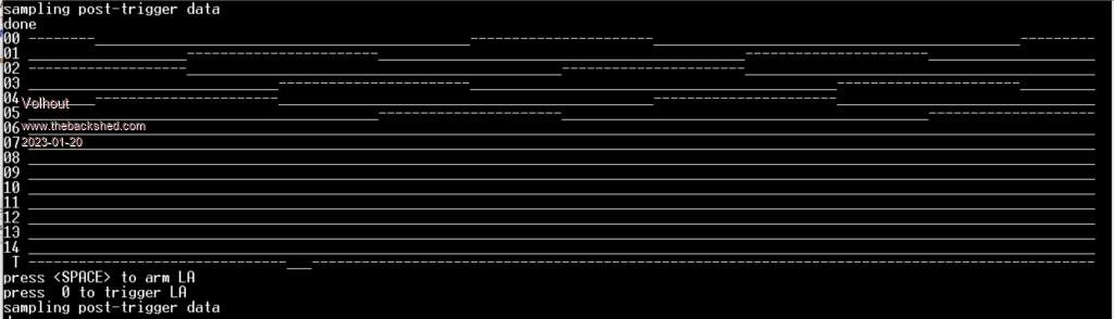

Hi Peter,
I have a few questions regarding the DMA. Not that it does not work, but I am not sure how to set it up correctly.
1/ Create ring buffer
  Anything smaller than 256 does not seem to work (32, 64, 256) despite being a power of 2
2/ PIO DMA_IN pio, sm, nbr, data%() [,completioninterrupt] [,transfersize] [,loopbackcount]
When you use a ring buffer, do you need to feed it with "nbr" ?
3/ PIO DMA_IN pio, sm, nbr, data%() [,completioninterrupt] [,transfersize] [,loopbackcount]
When you use a ring buffer, does it ever reach "completioninterrupt" ?
I hope I get this right
 'The DMA should take (2*length 32 bit) samples, this takes up (1*length 64 bit) ring buffer
 'It should never trigger the ReadyInt interrupt (ringbuffer). Not sure if we need specify
 'the number of samples.
 PIO DMA_IN 1,0,2*length%,packed%(),ReadyInt,32,length%            'start DMA with ring buffer
I tried loopback parameter:
length
2*length
4*length
8*length (number of bytes the DMA buffer is in size)
ERROR: Data alignment error
length-1
2*length-1
4*length-1
8*length-1 (number of bytes the DMA buffer is in size)
ERROR: not a power of 2
I have no clue what to do next...

Posted: 09:36am 20 Jan 2023
Getting there, need to re-align trigger to the centre. All excited !!!
Trigger is parallel wired to channel 15.

 endpoint%=endpoint% / 4                                 'convert to 32 bit values for use in data%()
 trigger%=(endpoint%-length%)                            'recalculate trigger from end capture
 If trigger%<0 Then trigger%=trigger%+2*length%          'look at wrap around
 'Print trigger%
 'calculate view window based on screen size (width = 128 chars)
 start%=trigger%-64
 stop%=trigger%+63
 'output to serial port screen
 For j=0 To 15 'check 15 bits GP0..GP15
   mask%=2^j 'mask GPx
   If j=15 Then 'assume GP15 also wired trigger
     Print " T ";
   Else
     Print Right$("0"+Str$(j),2)+" "; 'channel number
   EndIf
'now we select 3 cases depending on start and stop. This must be optimized later
'case 1: view window inside array boundaries
'case 2: start% outside array boundaries
'case 3: staop% outside array boundaries
'case 2
If start%<0 Then
     For i=start%+2*length% To 2*length%-1
       Print a$(((data%(i) And mask%)=mask%));
     Next i
     For i=0 To stop%
     Next i
'case 3
   ElseIf stop%>2*length%-1 Then
     For i=start% To 2*length%-1
     Next i
     For i=0 To stop%-2*length%
     Next i
'case 1
Else
     For i=start% To stop%
     Next i
   EndIf
   Print
 Next j
 'clear array (maybe not needed)
 Math set 0,packed%()
End
'-----------------------------------SUBS MMBasic --------------------------------
'stops and re-initializes the PIO to be ready for next DMA
Sub ReadyInt
 PIO STOP 1,0
 PIO init machine 1,0,f,p,e,s,0     'start address = 0
 Print "done"
End Sub
P.S. Peter. Is it better to standardize on RX and TX and not mix with IN and OUT ? Or do you have a reason to use these names ? Standardize on IN and OUT is another option.

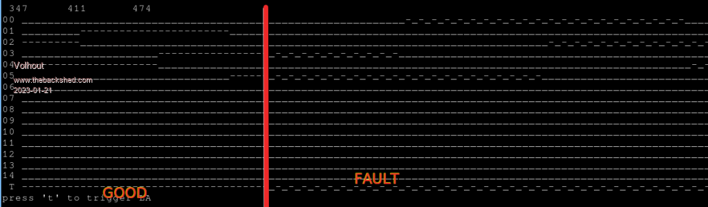

Hi Peter,
I hope you can help me. Attached ZIP has 2 programs. LA_4.bas and LA_5.bas.
The program LA_4.bas is the logic analyzer that works as I expect. If you type "t" repeated, it shows the sampled data from the 15 input ports of a picomite.
Using V50707b7
If you connect GP22 to GP15 you also see the trigger.
Then program LA_5.bas
This program shows corrupted data in the last 128 samples of the data%() array (alternating correct value, next sample 0). Only the last 128 samples.
If you change the value of "samples%" from 512 to 256, or 1024, the last 128 samples show this behaviour (the numerics show the start pointer, mid pointer, and stop pointer of the displayed values).
You may have to type "t" a few times. When start%<0 or stop%>samples%-128 it is visible,
commented out is a section that displays the data that is in the packed%() array. And also the packed%() array shows this artefact. The last 64 values seem corrupted.
And I have no idea what is going wrong. The PIO code is the same, the DMA configuration is the same. The levels of the signals on my breadboard are correct.
I have looked for hours, and cannot find what is going wrong. Have stripped LA_5.bas back to almost identical to LA_4.bas. I have no idea.
I hope you can spot what is going wrong.

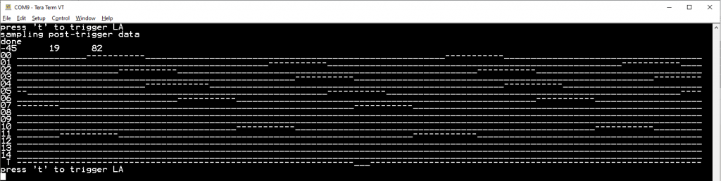

Playing with LA4.bas found an odd thing with PWM Sync. It doesn't start PWM channel 4 and stops it if it was already running.
Here is what was added to LA4.bas
'logic analyzer framework research program
'samples GP0...GP15 with triggering on GP22
'uses PIO and  ring buffer under DMA.
'requires V50707b7 or newer (function names changed)
' Test signal: Three phase motor drive - picomite V50706+
' runs autonomously on GP0...GP5 50Hz
SetPin gp0,pwm  'CH 0a
SetPin gp1,pwm  'CH 0b
SetPin gp2,pwm  'CH 1a
SetPin gp3,pwm  'CH 1b
SetPin gp4,pwm  'CH 2a
SetPin gp5,pwm  'CH 2b
SetPin gp6,pwm  'CH 3a
SetPin gp7,pwm  'CH 3b
SetPin gp8,pwm  'CH 4a
SetPin gp9,pwm  'CH 4b
SetPin gp10,pwm  'CH 5a
SetPin gp11,pwm  'CH 5b
Fpwm = 50
PW = 100 / 6
PWM 0, Fpwm, PW, PW - 100, 1, 1
PWM 1, Fpwm, PW, PW - 100, 1, 1
PWM 2, Fpwm, PW, PW - 100, 1, 1
PWM 3, Fpwm, PW, PW - 100, 1, 1
PWM 4, Fpwm, PW, PW - 100, 1, 1
PWM 5, Fpwm, PW, PW - 100, 1, 1
PWM sync 0, 100/6, 200/6, 300/6, 400/6, 500/6
Pause 20
'----------------------------------- LA code PIO --------------------------
This is the output
Having already been caught by a faulty GP0 (needs a pulldown resistor). I have tested GP8 & 9 to verify that they function properly with DOUT, DIN and PWM.
This also occurs at the command line, not just in the program, which shows exactly what I see on the scope.
Edit
The pin numbers for PWM7 seem to be cross linked to other pins.
PicoMite MMBasic Version 5.07.07b7
Copyright 2011-2023 Geoff Graham
Copyright 2016-2023 Peter Mather
> pwm 6, off
> pwm 7, off
> setpin gp15,pwm
> setpin gp14,pwm
Error : Already Set to pin 20
> setpin gp13,pwm
> setpin gp12,pwm
> setpin 20, off
> setpin 19, off
> setpin 17, off
> setpin gp14,pwm
> setpin gp15,pwm
Error : Already Set to pin 19
Found when using this:-
Fpwm = 50
PW = 100 / 8
For n%=0 To 15 'Set the PWM pins GP0 to GP15
 PINn = MM.Info(pinno "GP"+Str$(n%)):Print "GP";n%,"Pin";PINn
 SetPin PINn, PWM
 If n% And 1 Then PWM n%\2, Fpwm, PW, PW - 100, 1, 1
Next
PWM sync 0, 100/8, 200/8, 300/8, 400/8, 500/8, 600/8, 700/8
Pause 20
It works up to PWM6 but not PWM7 - GP14 & GP15.
Edited 2023-01-21 14:14 by phil99

Posted: 06:54am 21 Jan 2023
Peter,
Thonking about the artefact in LA_5
Looks like from a certain location in the circular buffer the dma is writing fifo data(32-to-64), in stead of packing it(32+32-to-64).
Maybe the location where the buffer is in Ram is the cause.
Or the packed array and data array overlap, the memory unpack overwrites part of the packed array.
Edited 2023-01-21 17:52 by Volhout

@phill,
Do you have an option set for system i2c. That may reserve gp pins.

Posted: 08:00am 21 Jan 2023
Volhout,
the location where the problems start is &h81 .

Posted: 08:42am 21 Jan 2023
Phil
Thanks for the report, cut and paste typo
"enabled=16" should have been "enabled|=16"
Will be fixed in next beta. Now to look at Volhout's issue - might be harder
