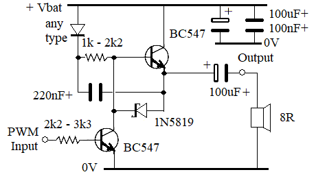

Edit. Retested at 2.9V. PLAY WAVE distortion vanishes when PLAY VOLUME is below 90%.
PLAY SOUND is free of distortion with all 4 tones at Volume 24
Meanwhile here is a revised version of the transistor circuit. Two components added to improve performance below 3V.
No values are critical. Capacitor values are suggested minimum. The 1N5819 could be any Schottky diode. Used BC547 just because you have them.
Edited 2023-03-26 12:41 by phil99

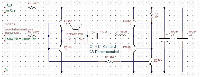

G'day Tom, as requested, full circuit diagram for Emitter-Follower Bridge Amp.
Have a play and see how it goes, as others have suggested, there are numerous ways to go with audio amplification.
Only issues known are fairly high current (not as bad as some / worse than others) and no voltage gain / volume control so your speaker sensitivity will determine the volume level.
As indicated, L1 and C1 are optional filter, not mandatory and I think 68uH might be overkill, C3 recommended as without PWM the current is minimal.

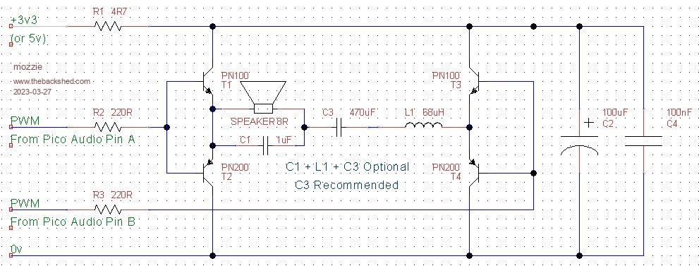

G'day all, after a bit more tinkering, this might be as simple as its possible to get and still output around 2v across an 8R load from 3v with as few components as possible.
You will need to invert the second PWM output:
POKE SHORT &h40050000,&h09
Hopefully this won't stuff anything else up
This gives about 25% more output than the more complicated version, will only work with mono signal sent to both outputs. Also allows shutdown:
POKE SHORT &h40050000,&h01
Signals now in phase so no output.
Signals 180 out of phase so audio output.

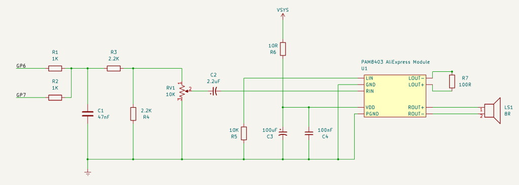

I know you've pretty much dismissed the PAM8403, but (a) I'm like a dog with a bone, and (b) I'm working at my own pace and at least two pages back in this thread.
I'd appreciate comments on whether I have made the correct changes to the schematic that have been suggested or whether my placement of resistors and capacitors is the result of a fever dream.

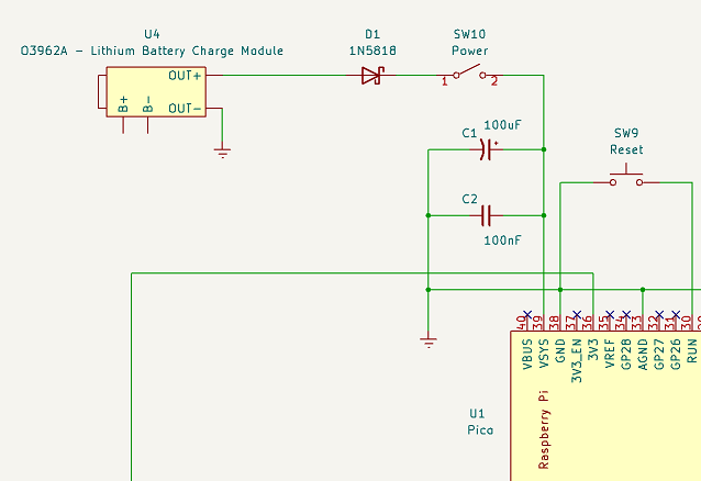

Also is this the correct capacitor arrangement that has been suggested on the power supply to my project:

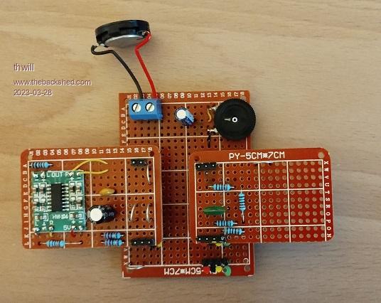

All of this presupposes that the schematic and actual device match .

Posts: 8973
Posted: 07:43pm 27 Mar 2023
Looks ok, I think.
If you find that the volume control is a bit touchy then try adding a resistor in series with C2. That should reduce the gain of the amp, I think. Try anything up to 120k - the higher the value the less gain you should get.
The power supply looks ok. If you only want one USB socket exposed you can get a 5V supply to the charger module from VBUS. Just connect it to In+ on the charger. Note that battery -ve does not go to GND, it has to go to B- on the charger.
