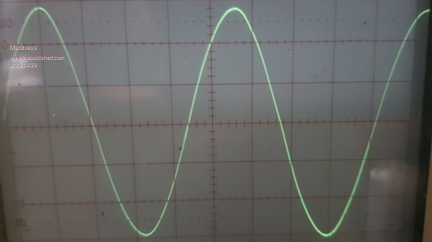

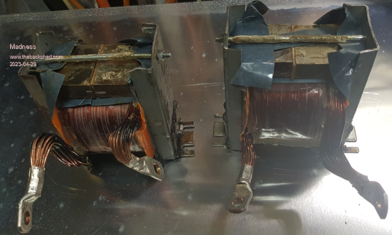

Here is the cause of my problems.
With both of these fitted the inverter works fine just as an inverter making AC power. They might look small but they weigh about 10KG each. The GTIs don't like them, with 2 smaller chokes I get this sine wave.
This is with just one GTI connected back feeding 500W with no AC loads. The offending chokes are made with 2 of the large aerosharp choke cores joined together and 12 turns of 31 1.6 diameter wire. My inductor meter may be wrong but it shows 80mH.
The chokes that are working are 2 of the small aerosharp chokes joined together with 6.5 turns. I can't run it hard with these as the wire in them is only about 10mm square.
The next step is to remove the windings from the 2 big chokes and try different numbers of turns of temporary wire. When I find what works I wind them again with enamel wire, it will be a lot fewer turns so I will be able to get a much larger wire cross-section.

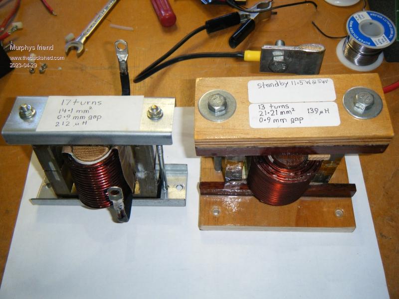

If its any help, the choke on the right is what I'm using in my dual stack nano inverter:

Posted: 01:34pm 29 Apr 2023
  Madness said
What is the core of the choke you are using?
Large aerosharp choke x 2 made into an E core.

Posted: 01:39pm 29 Apr 2023
  KeepIS said  I might be having a seniors moment so ignore me if not relevant, but the choke values appear to be a tad high to me.
Easily changed by fitting a bigger gap spacer.
Actually, that inverter is in pieces at the moment so I will try your suggestion.
Choke function has been - is- mostly a mystery to me so I'm still experimenting. What I did find was that ferrite core chokes did not do well at all in my opto isolated nano inverters.

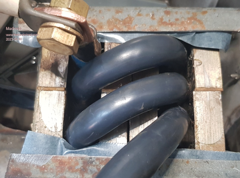

@Mab1 Over the past few months I have done a lot of reading on here before building this new inverter to get myself back up to speed as it has been around 5 years since I built any inverters. I was under the impression from what I read that the higher value inductor you have the better, clearly that is not the case.
What I have done is remove the windings from the choke cores. This was quite easy as the windings were wound onto a close-fitting 3D-printed former. I had some 95mm square battery cables on hand that I have wound on the cores with 3 turns on to the double large Aerosharp cores. My meter says 0.01mH, so my previous post should have been 0.08mH.
I have 2 of these one on each side of the toroid primary. This is working right now with 2KW back-feeding and no load on the inverter. It is running with a near perfect sine wave. There is no sign of any glitching, disconnections or any other gremlins.
The inverter is run near silent, I don't have any filters on the AC out. There is a very slight trace of the 20khz switching that I will ignore.
I will let it run for most of the day and if all is well I will reassemble the inverter properly and then I can test it under full back-feeding load. ATM I am thinking I have succeeded in what I set out to do here, which is to get a Nanoverter back-feeding successfully.

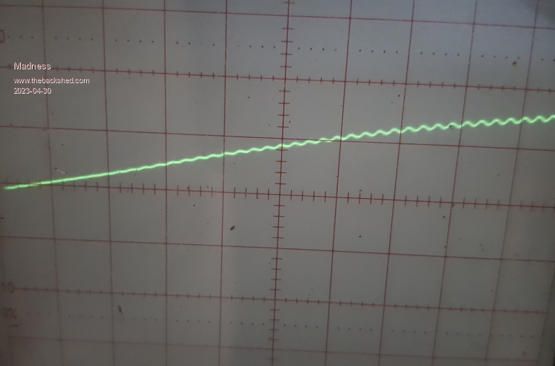

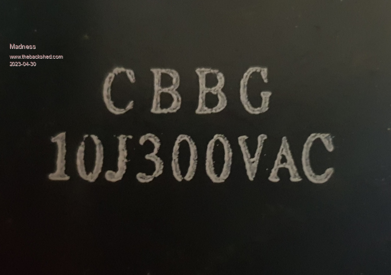

Yes, there are 2 chokes and I have 2 aerosharp 10J300300VAC capacitors across the toroid secondary. My meter says 4.6uF each and they are in parallel. I checked the resonance and it is was around 78hz with the previous chokes fitted.
The 20khz ripple is less than 5V, the transformer is 1:9 so this would be under 0.5 volt on the primary. Each line is 50V.
I checked old faithful and the ripple was a bit more than double this, it has filters on the output and as mentioned this new inverter has no filters at all.

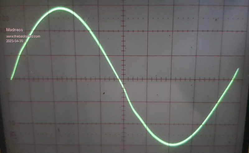

I have reassembled my inverter with the new choke configuration after running most of the day very successfully with the power board outside the inverter and the chokes half in and half out like it had been disembowelled. I will switch the house and GTIs over to it first thing in the morning and see if it runs as well as it did today.
Tomorrow I will see how it goes with loads but I am very happy with the wave-form as it is, Klaus it would be well worth giving the code from here a try. You can load it onto another Nano and just swap the Nano with the one you have installed now. Then you can easily change back anytime if want to. From my experience it might be well worthwhile taking a look at your chokes too.
