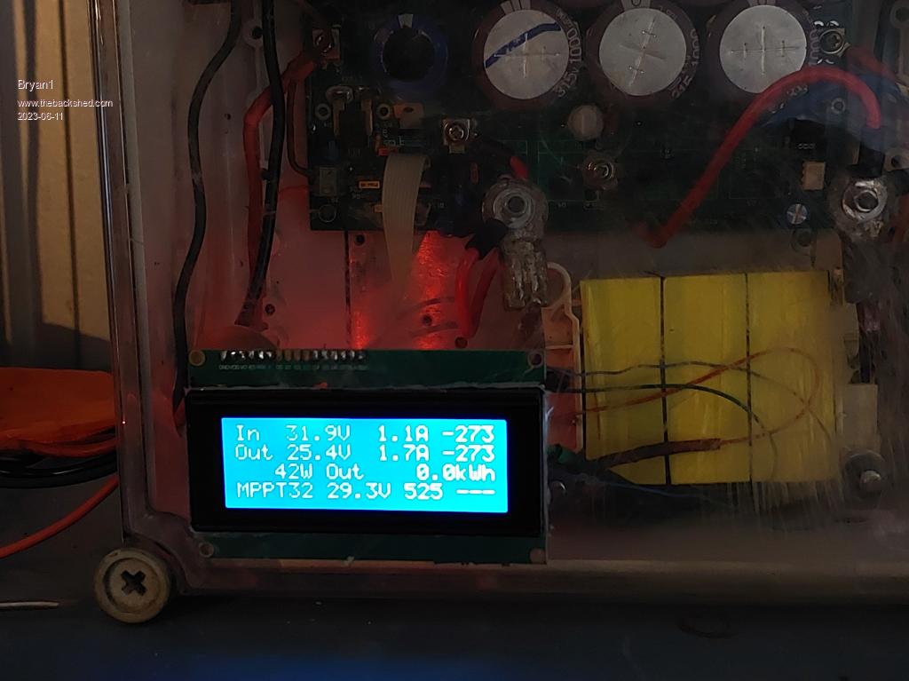

R1 is the current limit for the 5V drive from the Nano PWM output into the TLP250 input (LED)
Maybe remove the TLP250 and see if there is any pulse, at 20kHz approx., on either end of R1.
If there is when TLP250 is removed and there is zero when TLP250 is installed then
the TLP250 is suspect.
No pulse with TLP250 removed suggests the nano is toast.
But the R1( 620R ) resistor should have a signal on the nano or 10 pin connector side,
referenced to ground. R1 limits current to about 8mA so it is well within the
drive of a nano pin.
The display you showed above with "MPPT46 29.3V 10 "
means its in mppt mode, 46 seconds into the 60 second cycle where it checks again
for a reason to go into mppt mode and the 10 means the PWM pulse with is 10 cycles wide.
10 cycles is about .62 microsecond and should be easy to see on the oscilloscope

Bryan1
Joined: 22/02/2006
Posts: 2297
Posted: 06:32am 11 Jun 2023
G'Day Guy's,
           Went over to Rodger's this morning to help me out getting this MTTP working. The track going to the TLP250 was gone and with that cap blowing would of been the cause.
Then we noticed the R13-12-12 chip was a bit wobbly and found the third pin had come a drift and Rodger put some legs on a smd chip to fix the problem.
We tested that choke I made and it came out at 51.7uh so not bad for a first attempt.
We also used a new nano and the old nano got loaded with the serial LCD code for Rodger to play with.
We had a look on the scope at the fet drive chip and saw some low activity then ramp up so the soft start looks like it was working.
We set it up with 2 solar panels and a couple of car batteries in series, calibrated the sensors and the voltages and when a glimpse of sun came it was working
So got home and connected it up
I do need to get a couple of 10K NTC's so the temp is open circuit for now,
So where do the fans connect as no connections appear to be on the board.
Cheers Bryan

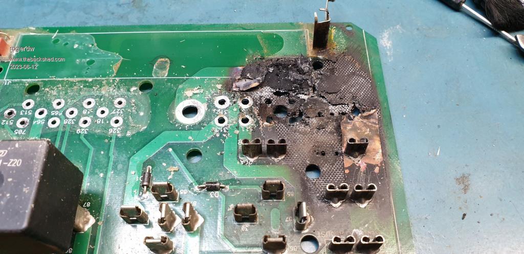

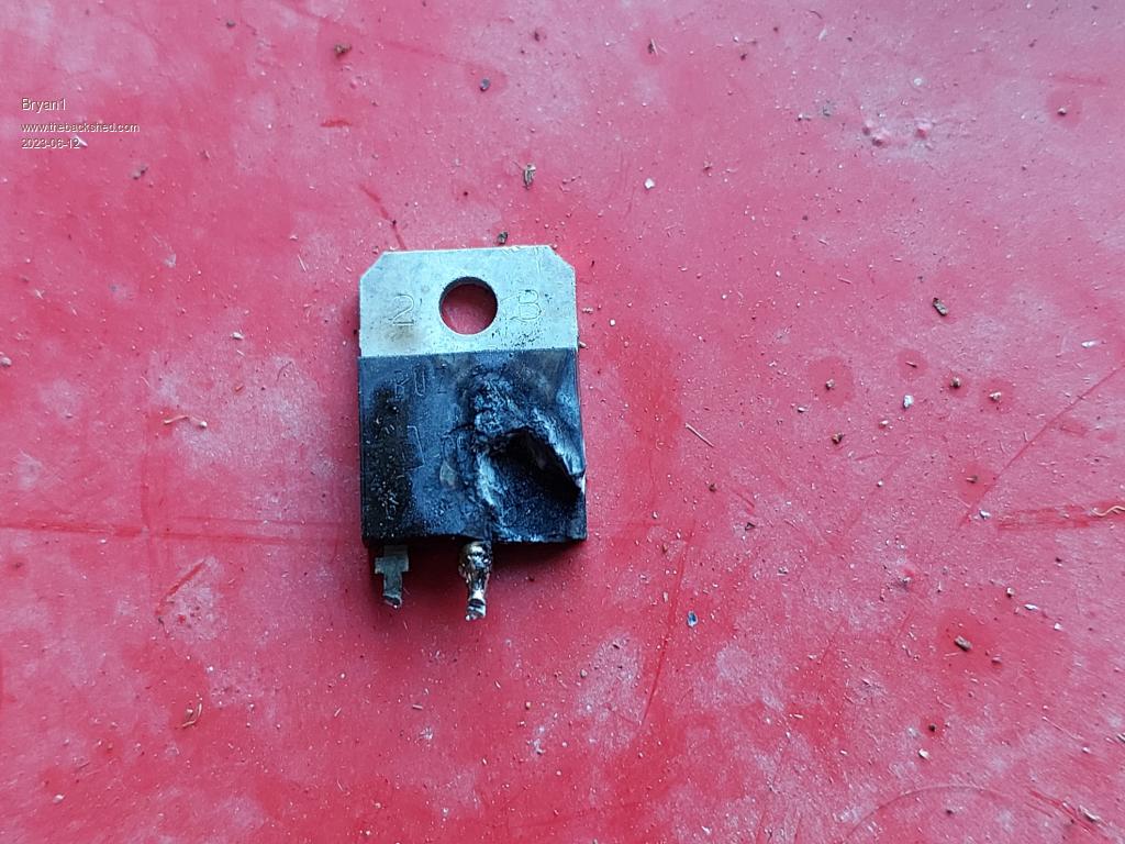

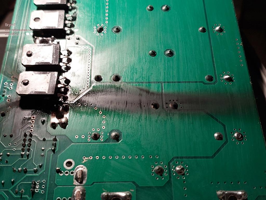

Posted: 05:00am 12 Jun 2023
Well guy's started the MTTP up this morning and after the slow start CABOOM number 5 fet put on a nice dying show with red hot patch's and filling the box with smoke.
Now this should get me into the blown fet club
The board is toast so I'll order all new parts for the next build.
rogerdw
Joined: 22/10/2019
Posts: 957
Posted: 07:08am 12 Jun 2023
Well that's a bit disappointing Bryan, after yesterdays effort I thought you were home and hosed.
What configuration of panels were you using at the time  ...  and did you see what voltages and current were showing before the bang?
And I wouldn't write it off yet either  ...  that damage doesn't look too bad to me, unless the other side is all burned. Give it a bit of a clean with acetone or even metho  ...  most of that black will buff out.
This is a proper burn up  ...  new board $8,000!!!
Cheers,  Roger
Bryan1
Joined: 22/02/2006
Posts: 2297
Posted: 07:37am 12 Jun 2023
Roger when I turned it on it was only showing 1 amp coming in then it slowly ramped up and when the incoming amps hit 8 amps it went bang, no scoring on the heatsink so it didn't short out on that.
I set it up on my 12 volt array only to find no amps coming in but the mttp was showing on the LCD. Now when I probed that 4.7K resistor under the nano zero volts was shown so I soldered up a new nano and found it was the same no output on that resistor. I did find a TLP250 at my feet so I put that in but still no voltages going or any activity.
So i do think this board is toast as the pads on fet 5 are all stuffed.

Posted: 11:07am 12 Jun 2023
Would have expected the fet next to it to be burnt as well, but it looks untouched why?
something else is going on.

Posted: 12:38pm 12 Jun 2023
Are the fets same?
What fet Buz...?
Pozdrav iz Srbije
rogerdw
Joined: 22/10/2019
Posts: 957
Posted: 11:37pm 15 Jun 2023
Pretty sure they are all BUZ341  ...  200V 33A 170W 70mOhms

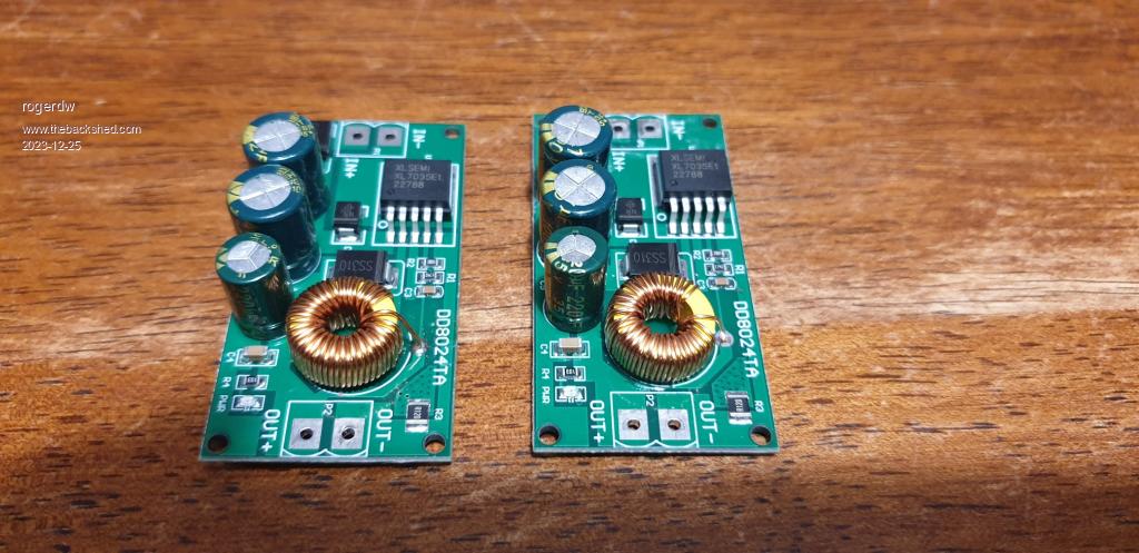

rogerdw
Joined: 22/10/2019
Posts: 957
Posted: 02:11pm 24 Dec 2023
Hi Bryan, I'm with Klaus and Phil  ...  it would be much easier to use one of the cheapie DC-DC converters.
I can help you out  ...  I have a couple spare ones here you can have  ...  1A High-Voltage DC-DC Converter DC 10-80V to 12V
You should still have my number, otherwise send me a pm.
Merry Christmas.
Cheers,  Roger
