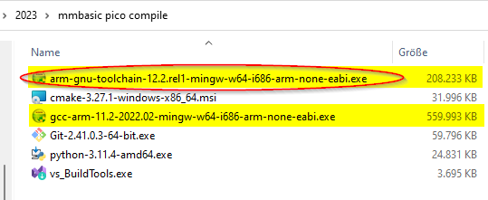

homa
Joined: 05/11/2021
Posts: 651
Posted: 03:54pm 02 Aug 2023
  matherp said  ... and have had to set up the development environment from scratch ...
Could you please publish and describe these steps? Thank you.
Posts: 11662
Posted: 04:10pm 02 Aug 2023
Sorry, but as I've said many times before it is not practical to provide advice and support for setting up a build environment, there are too many moving parts and variations in platforms.
All the details are in the Pico Getting started manual (manual steps) but you need to load SDK 1.5 and not 1.5.1 and you need compiler version 12.2.1
homa
Joined: 05/11/2021
Posts: 651
Posted: 04:20pm 02 Aug 2023
OK, I will have to try it myself on my new PC win11, thanks for the version notes.
homa
Joined: 05/11/2021
Posts: 651
Posted: 06:46pm 02 Aug 2023
  matherp said
... and not 1.5.1 and you need compiler version 12.2.1
https://datasheets.raspberrypi.com/pico/getting-started-with-pico.pdf
9.2.2. Alternative manual installation
 WARNING
Manual installation of the toolchain under MS Windows is complicated and not recommended.
To build you will need to install some extra tools.
• Arm GNU Toolchain (you need the filename ending with -arm-none-eabi.exe)
• CMake
• Build Tools for Visual Studio 2022
• Python 3.10
• Git
Download the executable installer for each of these from the links above, and then carefully follow the instructions in
the following sections to install all five packages on to your Windows computer.
https://developer.arm.com/-/media/Files/downloads/gnu/12.2.rel1/binrel/arm-gnu-toolchain-12.2.rel1-mingw-w64-i686-arm-none-eabi.exe?rev=4eb1b321a6f44ca78be67eb9cef8b37a&hash=AD35FDA3E92F4D716B9C4FCF21A9B27F
~ 208 MB
https://github.com/Kitware/CMake/releases/download/v3.27.1/cmake-3.27.1-windows-x86_64.msi
~ 32 MB
https://aka.ms/vs/17/release/vs_BuildTools.exe
~ 3,7 MB
https://www.python.org/downloads/release/python-3114/ (https://www.python.org/ftp/python/3.11.4/python-3.11.4-amd64.exe)
~ 25 MB
https://github.com/git-for-windows/git/releases/download/v2.41.0.windows.3/Git-2.41.0.3-64-bit.exe
~ 60 MB
I need help once again!
Is this really the right compiler version? Only 208MB compared to the old version with 560MB?

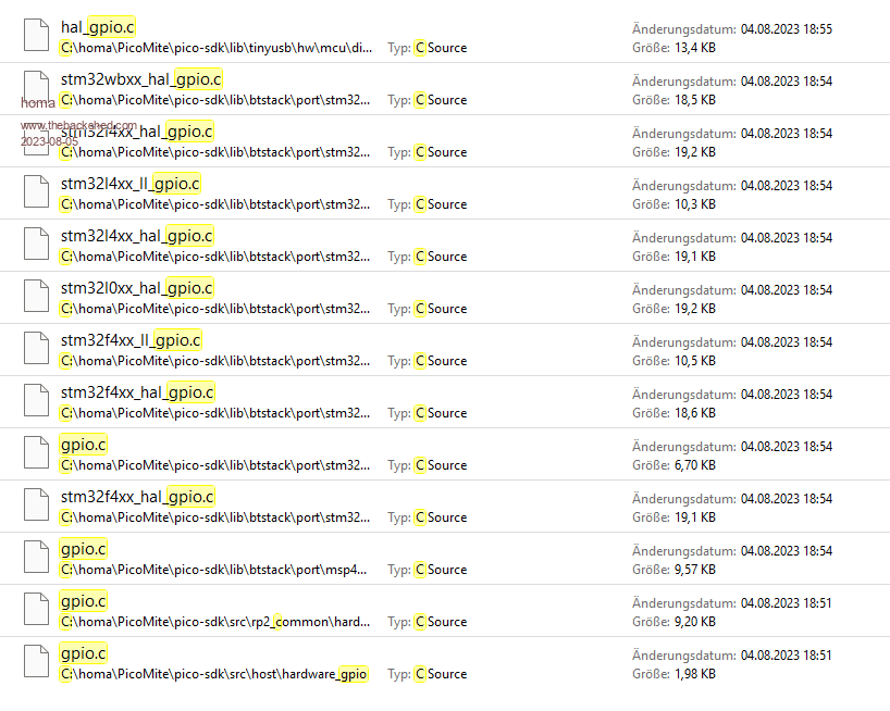

NB: This should be built against pico-sdk version 1.5 with gpio.c replaced with the attached.
help requested, which file of these in the pico-sdk needs to be replaced?
