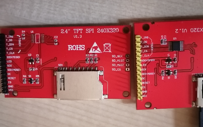

two things I've noticed so far.
1. GUI CALIBRATE stays foreverin the first page...
Has anyone gotten this to work yet?
2. Playing "MOD" files is very, very quiet, so it's hardly noticeable.
would it help to change R6 R7 27K with lower once?

  Martin H. said  two things I've noticed so far.
It works just fine on mine, I would check a different display if you have one, I've certainly had one with broken touch before now ... I assume your display does have touch, I believe it is U2 on the back of the display module ?

Martin H.
Joined: 04/06/2022
Posts: 1542
Posted: 10:51am 03 Oct 2023
  Bleep said  Hi Martin,
Just tried screen calibration and it works fine, when you say "stays forever in the first page..." do you mean it never moves on when you press on the top Left target? If that is the case it sounds like your screen has a problem with the touch, could check the soldering of the screen connector, make sure you don't have a dry joint.
Thank you Kevin
I have never set up a touchscreen on the Pico, so I may have done something wrong.
The crosshairs stay at the top left and he wants me to press and hold, but nothing happens. I tried this with 2 different displays so I'll probably have to check the soldering points

Posts: 2981
Posted: 11:04am 03 Oct 2023
Hi Martin, All,
Re. The calibrate locking up.
Firstly, try shorting out the solder pads on the TFT’s onboard regulator so there is no voltage drop to the touch controller chip.
Secondly, it ‘could be’ the old MISO problem, you could try cutting the touch-miso pin off the TFT display
Thirdly, check the option settings and make sure the touch options are set correctly.

Posts: 6101
Posted: 11:11am 03 Oct 2023
Last time I used touch, it required a "sharp" tip to activate the touch during calibrate. Nothing like what I am used to in operating my mobile phone.
Diagnosis: doe the SD card work ? It shares lines with touch.

Martin H.
Joined: 04/06/2022
Posts: 1542
Posted: 11:15am 03 Oct 2023
Hi Tom,
you are right .. the second display has no U2 (U1 in this case) so there will be no Touch at all.
But the 2.8 ' Display, which I connected first has it. But this one has a crack in the Display so it is possible, that touch is broken.
I had already ordered a new one, so I'll try it when it arrives.

Posts: 4395
Posted: 11:41am 03 Oct 2023
  Volhout said  The new Game*Mite software image reserves 128kbyte for MODBUFFer. And the whole A:/ drive is pre-filled with sample games and menu software.
Correct.
