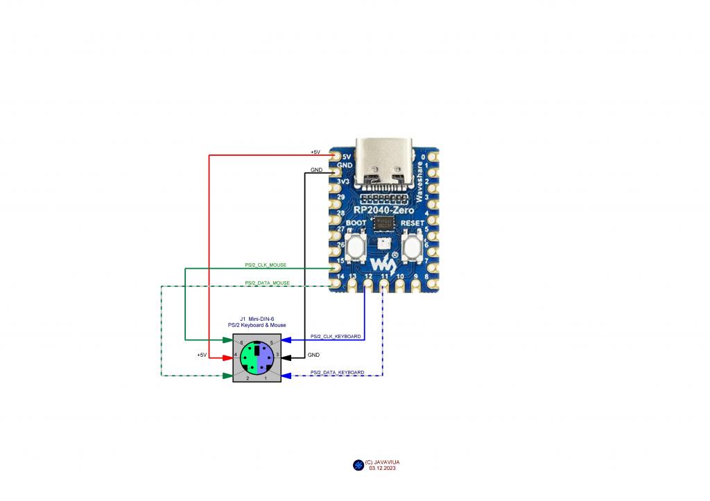

javavi
Joined: 01/10/2023
Location: Ukraine
Posts: 568
Posted: 10:46am 13 Jan 2024
Hi all
To connect a USB keyboard to PicoMite, I use this USB-PS/2 converter adapter. I assembled it according to a simple scheme, without “extra” parts. It’s even possible to connect an additional mouse via the PS/2 interface, but I don’t know how?
I got the firmware for this adapter here:
https://github.com/No0ne/ps2x2pico
It would be nice to update this firmware with a software USB Hub...

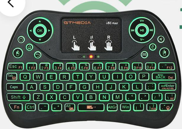

Posts: 2981
Posted: 10:35pm 20 Jan 2024
Hi All,
I found my wireless kb I used to use when I was working, it’s been sitting in my old tool bag for over 5 years,  I decided to test it on the HID2CDC and of course the battery is dead flat, after charging for 30m I was able to get it to power up.
It’s one of these tiny cheap as crap (and crap as crap)
I can confirm that the wireless keyboard does indeed work on the HID2CDC, however I was getting multiple key presses for each key, like the autorepeat triggered immediately, I had to quickly tap the keys to get single characters. I will let it fully charge or find a new battery as this one is looking sad and try it again, I also should try on my PC to see if it’s the keyboard or something with the HID2CDC.
Watch this space,
EDIT***
After a day of charging the battery fully, that fast repeat has gone, HID2CDC works fine with wireless (dongle based) keyboards
