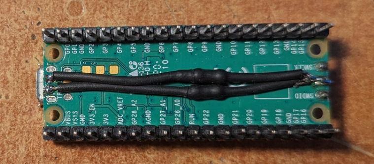

With your hubs that don't work with the Pico, please could you try the following:
Add a 15K resistor from TP2 and TP3 on the bottom of the Pico to GND
This is part of the spec of a USB host.
I was having the issue that enumeration failed after a reset of the Pico but worked after a power-up. Adding the resistors solved the issue

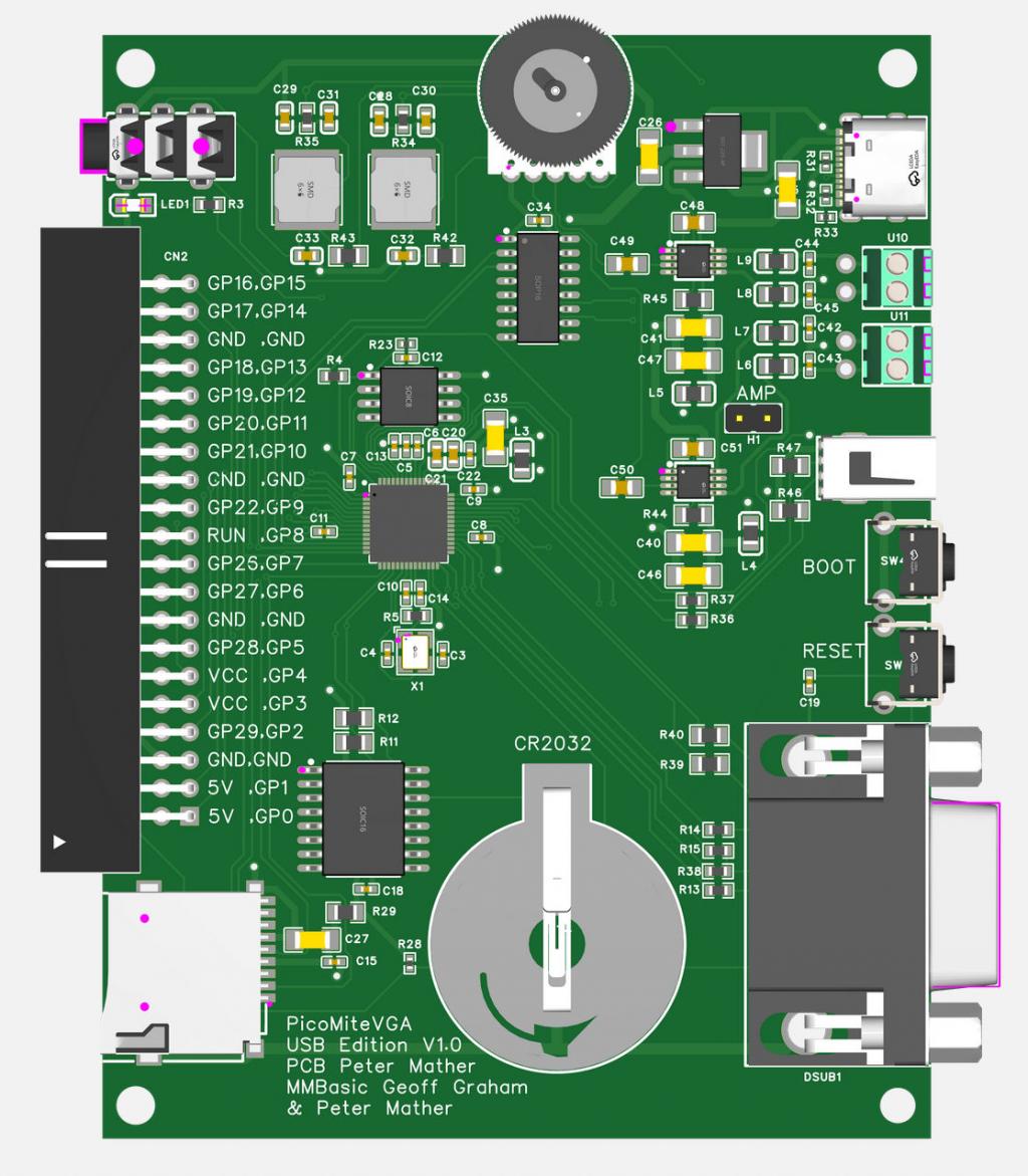

Here is the final version of the PCB which is now in production
Changes are:
Different audio jack - apparently the original didn't have the temperature rating for their soldering process
Different CR2032 saocket to better clear the DS3231 chip
15K pulldown resistors added to the USB host port
Heartbeat led re-located to the "front"

  matherp said  With your hubs that don't work with the Pico, please could you try the following:
That is very interesting! That could also explain my problems with the HID2CDC! I really must try this out! Thank you Peter!

P.S.: Unfortunately my HID2CDC still does not work despite resistors...

Peter
Looks good.
Some more points for improvement. The option list is still missing from the PCB.
The coding is not yet available for all components, as is the case for all ICs and various components.
Place some more information such as L, R, GND and other connectors at U10 and U11 or the soldering location.
For the 40 pin main connector, is it possible that 3V3 is better than VCC?
I see that the Vref power supply also has better interference suppression through L3 and why is this not present on the main connector?
A possibility would be to replace VCC -> Vref and a GND pair with a 3V3 pair, leaving 3x 3V3 pins and a Vref and the layout remains fairly standard and no longer a shortage of 3V3 pins?

Next revision maybe.....

@Peter,
About the boards, what do I need to provide myself ? The 40 pin I assume ? All other TH parts ? Potmeter/VGA/vertical USB/ screw terminals ?

  Quote  About the boards, what do I need to provide myself ?
Nothing except a battery, they come ready to run
