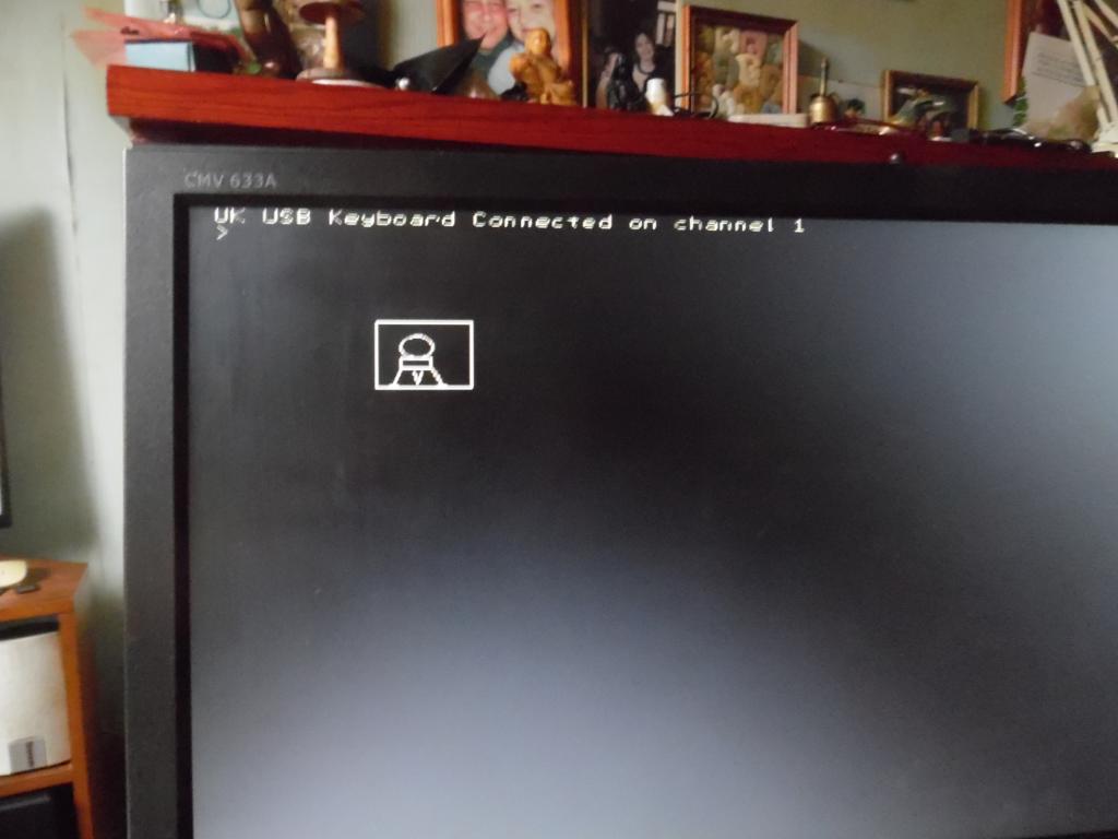

The following are screen shots of the PicoMite and PicoMiteVGA loaded on to the same Waveshare board I was trying to load the USB and VGAUSB versions.
Hans ...
I get this on connecting usb to usb to ttl converter which 5v powers rpipico vbus. it recognises usb kb dongle and it was option keyboard uk.
Hans

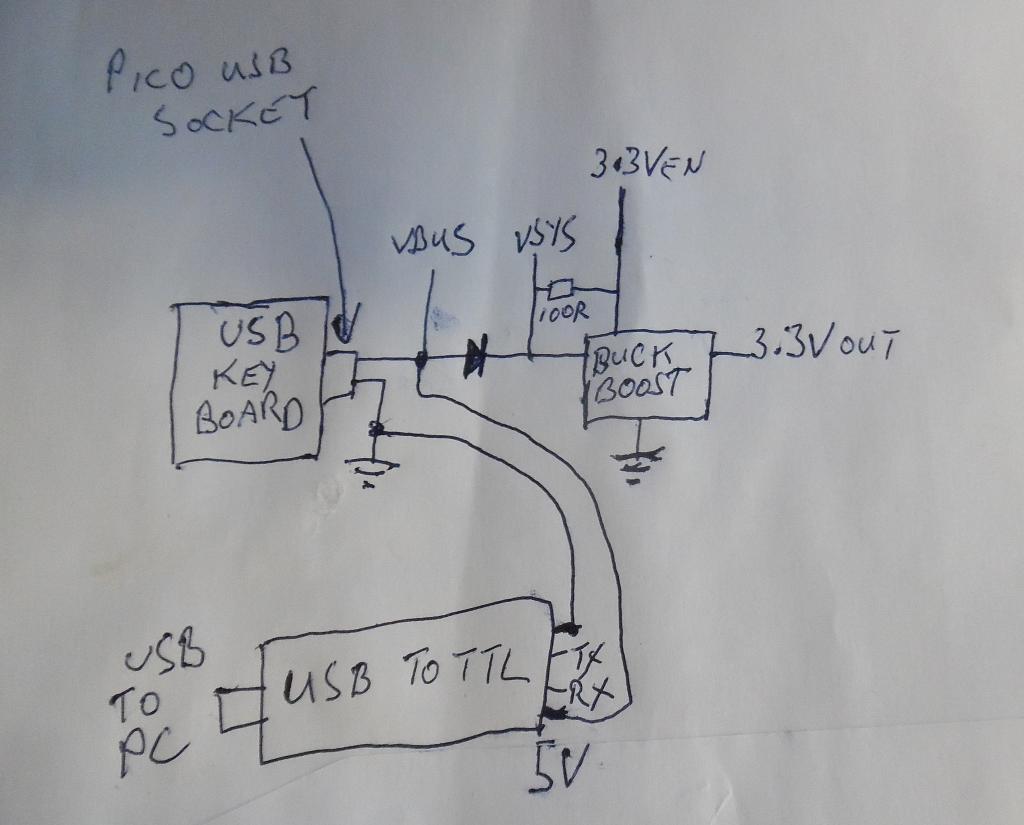

Hi Mick, It's simple so sharing
download usb version and unzip
press button and hold down then connect usb lead and win bing and a new drive.
copy the uft you downloaded and expanded
paste into new drive, the drive will disappear
connect usb keyboard , can be a wireless dongle
the pico need 5v on vbus that it may have got from usb or a 5v reg.
if you connect a usb to ttl converter to use for connecting to windows for teraterm or mmedit or xterm then the 5v on the usb to ttl pin wires to vbus and the pico is powered.
think of the usb to ttl connected to what where the ps2 keyboard pins.
the 3.3v out pin on the pico still gives 3.3v

Posts: 2807
Posted: 05:39pm 26 Feb 2024
Mick, these are my connections. usb to ttl 5V to vbus, that powers the usb keyboard and through the diode to the switching reg and 3.3V out.
if I update firmware then disconnect usb to ttl and usb kb then hold button and connect to pc usb or it will power usb to ttl in reverse, maybe bad
edit doh I soldered the usb to ttl so I'll stick a Schottky diode in the 5V from usb to ttl to vbus so safe

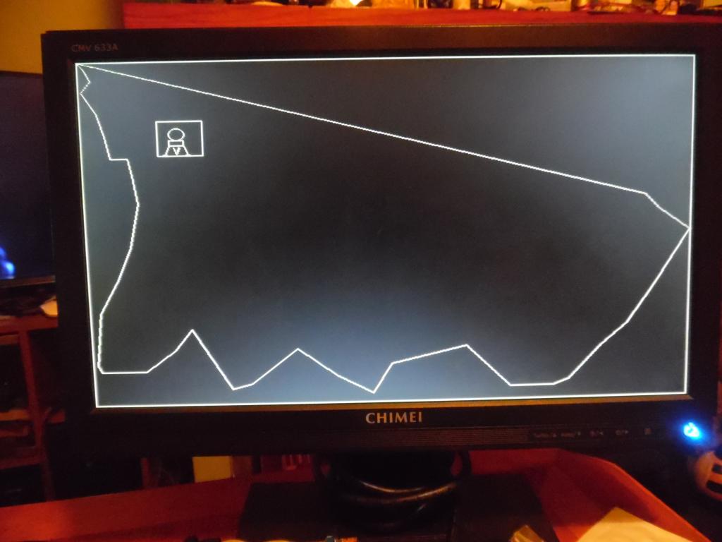

Is this a problem? I draw coordinates but it aways joins the last to the first like the polygon command but it shouldn't. should it?

Posts: 8968
Posted: 08:38pm 26 Feb 2024
Your circuit is right, Stan.
The 5V rail on USB-TTL converters goes straight through from the USB socket to the 5V pin. You can't "reverse power" it. However, you can reverse power a PC USB port that it's plugged into. That's why I say that you disconnect the converter USB and connect the Pico USB for firmware updates then swap them back after. You can only ever get one source of supply that way.
If you use a separate 5V supply then you need to do more messing about. The rule still applies, only one source of supply. The best way is to only connect RX, TX and GND from the converter and remember to disconnect the separate supply before updating the firmware.
Posts: 2807
Posted: 08:59pm 26 Feb 2024
"You can't "reverse power" it."
dunno if 5V into usb to ttl 5V out would be damage if it was not connected to a pc usb.
It's soldered so a 0.3V drop diode to be safe. just cut a track and solder.
Footnote added 2024-02-28 03:10 by stanleyella
Flashed ok without diode and usb to ttl still working :)
Posts: 2807
Posted: 09:59pm 26 Feb 2024
the line draw program earlir
for l%=1 to 5
 o%=l%+1
 line lx%(l%),ly%(l%),lx%(o%),ly%(o%)
next l%
makes no difference. it says it;s flashing and vga screen scrolls no errors it runs as before like it hasn't flashed it???
Posts: 3323
Posted: 10:10pm 26 Feb 2024
  Stan said  Is this a problem? I draw coordinates but it aways joins the last to the first like the polygon command but it shouldn't. should it?
You may have found a bug as removing the For and Next still draws a polygon.

Posts: 2807
Posted: 11:40pm 26 Feb 2024
Hi phil99,you said "You can however get what you want using LINE GRAPH instead of Polygon.
Line GRAPH lx%(),ly%()" just joins the dots
that worked fine, I never knew about that command, thanks for pointing it out sir.
it seems to not need an index,it just reads the arrays,:) nice one, stan
Posts: 3323
Posted: 12:08am 27 Feb 2024
Some more experimenting with the Line issue with arrays.
It only happens with integer arrays, and doesn't always draw a polygon.
A minimal command line version.
> dim x%(3)=(30,90,90,30), y%(3)=(30,30,90,90)
> Line x%(0),y%(0),x%(1),y%(1)
Draws 3 sides of a square but the 4th finishes at (0,0)
Edit.
Stan's earlier code works correctly if all the "%" symbols are removed.
Edited 2024-02-27 15:52 by phil99
Posts: 5995
Posted: 08:05am 27 Feb 2024
Hi phill99, stanleyella,
This is a real bug.
Since x%(0) is a value (not an array like x%()) the command
LINE x%(0),y%(0),x%(1),y%(1) should plot a single line. It is simply 2 sets of coordinates. To draw all value in the arrays, it should be
LINE GRAPH x%(),y%(),c
POLYGON x%(),y%(),c
Or (maybe if I interpret the user manual correct)
LINE x%(),y%(),a%(),b%()
I can also confirm that this bug exsits in V5.08.00 (the official release on Geoff's page). Appart from plotting the whole array with LINE, that is a but, the other bug is that it ends the sequnce at (0,0). That is a second bug.
