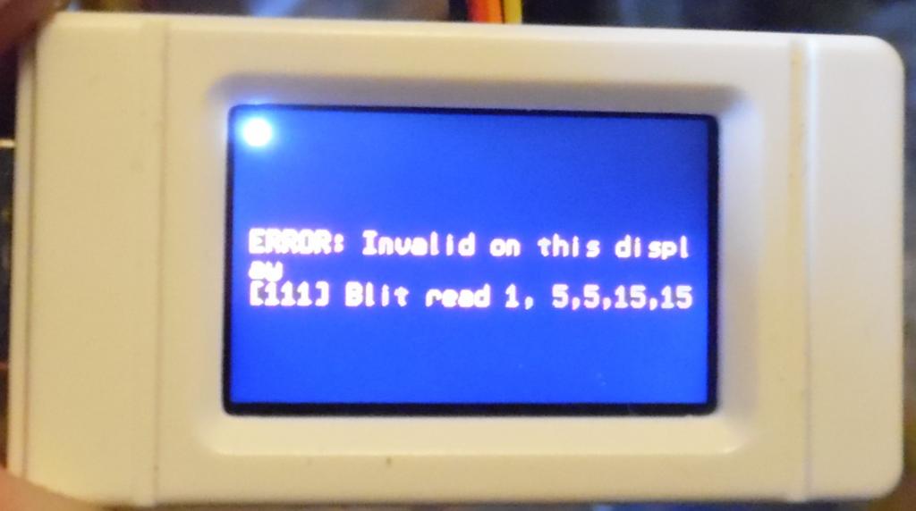

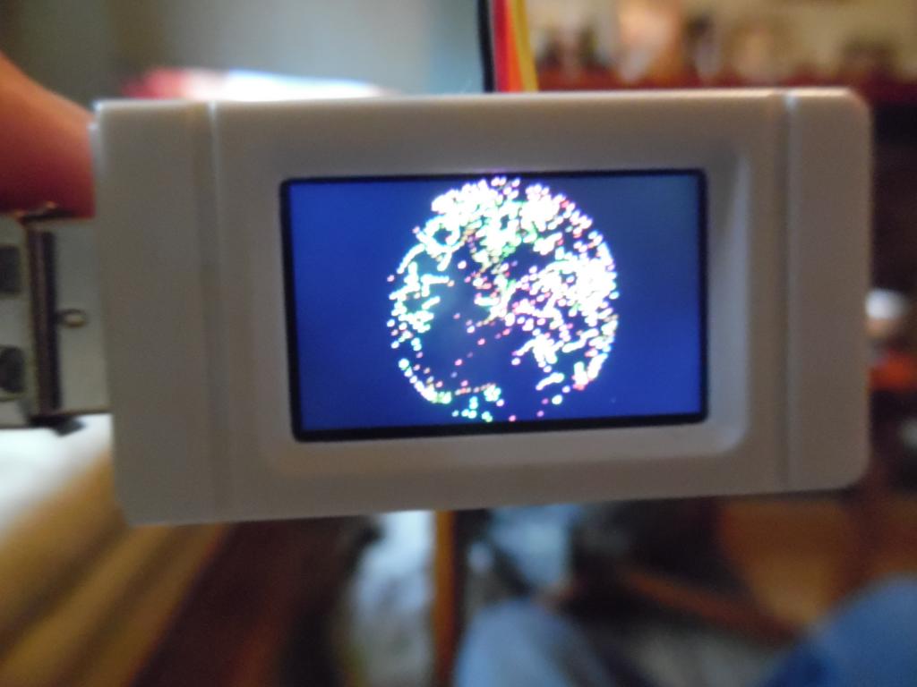

Waveshare geek and bubble universe worked but Conway's life didn't or any sprite or layer L code.

Posted: 03:34pm 17 Feb 2024
You're right, anything with a layer doesn't work, bubble universe writes straight to the LCD. Had I had any error messages, they are working fine.

Posts: 2807
Posted: 04:06pm 17 Feb 2024
Conway's life worked before.
RUN
[111] Sprite read 1, 5,5,15,15
Error : Not available on physical display

Posts: 11830
Change it to BLIT READ and try again
Posts: 2807
Posted: 04:10pm 17 Feb 2024
  Volhout said  Conway life works on Geek on 50800
hi, is that the version number? life did work before 50901
Posts: 2807
Posted: 04:40pm 17 Feb 2024
  matherp said  Change it to BLIT READ and try again
RUN
[111] Blit read 1, 5,5,15,15
Error : Invalid on this display
is it me?
changed all sprite to blit
cheers, stan
note the different error messages... Invalid--not available
Edited 2024-02-18 02:55 by stanleyella

Posts: 11830
Posted: 05:12pm 17 Feb 2024
The bug is in FRAMEBUFFER COPY if you add ",B" to do the copy in the background it should work
Stan
Your issue is that you are trying to read from a non-readable display. You must put the FRAMEBUFFER WRITE F before trying to read then the read happens to memory
Edited 2024-02-18 03:13 by matherp

Bleep
Joined: 09/01/2022
Posts: 853
Posted: 05:22pm 17 Feb 2024
Glad you found it, yes if I use the 'b' option in the frame buffer copy, it now works just fine, both versions of 'BLIT' and 'BLIT READ/WRITE'.
