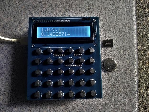

  Quote  In case the whole LCD can work from 3V3 you can remove the 5V
I did try running the (old) lcd on the 3.3v, but there was no visible output.
Some modules will display OK on the 3.3v apparently but others not. The backlight
led is ok on 3.3v, and the processing might run,  but the glass logic levels need
more juice.

@zeitfest:
Are you sure that it is not due to the negative contrast voltage? I had the same problem. It worked with this circuit here:
https://elm-chan.org/docs/lcd/lcd3v.html
I have realised the PWM with the Picomite and can now set the contrast via the duty cycle (or was it the frequency?   ).
In any case, the display didn't show anything at all before with 3V3, now it works...
Frank

  Quote  PWM with the Picomite..
That looks like the best solution   .
Though, as it turns out I can get ridiculously cheap boost modules and the 5v will be useful for future growth so that's the way for now.

Posted: 03:52am 23 Jul 2025
The "budget" version on two stacked pcbs, running calculator script
off the sdmicro.
The 4x4 size pcbs are a lot cheaper but the display is limited
It has space for a lipo. Also circuitry for the RTC but I have !@#$% lost the
ic for it    so have get some more before I can test that.
