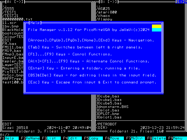

I slightly reworked the File Manager code using your string input function, and slightly corrected errors in various places.
Thank you all for your advice and attention.
Now I need to test it.
FM111.zip
I have PicoMiteVGA 6.00.00RC12
There is some strange glitch, when viewing images or opening text files for editing, the top two lines are not visible.
Is there such a glitch on the newer version RC15?
javavi
Joined: 01/10/2023
Location: Ukraine
Posts: 603
Posted: 10:34am 17 Nov 2024
FM v1.12    PicoMiteVGA 6.00.00RC12
FM_v112.zip
In addition to the [ESC] and [BS] keys, when editing the input field in forms, I added the [DEL] key, which completely erases the input field.
Try, check, test and write your comments here.

FM v1.12 - test @: PicoMiteHDMI MMBasic USB RP2350A Edition V6.00.00RC15
1)
>RUN, F9, LIST COMMANDS, ... 1-2 seconds later: PICO2 RESET
2)
Above the function key bar, behind the input prompt, the keys pressed only appear as “code” ... c=99, l=108, s=115, ... shouldn't the input appear here?
3)
>RUN, F9, ESC ... ESC ends the software, I would have expected the F9 menu function to end here!
4)
Input on a selected file, mp3 starts playback, jpg nothing happens? I would have expected the image to be displayed here.
@javavi: Otherwise a very successful file manager! Good luck with the finishing touches!
Matthias
javavi
Joined: 01/10/2023
Location: Ukraine
Posts: 603
Posted: 06:06pm 17 Nov 2024
  homa said  FM v1.12 - test @: PicoMiteHDMI MMBasic USB RP2350A Edition V6.00.00RC15
Hi Matthias,
Unfortunately, I only have Pico2 itself to test the PicoMite 6.00.00RС15 versions.
1) Yes, I checked, there is such a bug! If you run the command EXECUTE "list commands" which stops for scrolling, the system goes to reboot.
2) I haven't reached the input line yet, the problem may be that same command EXECUTE.
3) Everything is fine here, treat this list of commands as the same list of files, to exit press ENTER at the top when exiting the directory. (by the way, this list can be supplemented with frequently used * programs)
4) I didn't know that PicoMite can load JPG files! This part of FM can be improved by adding launching of all types of files.
Thank you for your attention, we will improve it!
