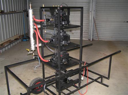

Hi all,
It has been a bit quiet on this thread of late, so I thought that I should give a progress report on my Briggs and Stratton steam engine. I tried to upload a photo of it, but the jpg photo file is 877kb, and the limit for image uploads is 500kb.
The frame is completed, and the three single cylinder engines have been mounted one above the other and coupled together with a 120 degree rotational angle between each crankshaft. Coupled below them is a 1 HP induction motor, which will act as the grid connect generator.
In my experiments with a single cylinder B & S engine, I have been able to get it up to about 800 rpm, which is about half of the speed that I need. I have set up a pressure transducer to monitor the cylinder head pressure while it is running, and found that, even with 100 psi at the inlet side of the inlet solenoid, the cylinder head pressure only peaks at a little over 10 psi.
The solenoid that I am using has a 3mm orifice, and I think that that is the problem, rather than the opening time, which is acceptable. The 3mm orifice is the largest in that brand of solenoid that will operate at 100psi.
I am now awaiting arrival of 3 Lake axial solenoids from the US, which I think will be somewhat faster than the solenoid that I am presently experimenting with. These have 3/16 inch or nearly 5mm orifices, which is nearly two and a half times the area of the 3mm one, so that I am hoping for a significant performance improvement.
Unfortunately, 3/16 inch seems to be about the biggest orifice available in direct acting solenoids, as, after that, you go to a pilot operated solenoid which is inherently slower. Even so, I still have the option of using two direct acting solenoids per cylinder, so that I expect to get satisfactory performance somehow.
To monitor the crankshaft rotation angle, I have obtained a 360 pulse per revolution incremental encoder, only to realize that this puts me into the realm of 9 bit binary numbers. My experiments with various size picaxe chips have proven that they are too slow to do anything useful at this pulse rate (about 10 kHz), so I am working on some other alternatives.
Despite the problems, it is coming together, and I hope to be in a position to run the three cylinder engine on compressed air some time next month.

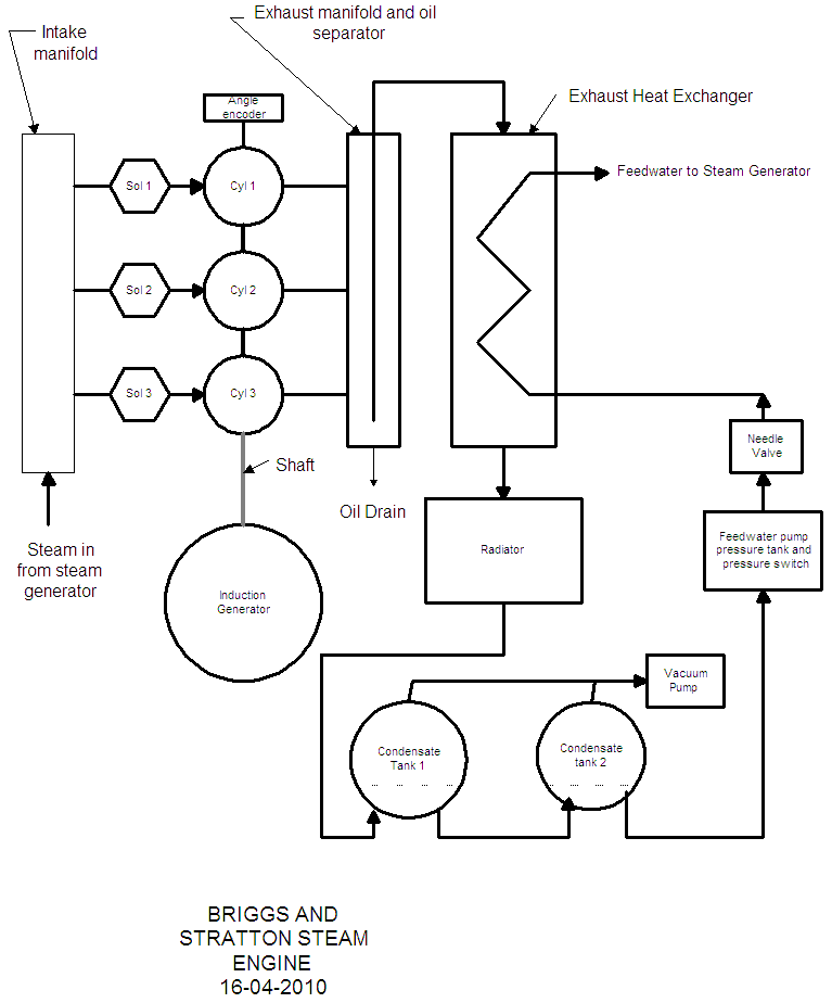

Posted: 11:58am 16 Apr 2010
Hi to those following progress (or lack of) on the Briggs and Stratton steam engine on this thread, and particularly to those making helpful comments.
The engine project progresses slowly, but at least I now have most of the bits that I need to finish the engine. For those who are interested, I will try and attach a single line diagram of it. (Coises - foiled again - I drew it up on Visio, and the server doesn't like .vsd attachments) - I have now saved it as a gif file, and will try again!
Thanks for the advice re reducing the content of a photo so that it can be posted Pete. Somewhere in the process of cleaning some very unhelpful anti-virus software out of my computer, my photo editing software has dissappeared, and I have not yet msde the time to sort it out.
Apart from getting the timing right for operating the inlet solenoids, the control system needs to know the temperature and pressure at a number of points in the system. For temperature in particular, I am looking to monitor 7 points, including 2 at the solar collector. On the steam side, I need to be able to measure temperatures of up to 200C or more.
The problem with thermocouples is that you need proper compensating leads, ideally a cold junction, and you have to be careful with every connection to ensure that you are not introducing another bimetallic connection. I was therefore having a close look at resistance temperature devices (RTD's), which are just a temperature dependant resistance, and was attracted to the Pt100 type, made from platinum. These have a resistance of 100 ohms at 0 degrees C, and an almost linear temperature/resistance curve.
The problem is that they are about $50 and up each, and that is sterting to get expensive. Luckily, I ran across the site for Shanghai Feilong Meters and Electronics, which manufactures them, and sells them for a fraction of Australian list prices. The only worry for me was that you had to order via Alibaba Express, and it set me to wondering just what the 40 thieves were busy doing these days.
I therefore had a good look on the net, and found that Alibaba (the company, that is) even had an entry on Wikipedia, but for all the right reasons. Anyway, the RTD's arrived today, and the whole purchasing process was most professional.
Anyhow, hopefully by the end of the month or not long after, the three cylinder engine will be running on compressed air, and I can get on with building the solar collectors and tracking mechanism.
Thanks too for the comments re pic micros and picaxes, but I am going to rely on a bucket load of stone age electronics initially till I get the engine running. Maybe after that I can work out how to do an upgrade for the inlet solenoid controls with a suitably fast micro.
Don B

Hi Don
Glad to hear your progress and the diagram makes it a bit clearer.
All the best
Bob

Posted: 06:51am 31 May 2010
Steam Engine Photos
Hopefully this time I have been able to downsize the steam engine photos below 500k so that I can post them on the forum.
If the photo has posted as I believe it has (confusing system this, as all I can see in the draft box is text saying that an image upload has occurred), you should be seeing the three lawnmower engines mounted one above the other, with the 1 HP induction motor on the bottom. Just above the top engine is the angle encoder. You can also see the intake manifold, the intake solenoids, the crank case interconnection and breather tubing, and the 3 sump oil level and water drain tubes.
What you don't see as yet are the exhaust manifold/heat exchanger, radiator, condensate tanks, vacuum pump, feedwater pump, and the control electronics and wiring.
The control electronics are the really slow part at the moment. Because a picaxe is too slow to count and decode the 10 kHz pulses from the encoder, and I am still at the bottom of the pic or atmel learning curve, I have reverted to stone age electronics to count and decode the 18 or so angles that I need to control the solenoid opening and closing points for start up and governing.
I will have a shot at uploading a photo of the 4 boards that are completed so far and awaiting interconnection. These are the counter, decoder, angle selector, and solenoid control boards. Each solenoid has its own 8M picaxe for pulse width modulation control.
I need one more board with the power supply and picaxe 40X1 micro to be able to run the engine on compressed air, and, in future, a further 3 or so largely analogue boards to monitor and control steam pressures and temperatures and feedwater to the steam generator. Then there will be another board to control the solar collector tracking, but this will be mounted on the collector.
Despite the slow progress, I am still hoping to run the engine on compressed air later this month. Once this is completed, I can focus on the steam side of things.

If you have the torque available, I would seriously consider using a 6 pole induction motor for the alternator, and get your revs down a bit further.
We use a 6 pole then 4 pole combination over here on the smaller mains connect windmill. The first 11kw is done with the 6 pole unit at slower rotor speeds, and if the wind picks up sufficiently, the 4 pole takes over for the higher power regime.
Looks mighty interesting.
............oztules
Don B
Joined: 27/09/2008
Posts: 190
Posted: 08:16am 05 Jun 2010
Hi Oztules,
If you get 11kW plus from your smaller wind generator, then you are really in the big league for domestic wind generators.
Unfortunately, if the steam pressure stays constant, the torque stays constant, and the power varies in proportion to the engine speed. If the inlet valve has to stay open longer to get a higher average torque to compensate for a speed reduction, then there is less expansion of the steam, and the efficiency drops. This requires a bigger collector area to compensate.
On the other hand, I expect to be struggling to achieve the desired cylinder head pressure at 1,600 rpm due to solenoid orifice size limitations, and the inertia problems of starting and stopping the body of steam for 6 ms every 37 ms.
As with most aspects of life, everything is a compromise. I will just have to see how I go with the present set up, and then think about Plan B, etc. The other consideration is that the engines, 4 pole motor, and most other mechanical parts have all come from the local recycle shop so far, and they haven't had any 6 pole motors to date. But I keep looking.
Don B
