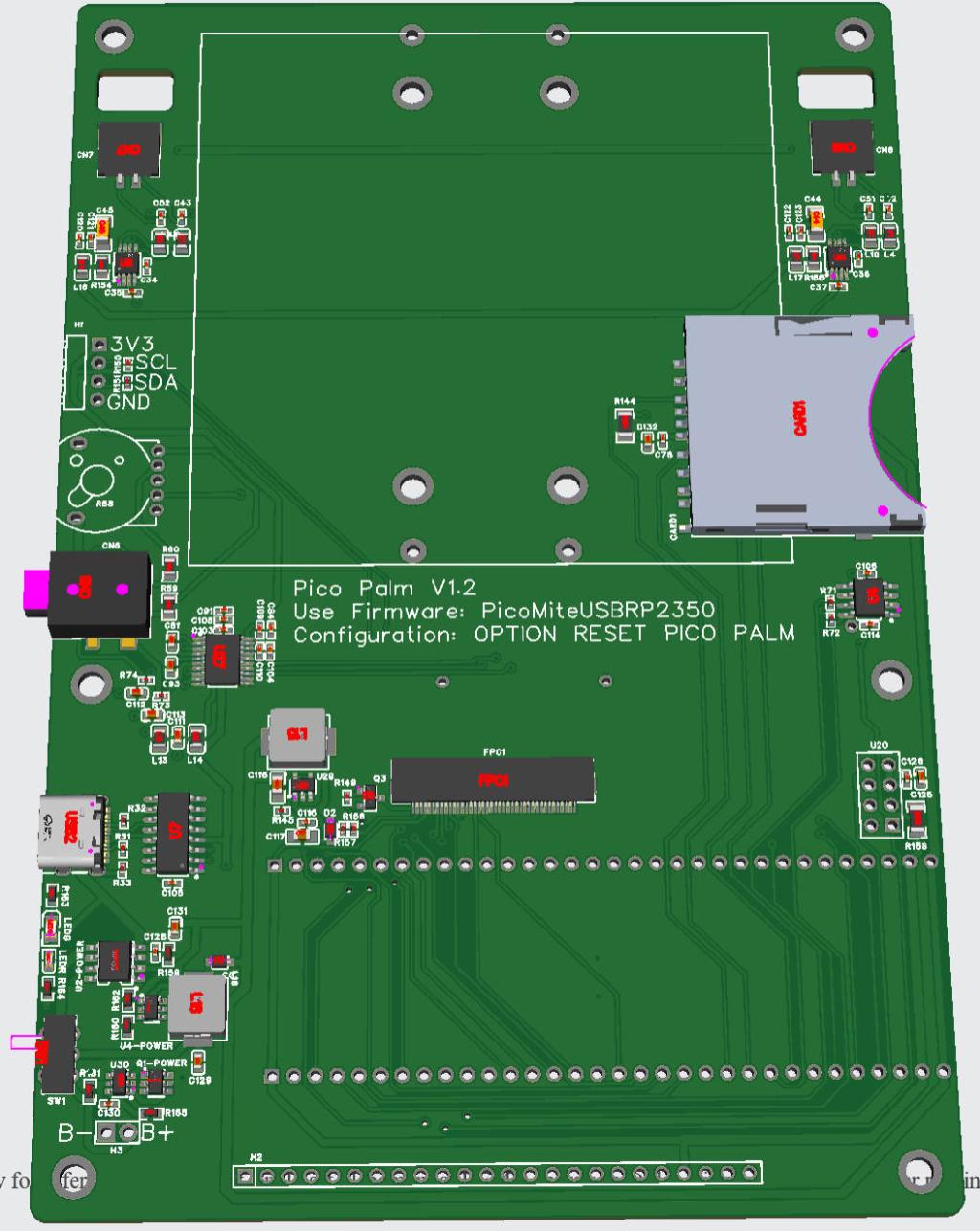

Here is the new layout and revised schematic
87069bec-9ffb-4649-896d-5216e80dc431.pdf
Edited 2025-07-11 03:53 by matherp
Posts: 2994
Posted: 06:22pm 10 Jul 2025
Looking good there Peter!
Observations (take them, or leave them!).
1: I assume that is still and ESP8266 (from the shape of the connector (schematic quotes ESP32)
2:  to make it easier for the user to adjust the volume when the stereo output (CN6) is in use, ideally the volume control and stereo-out connector should switch positions
3: would it be better the power switch is moved nearer to the ‘top’ of the PCB  I.e. out of the way, rather than right at the bottom where it is more likely to be accidentally pressed
Looking really nice with a great choice of connected parts……
Posts: 12060
Posted: 06:46pm 10 Jul 2025
1: just the legend wrong - thanks - also will be on the bottom of the board
2: Agree but from a layout perspective it wo4rks better keeping the audio signals clean so I'll leave it where it is.
3: Likewise, logically agree but from a layout perspective it works much better as is switching the 5V line from the boost circuit.

The big changes from the original will be:
Keyboard scanned by the RP2350 (6x12 scan matrix)
I2S audio using PIO to generate the I2S output
DS3231 RTC on board.
True memory mapped 8Mb PSRAM
In addition, I've developed a RGB332 framebuffer based driver for the ST7796S display with the screen updates done on the second processor. This gives a huge performance improvement over the current driver.
All my code will be available on https://github.com/UKTailwind/PicoMiteAllVersions so feel free to copy the various drivers. I won't update the github until I've tested on the new PCB.

I am wondering about the schematic above -- the schematic says that it uses a DIL RP2350B, but I was not aware of any sort of RP2* MCU coming in dual in-line packaging, nor am I aware of any readily available RP2350B board that breaks out 64-pin DIL to the user (e.g. while the Pimoroni Pico Plus 2 and Pico Plus 2 W use the RP2350B, they don't directly expose most of the HI GPIO's of the RP2350B to the user).

The DIL RP2350B isn't a standard part. It's one of matherp's designs and you can get them made at JLCPCB. Info here.
